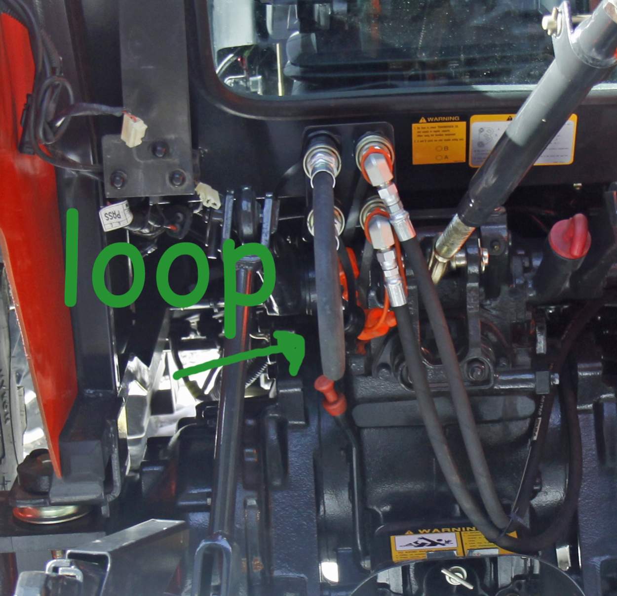

Seems like a great price from what Ive seen. I have a DK45 cab HST myself, and LOVE it. More so every time i use it.
I had my rear tires filled with rimguard and i can lift whatever i can fill my bucket with without an issue. I even have a loader mounted snowblower that i lift without issue. I move a 30' gooseneck horse trailer with something like 1800-1900 pounds of weight, and don't need a ballast box. Love that rimguard.
The extra rear remote is great if you ever want to run a snowblower. the included remote has a detente ball which sucks for things like snowblowers, as they stick. but you need the detente if you ever want to run items like a rear mount log splitter.
I had my guy run a front set of hoses to the 2nd rear remote so i can operate the snow blade with the 2nd remote instead of the 3rd valve.
This hose only cost $450.00, and i added a mid set of quick connects for ease of loader removal. My guy wanted $1000 for the 3rd valve to rin front items. It cost $400 for 2nd rear remote. I rather would pay him to do it then for me to do it, seamed like alot of work.
oh...also, have your dealer run a loop of hose on the rear couplers (remotes) to prevent deadheading the hydraulic pump if the detent valve is accidentally engaged....save yourself alot of $$$$$$ for a little $$ now.
I apologize but what exactly is deadheadng? I see you have two remotes on the back. I don't have any use for a snow blower so I really wasn't going to run the extra remote to the back but am considering the one on front for a grapple. My price was $600 on the rear remote and I just don't think I'll use it enough to justify it. I certainly do not want to damage anything though.
Thanks
   / New DK45SEHST owner #6
If you have no use for the 4 ports on the back (dual remotes) don't spend the money...they can always be added in the future.
The front aux valve for the 4 in 1 is reasonable priced. I would get that.
The machine is equipped with 1 auxiliary remote at the rear of the tractor. The lever to control the flow of that remote is located to the right of your right shin. If that lever gets locked into either or position with out having some thing hooked to your rear remotes, the hydraulic flow will be activated and have no where to go. That will cause a major amount of heat and cause your hydraulic pump to fail, I did have one machine here that had so much heat created that is melted wires and most of the orings on the hydraulic system.
The hydraulic ports on the rear of the machine acts as a valve. Flow can go either way depending on which way the lever is positioned.
This will only happen if your valve is locked on for a period of time, probably
a minute or more. This is not "deadheading" the pump, since all pump flow
goes thru a relief valve.
This is an important distinction for the new user because sending the
implement pump into relief is very noticable, and it occurs all the time
when using the loader without any problems. Of course, it is only in
relief briefly as when the cylinders reach the end of their travel. There
should be no fear of deadheading a pump on a properly plumbed tractor.
I only mention this now because there is a current backhoe thread where
someone connected up his hoe backwards with a PTO pump, and broke
the casting of his valve. THAT was deadheading the pump, as the flow
was not protected by an relief valve. Bad.
