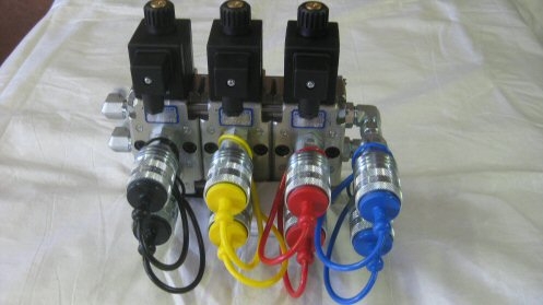

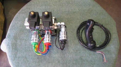

When you get around to adding the additional rear remote outlets, a double or triple set of diverters will work well for you similar to those pictured.

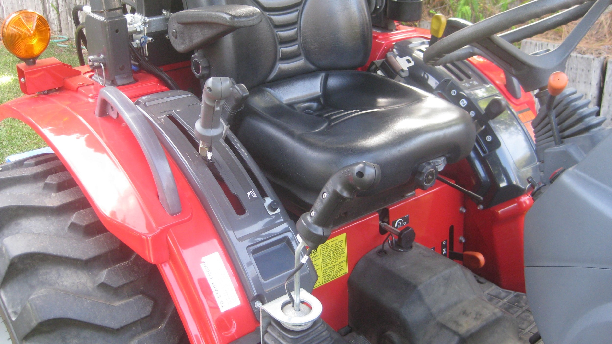

@D&D and Mitch. To answer both of your questions. I was able to access one set of remotes by simply removing the seat plate. The cavity is not large so two sets would be harder but doable without removing the fender. You may need a helper.
Yes, it was my first hydraulic work. You will notice the end cover in my photo is black because it was bolted on to the tractor casting/block when painted at the factory. You simply sandwich a valve or two between it and the block. The non-detent valve is typically added first and presumably the kit comes with longer bolts -cover-valve-block. The detent kit likely has even longer bolts -cover-valve-valve-block.
