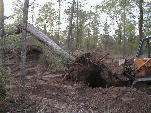

Get under the root ball to loosen things up.

Sandy loam makes it nice digging out trees. I you ever have one like the last one that still will not come out after you dig around it. Take all of the dug dirt and make a ramp . Then drive you and push the tree higher on the trunk. Just dont drive off the ramp into the hole. When you cut the roots you can make the ramp at the same time.
