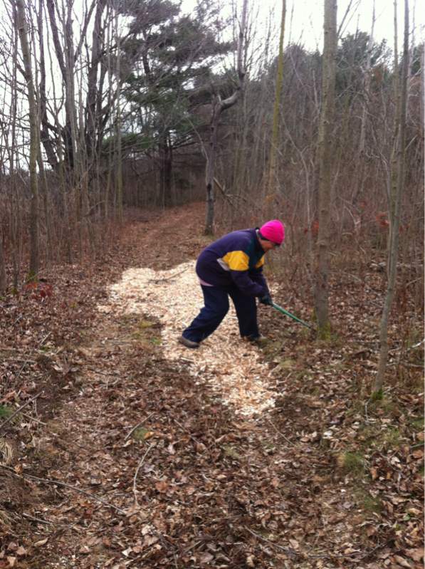

We spent some time on the road through the woods today. We've decided in the short term to widen the route and to use chips from the brush to even out the path. We'll leave the stumps and roots for now, but I can see the need for a tractor backhoe in the future. There is a pond in the field north of the path through the woods that I'd like to enlarge so we could use the earth from that project to add to the path.
I'll try to add a couple of pictures I took today.

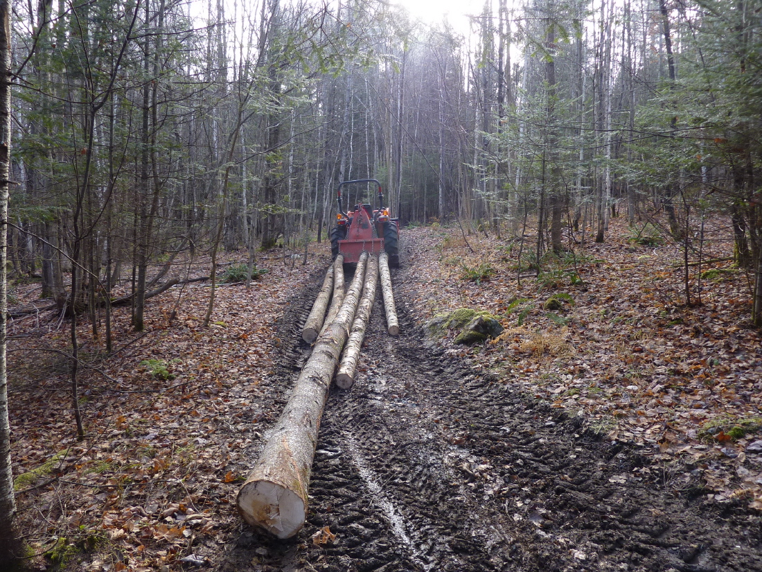

I have some good roads and also a lot of poorer roads like yours that I use for skid roads. From my experience I have found that if I just work with the existing organic soil and make a smooth road it will not stay smooth. I will always get rutting and soft spots and mud holes. But if the stumps and rocks are gone it is easy to resmooth it just by draging something on it. If I leave the stumps in and cut them at ground level they will eventually yet janked out but it takes a while. But it is hard to smooth the road with them there. I also will fill holes and low spots with sawdust and debris from firewood landings but it is not a perminent smoothing fix. It is just more organic material that with time rots down and turns to mud because it is in a hollow that holds water.
I guess what I am trying to say is that what you are doing to smooth your road is fine. I can understand, especially when face with 3/4 mile. But just be aware that you will probabaly have to do it again next year or next time it rains hard. It will help if every time you use the road you drag something wide down it.
If you want a perminent good road follow the good advise that was given in the earlier posts.

Some great ideas lately. My "road" is really only intended to be a three season trail for tractor (and ATV when I get one), so it doesn't need to be super smooth (site isn't smooth yet even after adding wood chips).

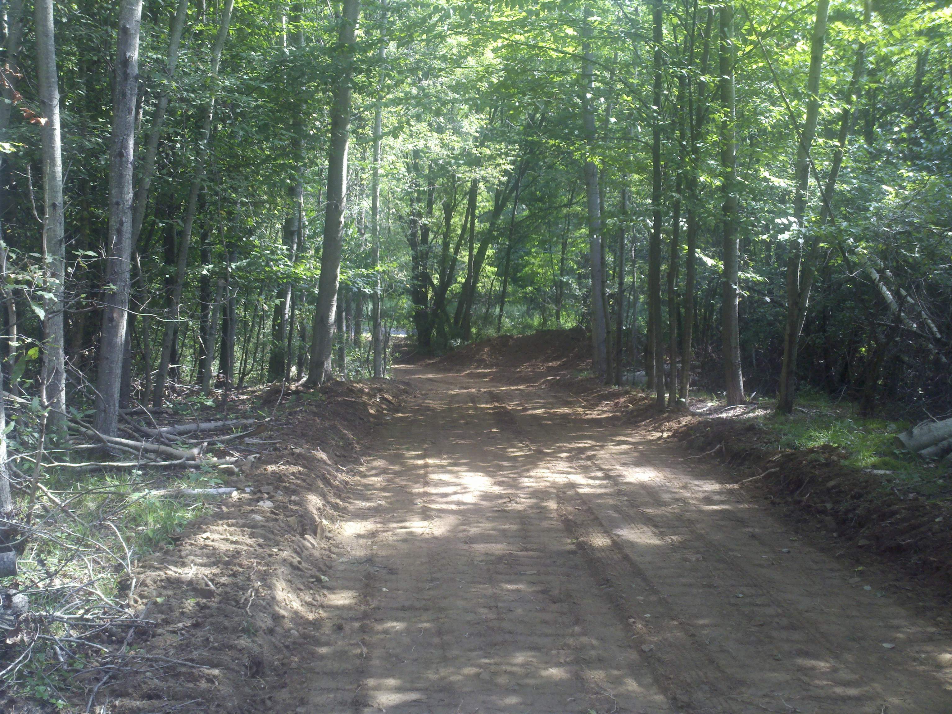

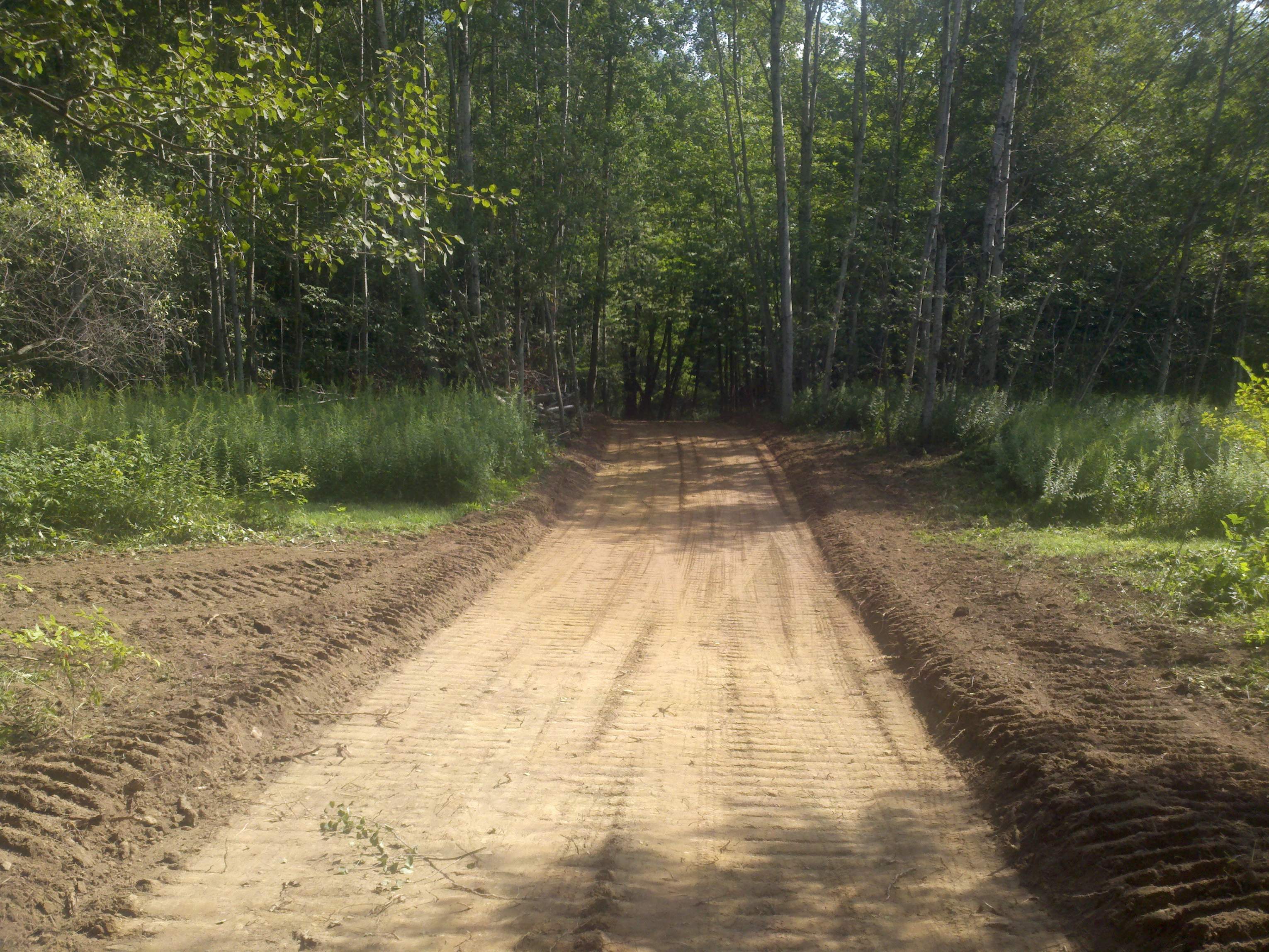

My new driveway was a little less than 500' long, but I am glad I hired out the dozer work at least. I realize you have lots more to deal with. I got a couple of bids to do a complete, turnkey job including tree removal. Those were $6000 give or take.
I wound up plotting out the route, cutting the trees myself, leaving about 1-2 ft of stump for the dozer guy. Got the dozer work done for $475.00, installed fabric, got about 300 tons of bank run gravel delivered, spread it with my cut back blade, I think I have about $3000 into it. Turned out nice.

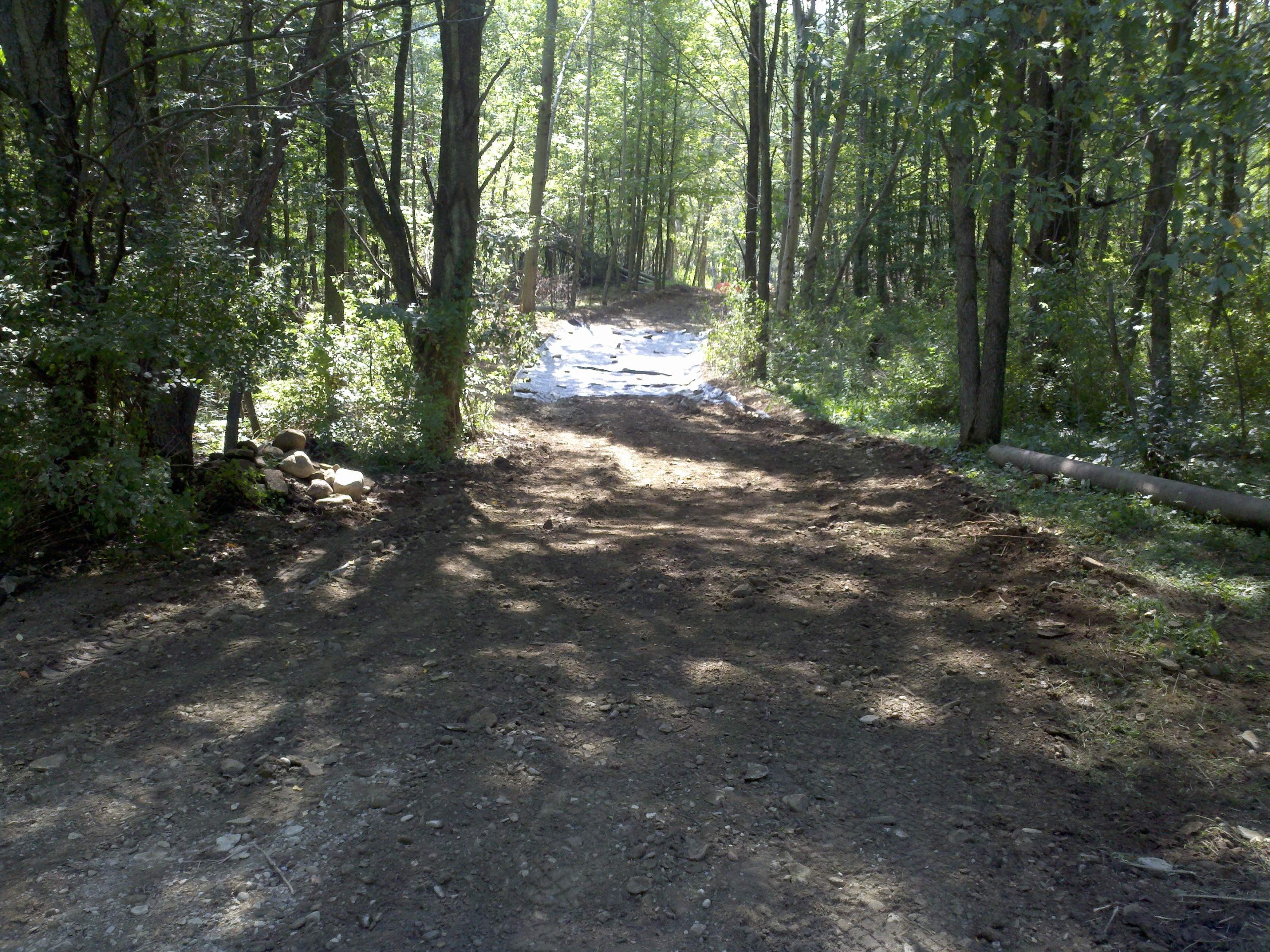

Good information - the dozer seems reasonable. What was the fabric for?
   / New driveway #38
Fabric- Geotextile fabric- keeps driveway material from "sinking" especially if you have soft spots. Saves you from getting potholes later on and having to add more material. Some people have used discarded carpet to do the same, I don't know how well it works, though. Comes in a 12.5' wide roll, cost was around 1.00 per linear foot.

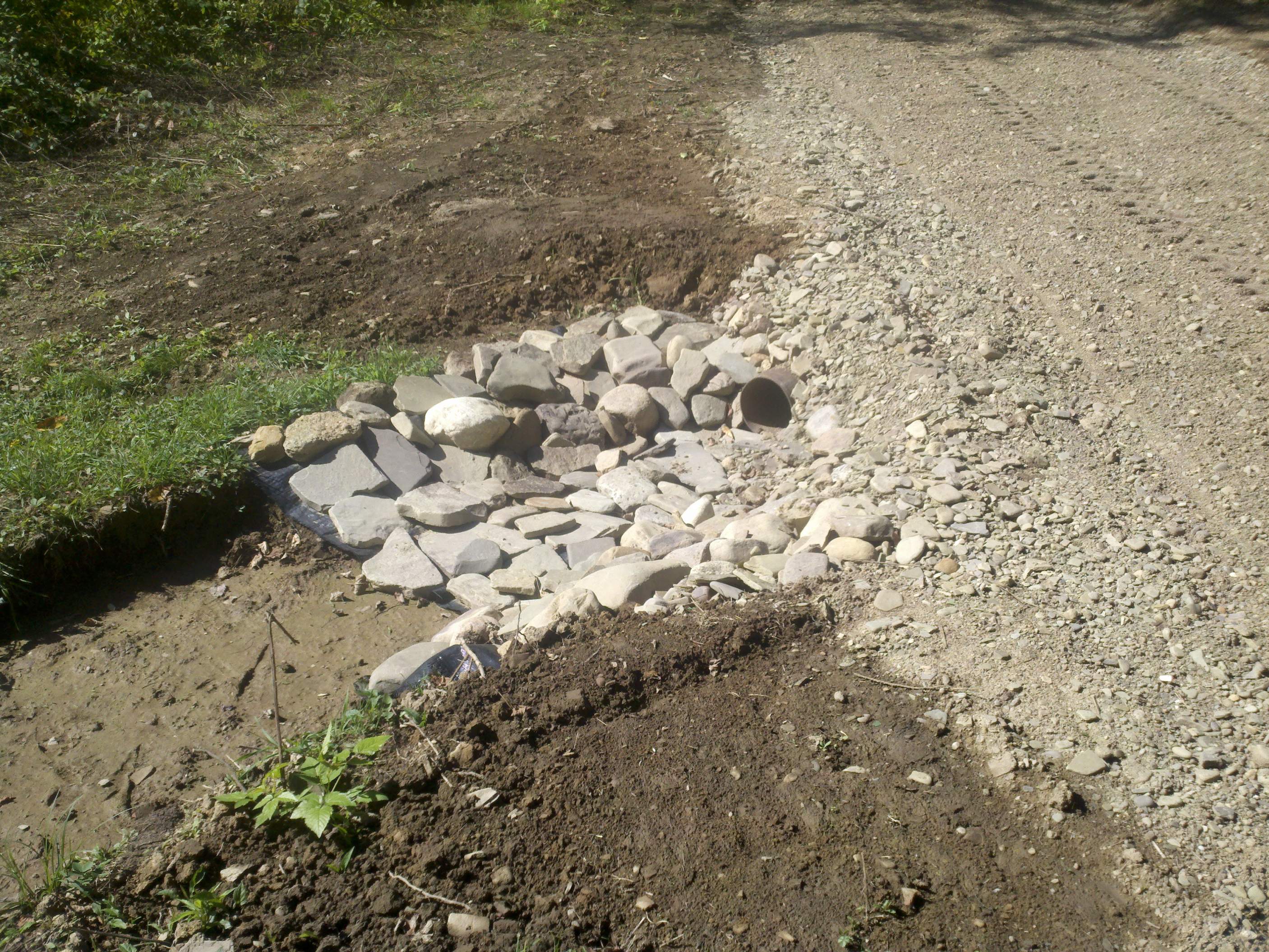

Some pics..... #1 and 2 just after dozer work, #3 you can see fabric in the background, #4 drainage for a low spot.

Nice looking driveway - thanks for posting the pics
