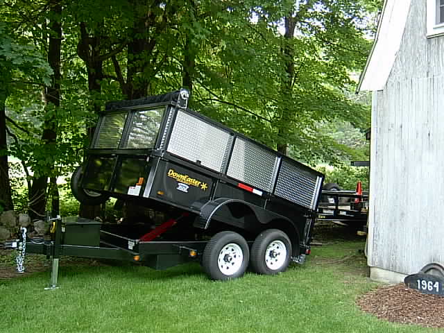

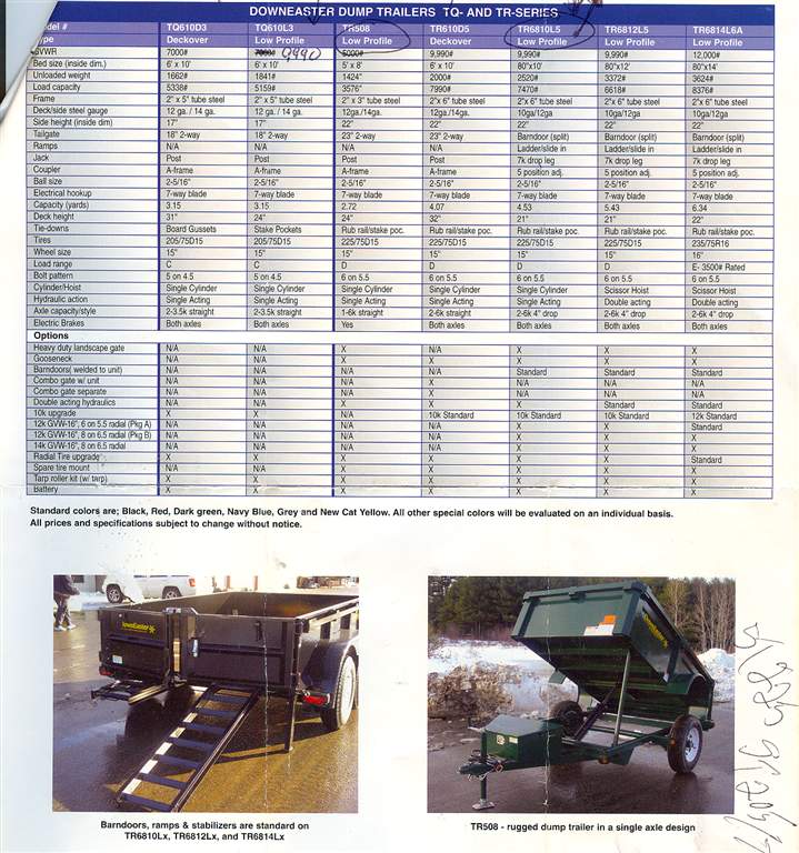

I'm attaching some spec's of the Downeaster that I purchased (TR6810L5) and I got the double acting cylinder. Also attached is a picture of the trailer after coming home from my fabricator who installed the additional 2 feet Alum diamond plate extensions. Notice the load capacity weight in the chart for this 10K unit. it is only 7470 pounds. I do remodeling and use it as a dumpster and boy do I put some weight in it and have no trouble dumping it. I have one slip right here in front of me showing a weight that I dropped off of 8203 pounds. No problems.
This is meant mainly for the specification so one can see approx what they are intended to carry/dump.:) Sorry, I'll have to have the specs to follow for some unknown reason it will not upload.
The Gotcha Man
