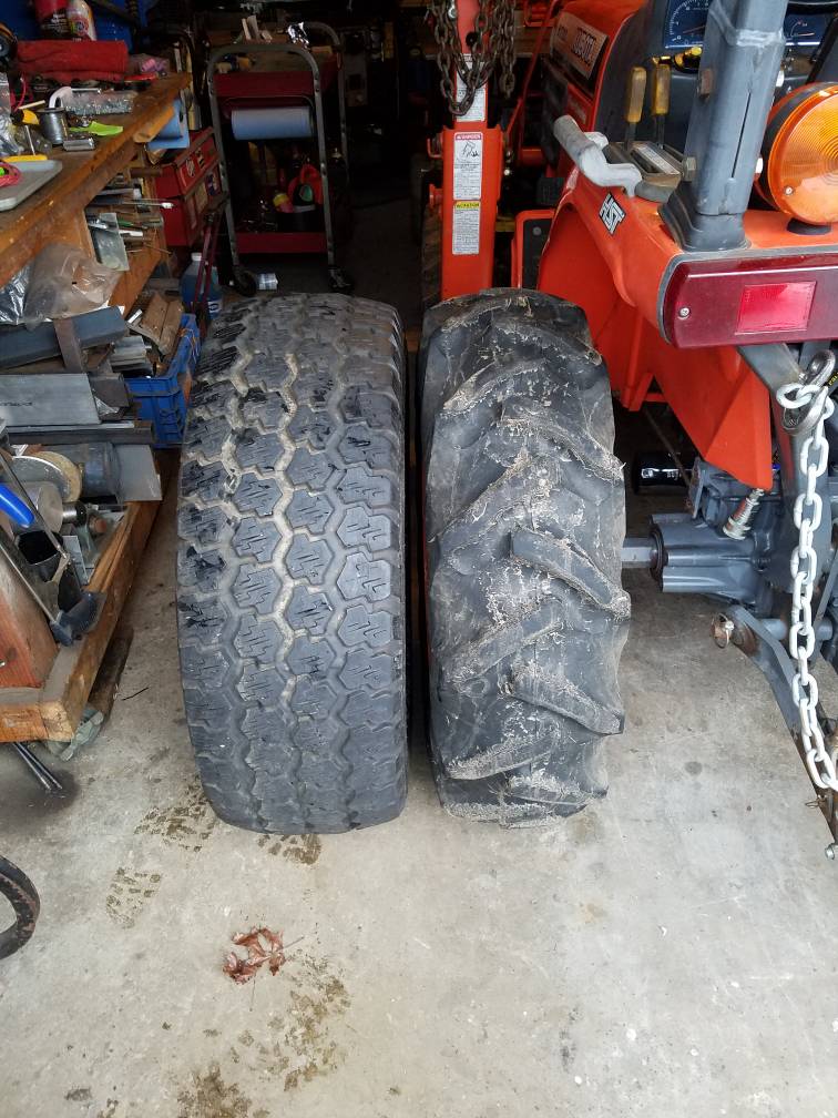

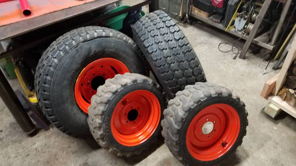

Found a set of R4's on rims with the same bolt pattern locally.
Sourced some 15x10 6 on 6 steel wheels from Hey Wheel. $191 Shipped.
Opted for some truck tires in 33x12.5R15 found on Craig's list.

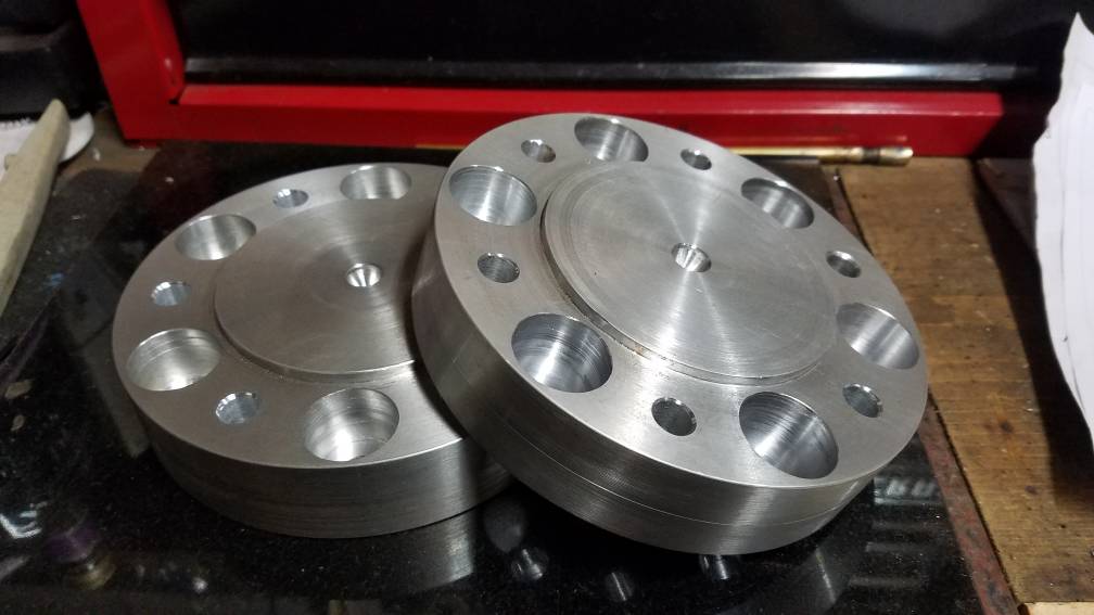

Made some custom wheel spacers to get the fronts to the proper backpacking.
