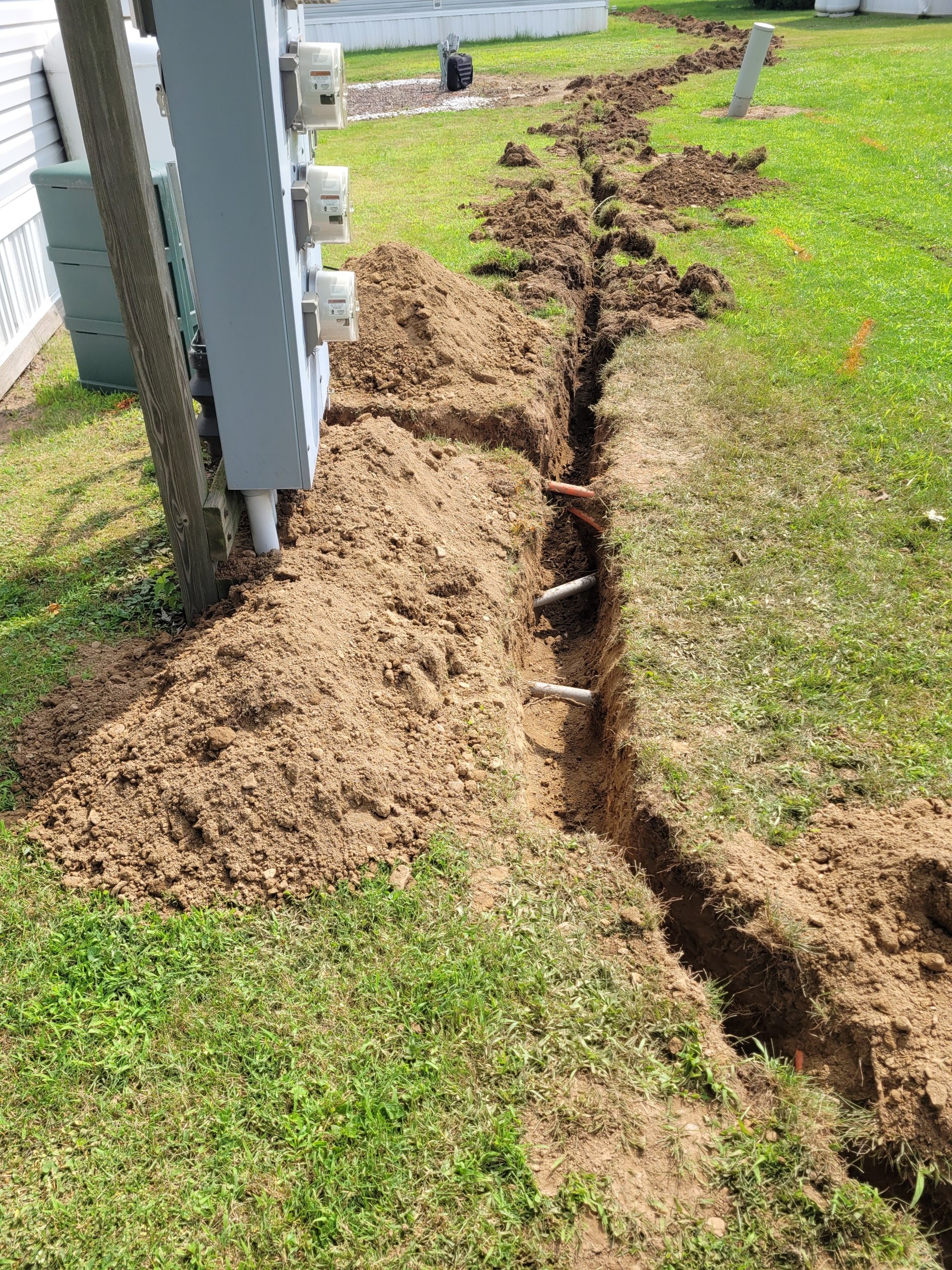

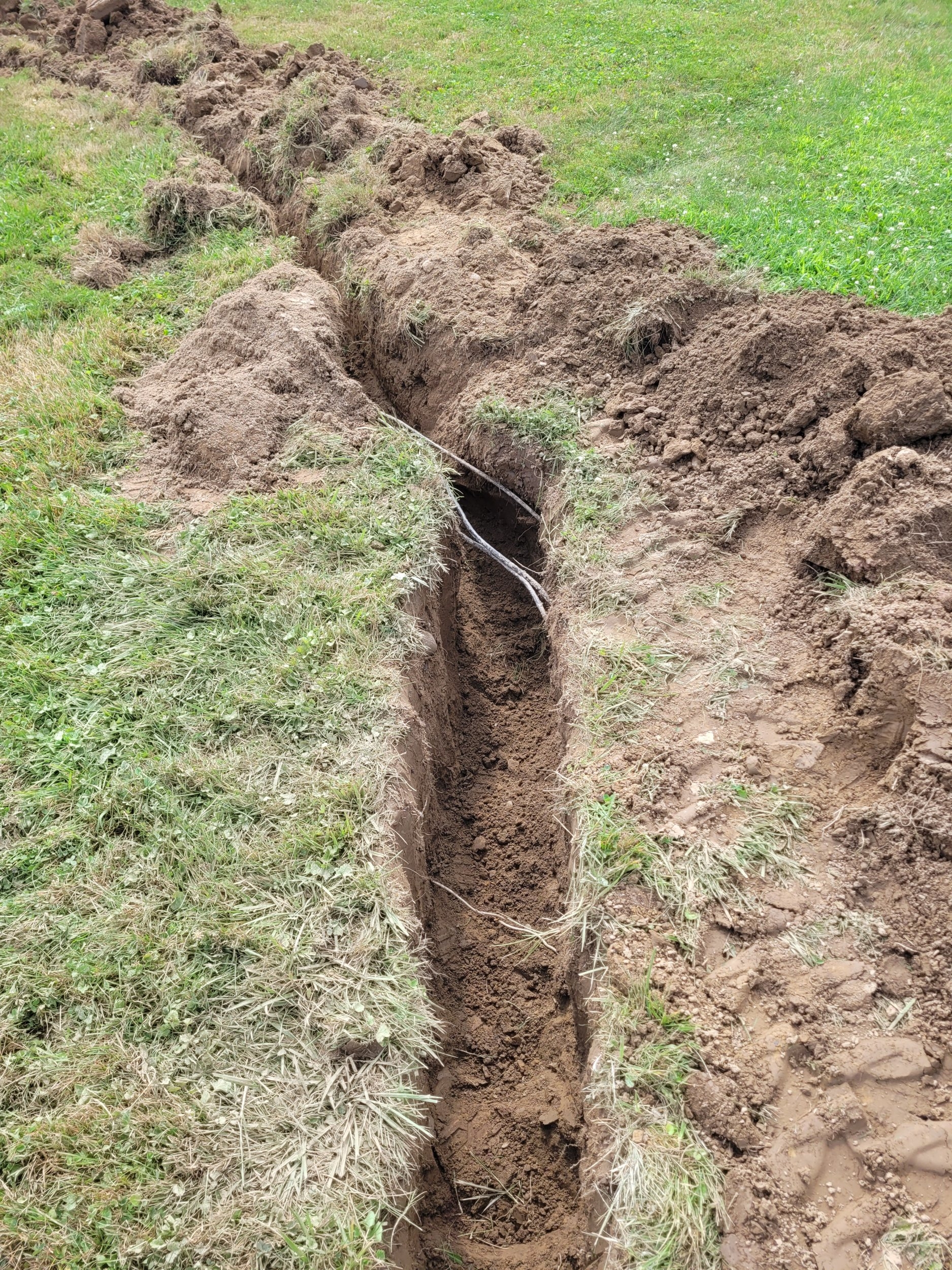

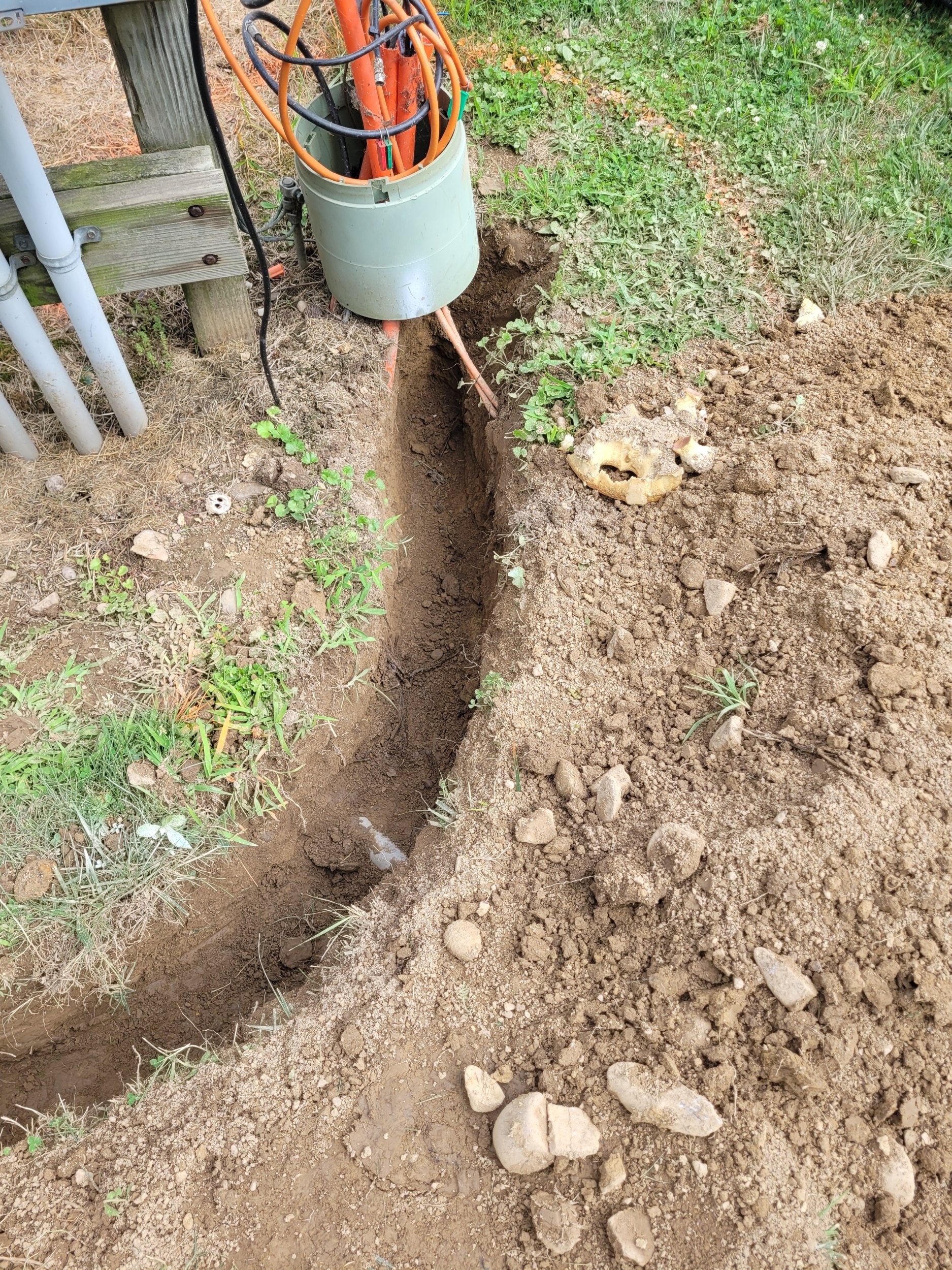

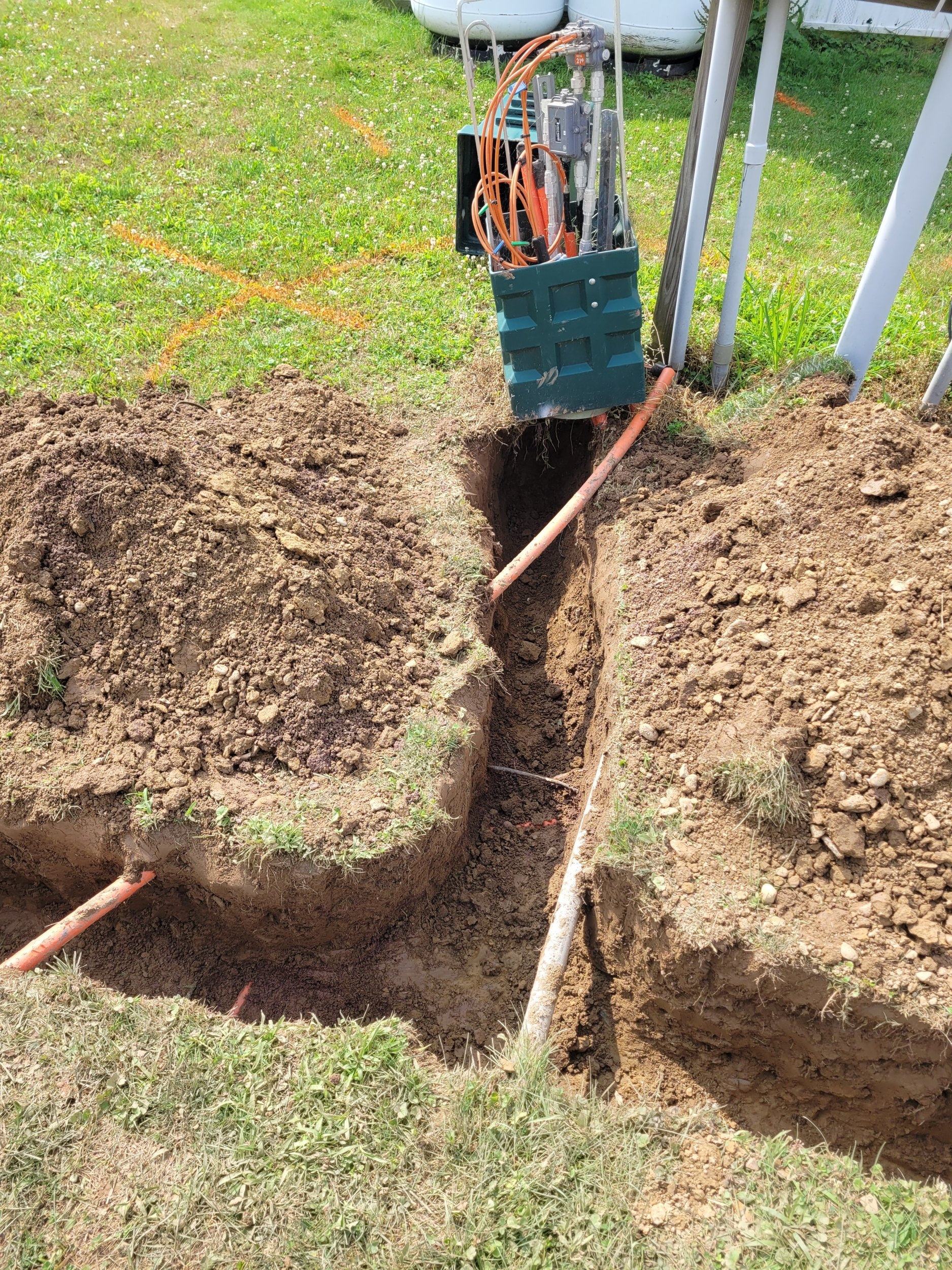

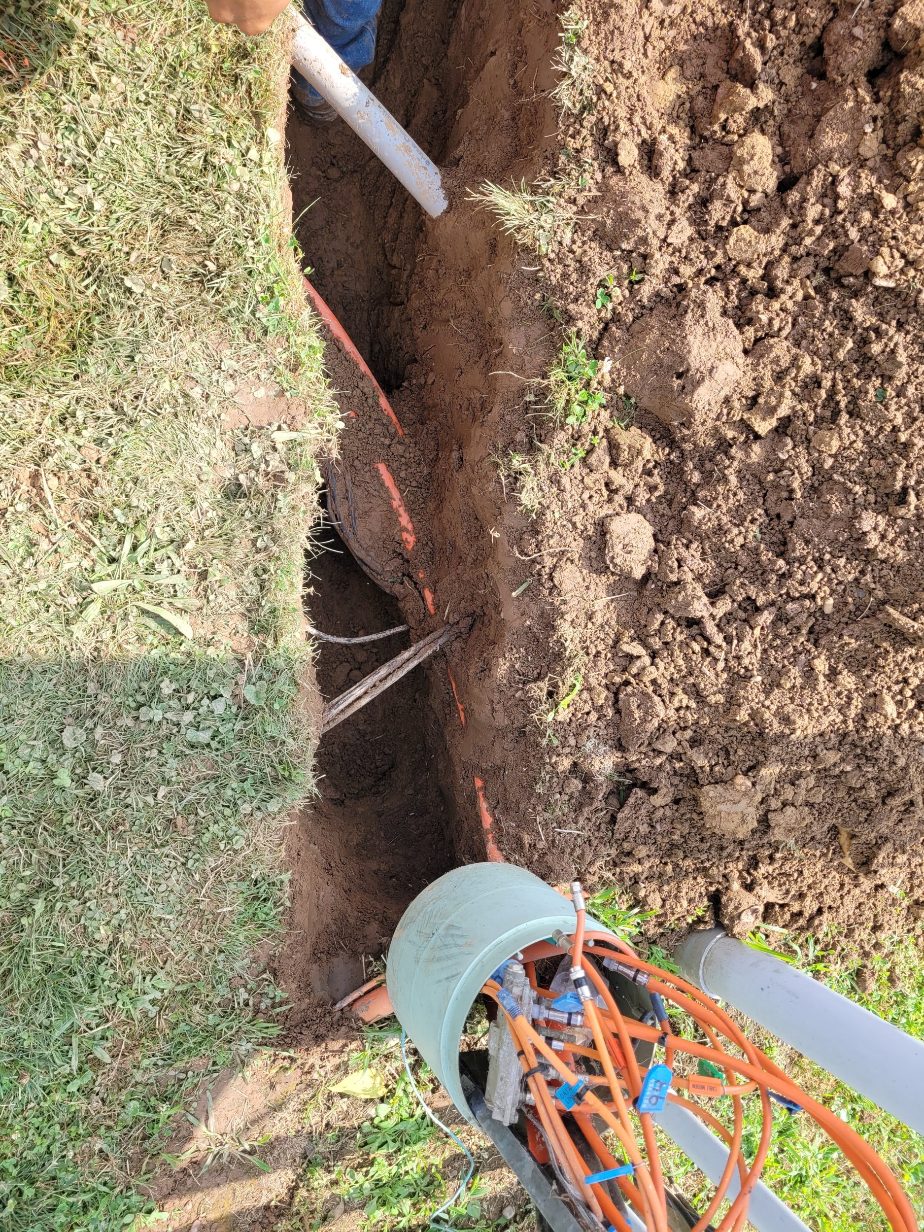

I know everyone's paw has done it to perfection but as someone who locates daily I've see them fail often. Here as this mornings "stuff" and my crew does this all day most days. There is a reason why every time the sticks are put to a real test they have failed. View attachment 878733View attachment 878734View attachment 878735View attachment 878736View attachment 878737
Works great for finding unmarked leach field lines too!
And phone lines! I found two just last week, in the same hole six inches one above the other. šŸ˜†. Thankfully they were abandoned.
