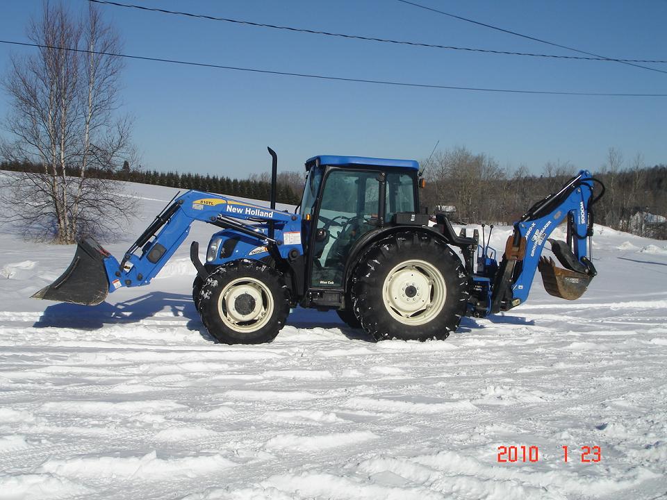

Big round bales are in the 2,000lb plus range aren't they? If so, this should steer you into size of tractor choices. I have a New Holland TN75. I think the FEL is rated about 2200lbs? Pretty close to that. Anyways, I have been stacking my firewood on 4 ft square pallets. Basically, about a ton of firewood on each pallet. I have forks, and it can easily lift the pallet, but if you put it up in the air, it's a little touchy. It handles it ok, but i wouldn't want anything smaller. My rears are loaded with rimgaurd and i had my 7ft bush hog on back for weight. Just my experiences, good luck
This is my ride.
