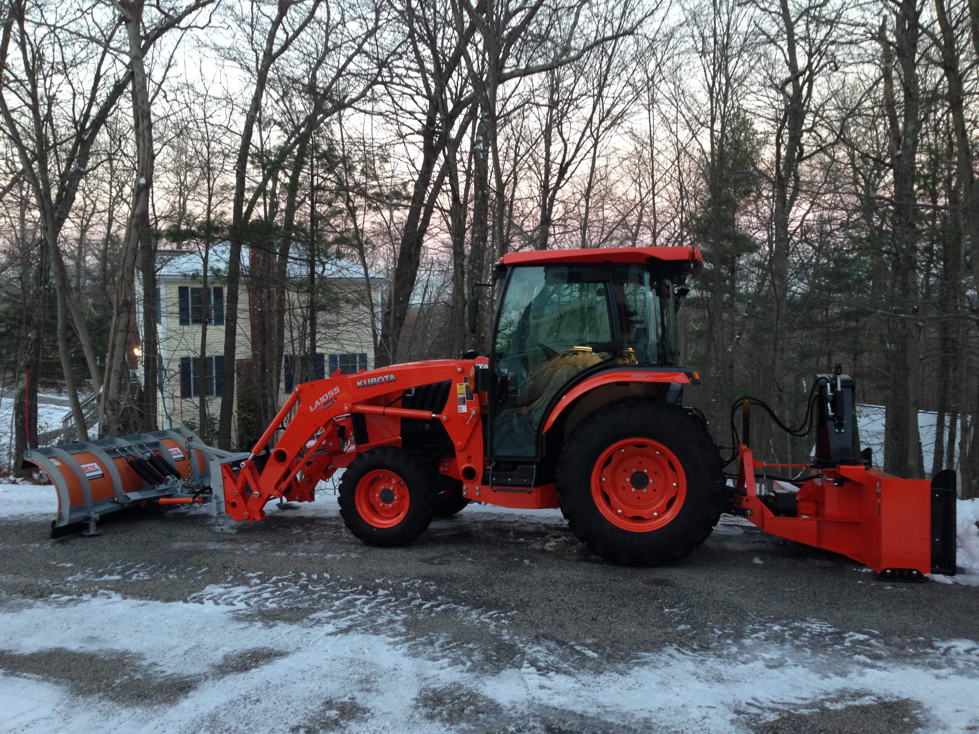

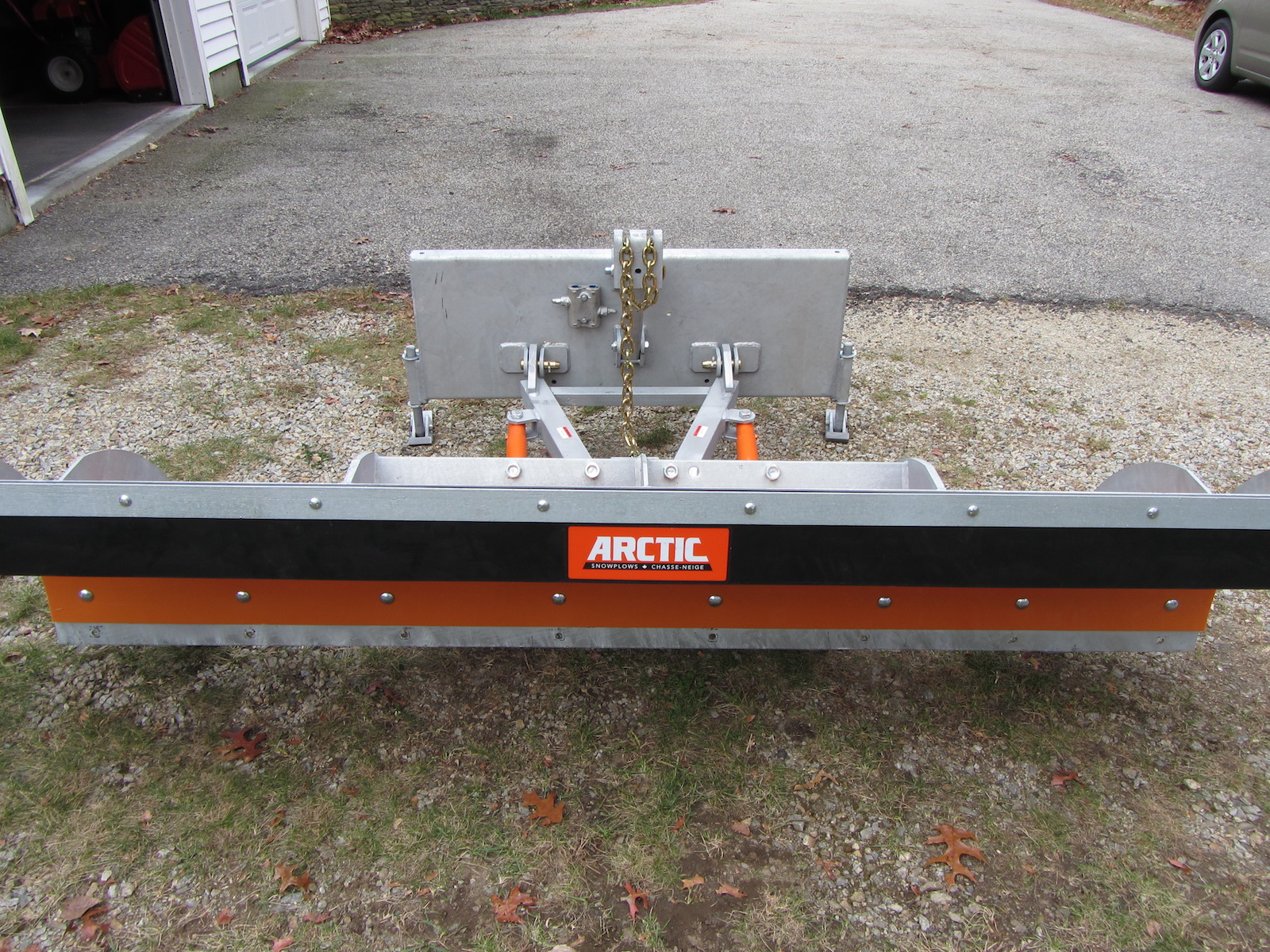

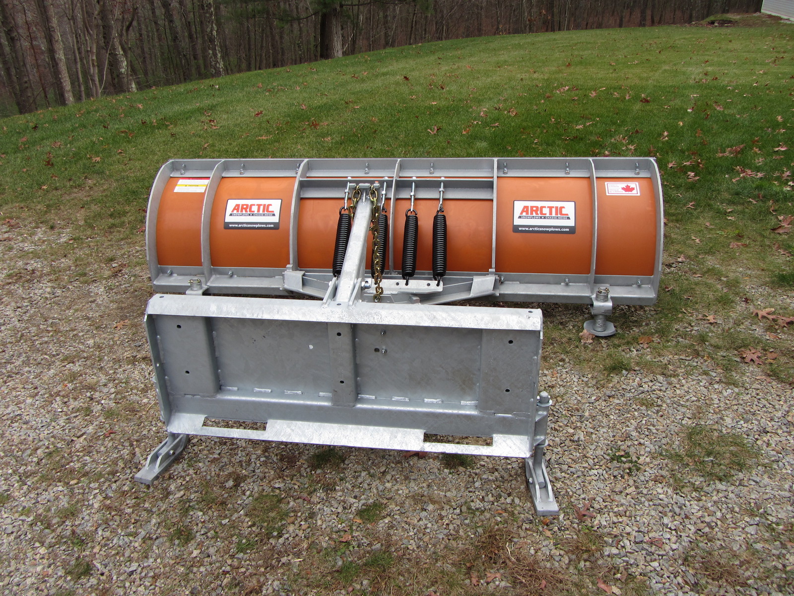

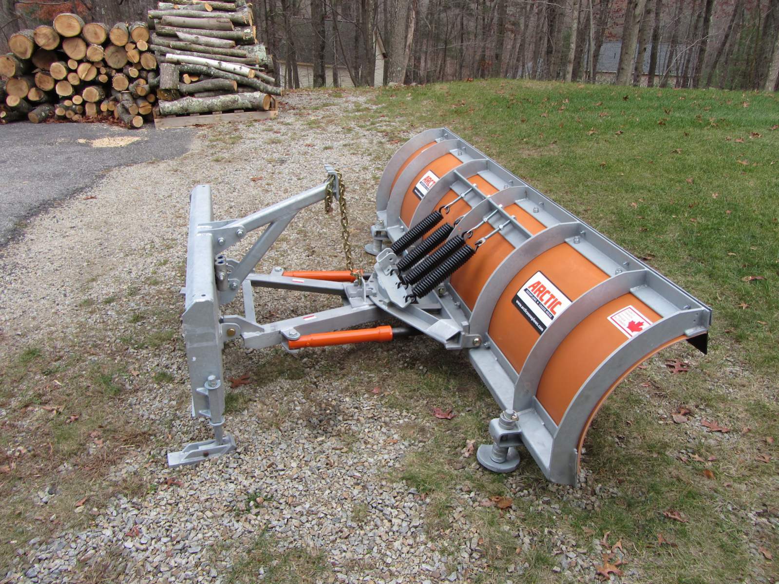

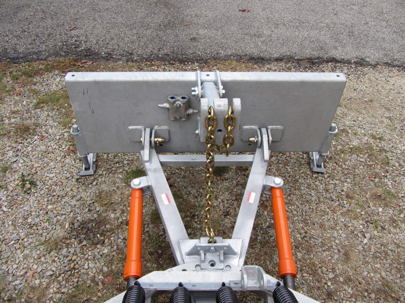

#13
I finally had some time today to start getting the plow put together while my Kubota is at the dealer getting serviced. (Sorry for the long delay in posting some pictures!)
I still need to install the poly cutting edge, shock absorber kit, and the plumb the hydraulics (waiting on parts to come in.) I'll post some more pictures once it's completed and connected up to the tractor.

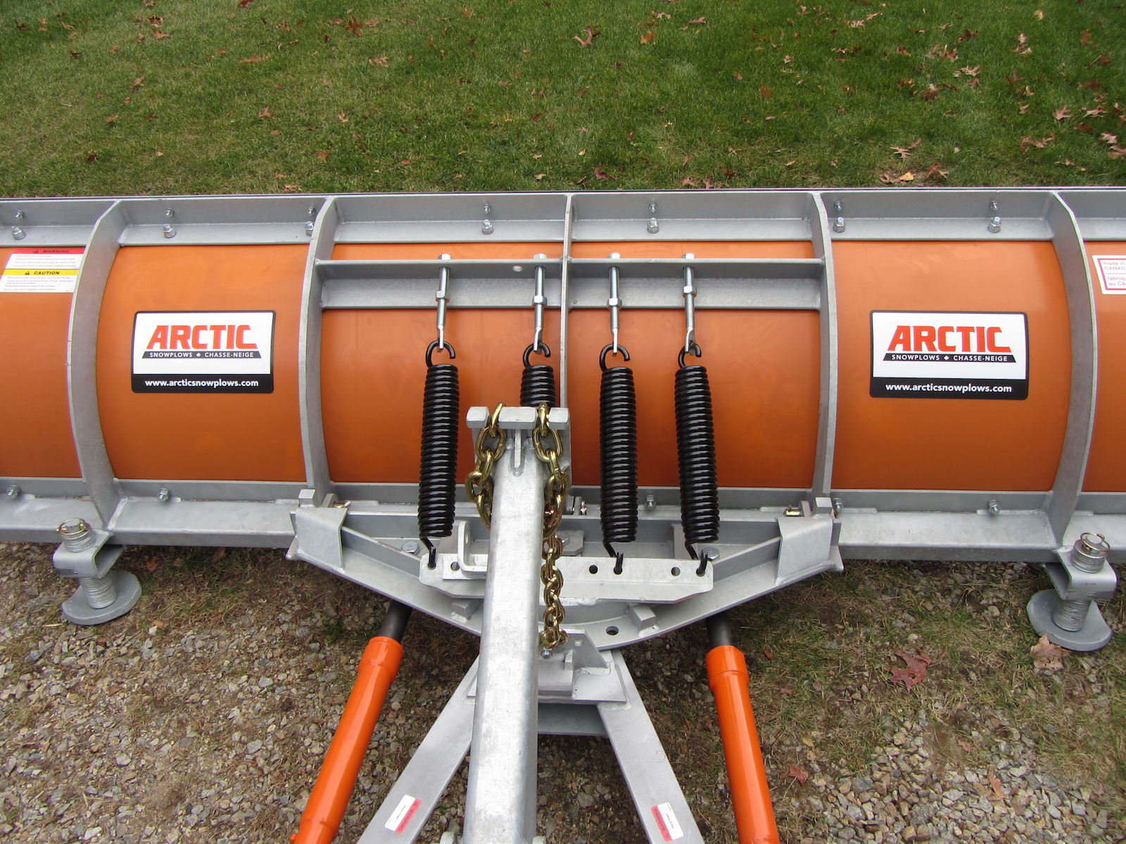

   / New FEL Mounted Snow Plow Delivered Today #14
That's a great looking set-up.
   / New FEL Mounted Snow Plow Delivered Today #15
Looks great. Personally I like to have the down pressure and not the chain but its ones personally preference I guess. Before I put the recoil shock on mine I would get snow building up on the spring adjusters and when the blade would trip the snow and sometimes ice would flick up on the hood so I put the covers over the adjusters. Later on I made the brackets and installed the double acting shock which solved that problem.
The Arctic blade I'm using I bought new back in 1994 so you'll have yours a very long time.
Looks great :thumbsup:
   / New FEL Mounted Snow Plow Delivered Today #16
Wow, that looks great. I like the skids on the QA plate to keep the loader arms from dragging. This definitely looks like a good set-up for someone who wants "float".

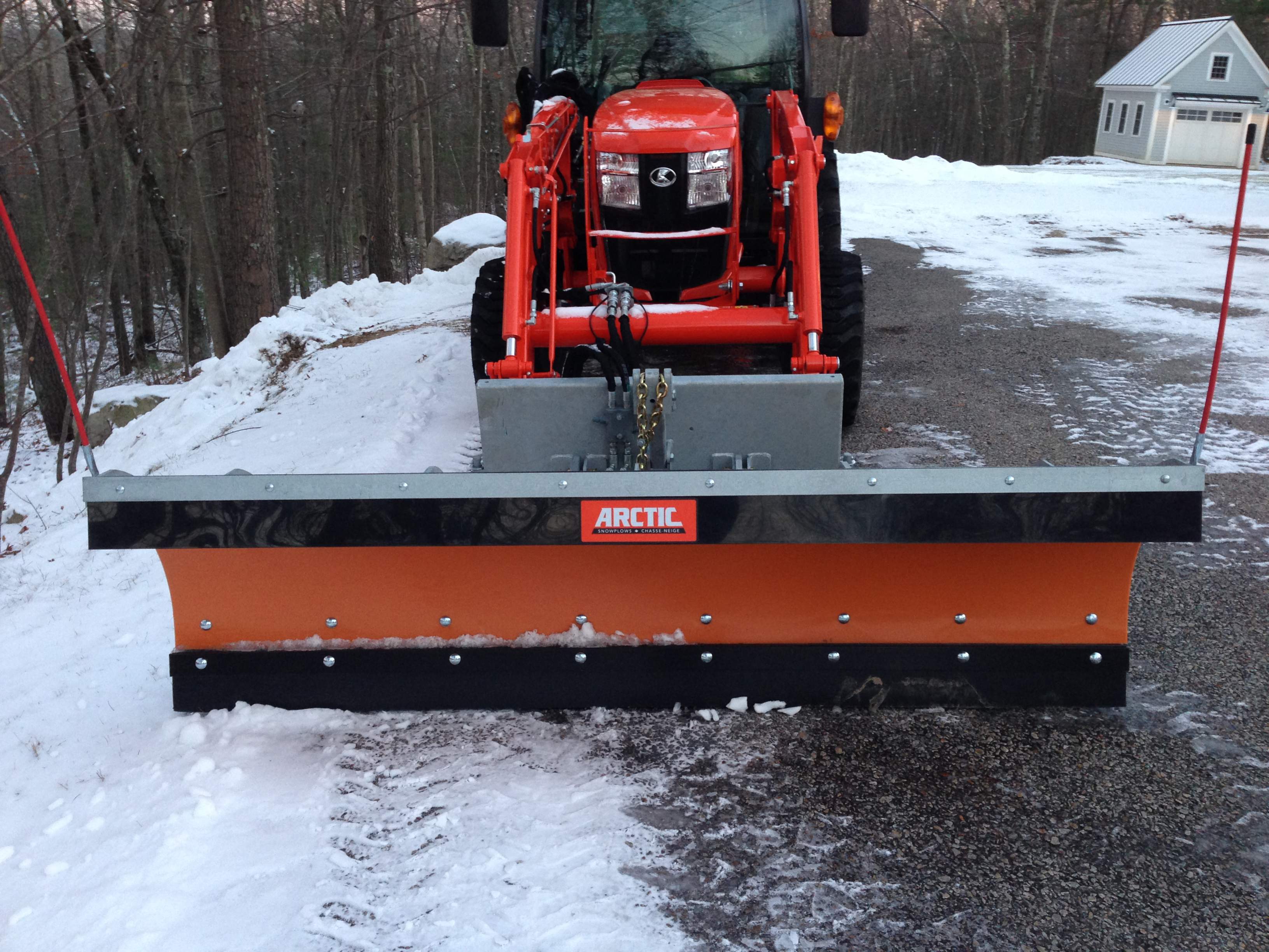

   / New FEL Mounted Snow Plow Delivered Today #17
Really nice looking setup, must have been $$$
One thing I don't like, it sit's so far from the mounting plate.
I probably would have went with a fixed mount plow if my driveway wasn't on such a steep hill. Unlike the chain mount designs, there's an abundance of really nice plow options with SSQA mounts. Although, having used a free floating design in the past to plow my driveway, I knew it was going to work well for my particular needs.
I definitely took your lead with getting the recoil shock after reading your write-up on it a while back. I had Arctic include it, and other than having to drill one hole for the top mount, it bolted right up. It's a nice design and it's been working well whenever I trip the blade.
Hopefully, I will have the plow as long as you! I think it's a great design and I'm really glad I decided to go with it. It's been working so well for the last few snow storms that I haven't even had a chance to try out my new snowblower yet! :)
Thanks. It's been working really well for me, and I've already used the skids on the SSQA mount a few times already given the steep angle of my driveway. (I can see why they included them.)
In my opinion, it's a very well thought out design - I'd definitely recommend this setup for someone who wants to go with a free floating plow design.
Surprisingly, it was the lowest priced plow option that I looked at (even after shipping it from Canada.) The only way I could have saved money was to buy a used plow and build the mount myself.
While it does hang out a bit past the mounting plate, it really hasn't been an issue. If anything, it's a been little easier for me to see when plowing (since I'm not the tallest person, so it's tough for me to see past the hood.)

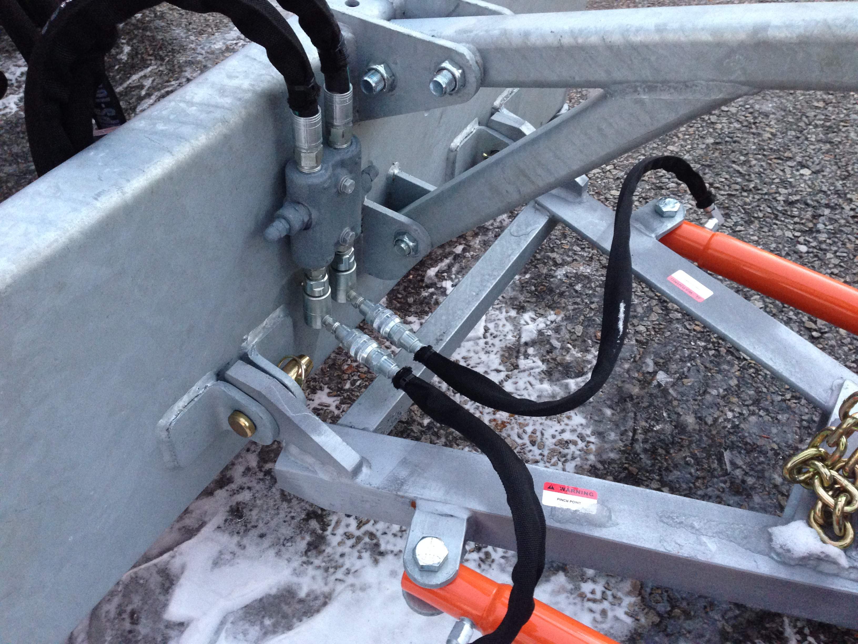

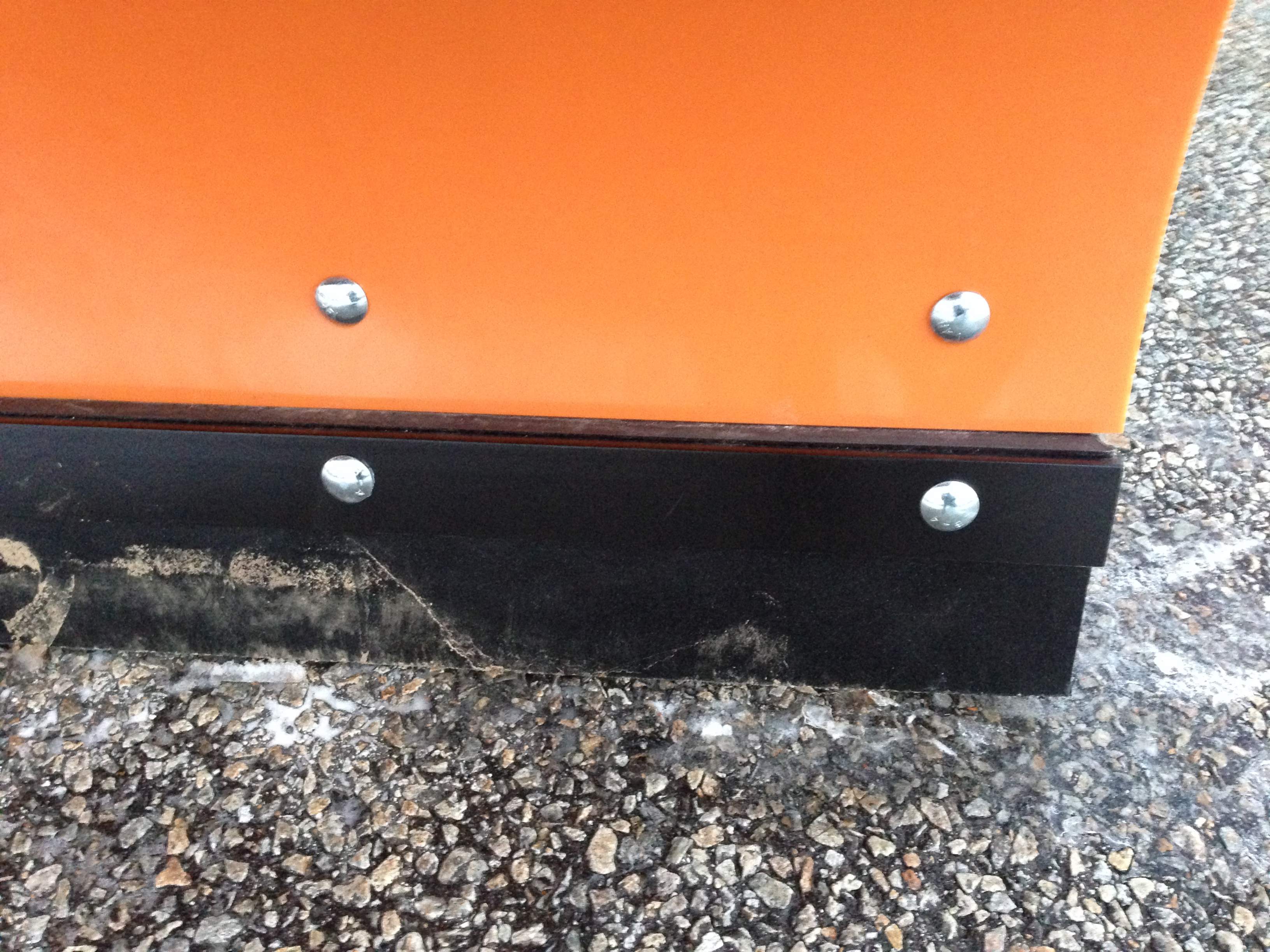

#20

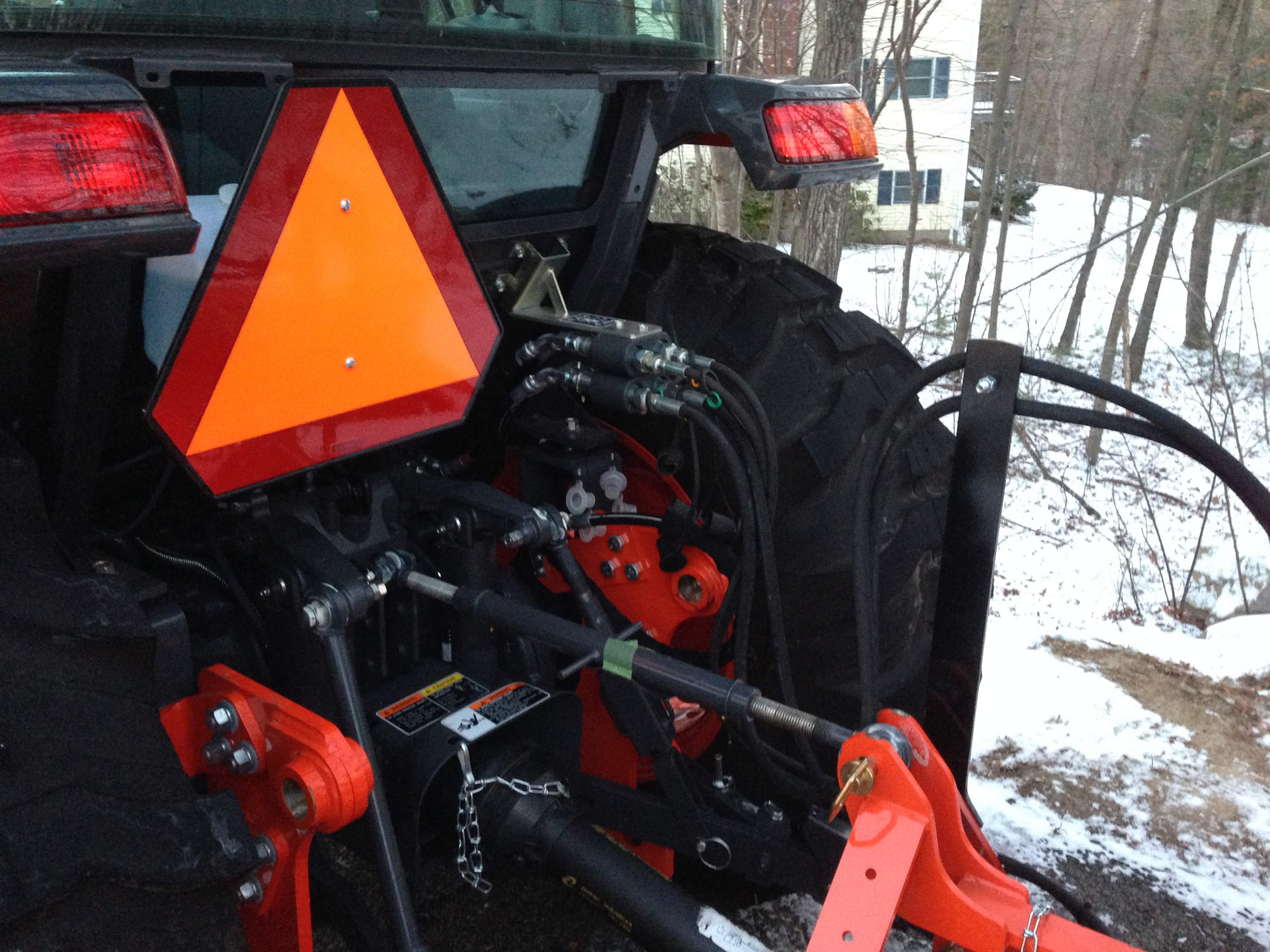

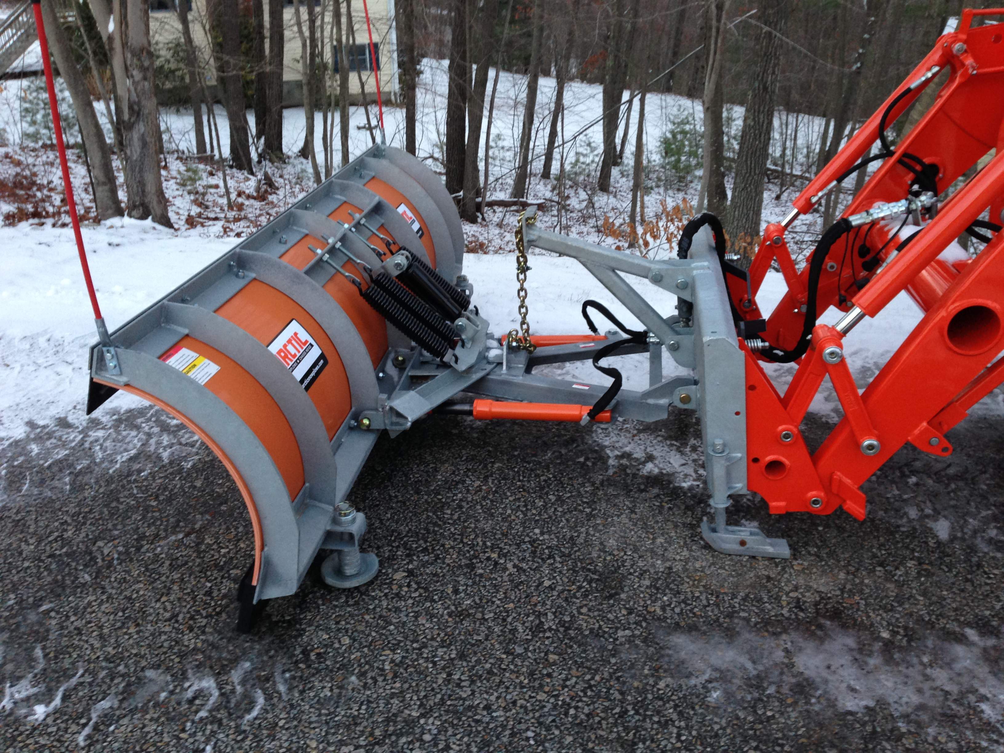

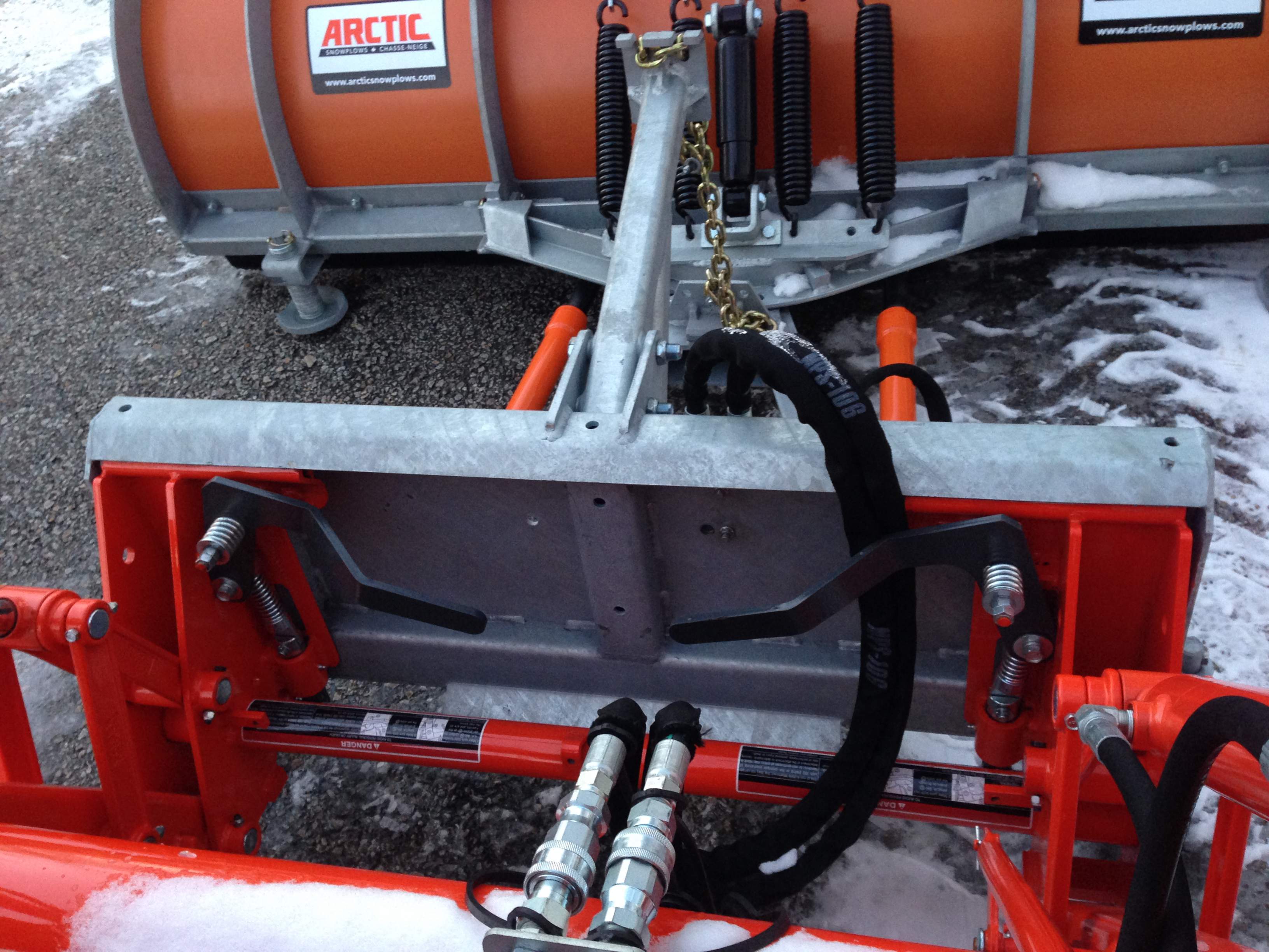

Sorry for the delay with getting some additional pictures posted, but I've been tied up with trying to finish a number of projects before the on set of winter.
From the last set of pictures I posted, all the hydraulics are now finished. I probably went a little overkill here, but in case I ever need to replace or service the cylinders I installed quick couplers to the crossover (ended up useing 1/4" flat faced hydraulic couplers since I got them really cheap.) In addition, I installed live swivels on the crossover and cylinder connections. This should virtually eliminated any rubbing or stress on the hydraulic hoses.
Finally, I had a local company with a waterjet table cut out a 3/8" thick steel strap to provide additional strength for mounting the poly cutting edge. (The Arctic mounting pattern is unique and uses an 8 x 12" on center hole design.) They did an excellent job making it, and it only took them a week to get it done for me.
