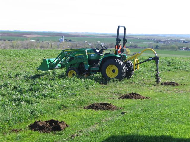

I've been working on fence to define the yard and keep in the dogs, took some tractor time and resulted in a new PHD. This first picture is digging the post holes with the JD 3320.

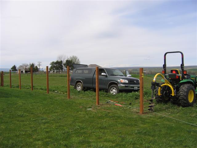

Here the posts are being set- that little yellow thing is a level for setting posts- best $5 I've spent in a long time.

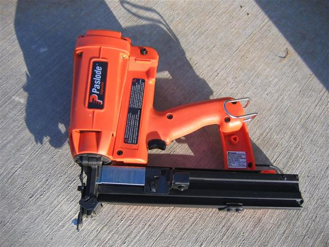

I attatched the 2X4 welded wire using this tool- it ain't cheap but it sure beat hammering in fence staples. It has a battery that sparks a aerosolized fuel cylinder to fire 16 gauge galvanized staples. It worked really well.

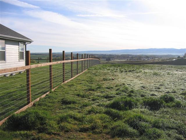

Here's the post, rail and wire with the post tops still running randomly.

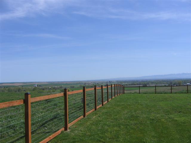

And the finished product.
   / New Fence #6
Beautiful fence. What type of wood is that, cedar? Is it treated or painted or just bare?
   / New Fence
It's the new treated lumber- which looks pretty nice and is left as is. I have a few of the posts that have been in the ground for other reasons and it seems to hold up pretty well. The stuff is extra green- which makes it heavy but hopefully heavy duty as well.
