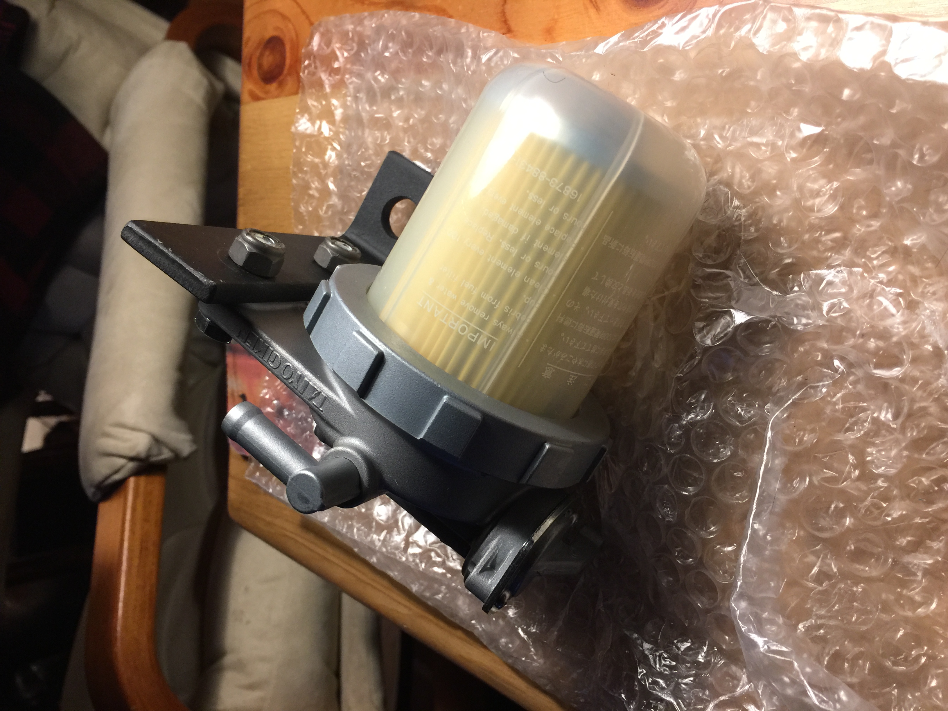

Just got the fuel filter replacement kit for my BX 25D.
Never having seen or handled one of these filters before, it is pretty obvious how it works but it came with a spring inside the filter bowl. I assume it goes under the filter element to keep it up against the top?
The filter element is paper with metal top and bottom and the bottom has an indent about the size of the spring. Just looking for confirmation that it goes there under the filter element. Thanks!

Yes. Typically the spring goes between the bottom of the translucent bowl and the filter.

This filter and housing comes on the bigger Kubota tractors. Kubota has the replacement filters right in stock too.
I bought this same filter and housing in a complete kit for my BX23s. There is a gentleman on ebay that makes the complete kit. (ebay - botasandy)
The guy that builds these kits has everything to install it on the BX tractors, all the hoses & clamps. It deletes the factory filter up under the seat.
The total install only took me an hour. And if you`ve ever had that tiny filter under the seat gel up in winter on you, this kit ends that problem.
Not to mention, it is a whole lot easier to change out this filter cartridge than crawling under the tractor to change the factory tiny one.
Mike (botasandy) is a super nice guy. His kit is the only kit out there that is spot on and fits very well. It is well worth what you pay him for it.
