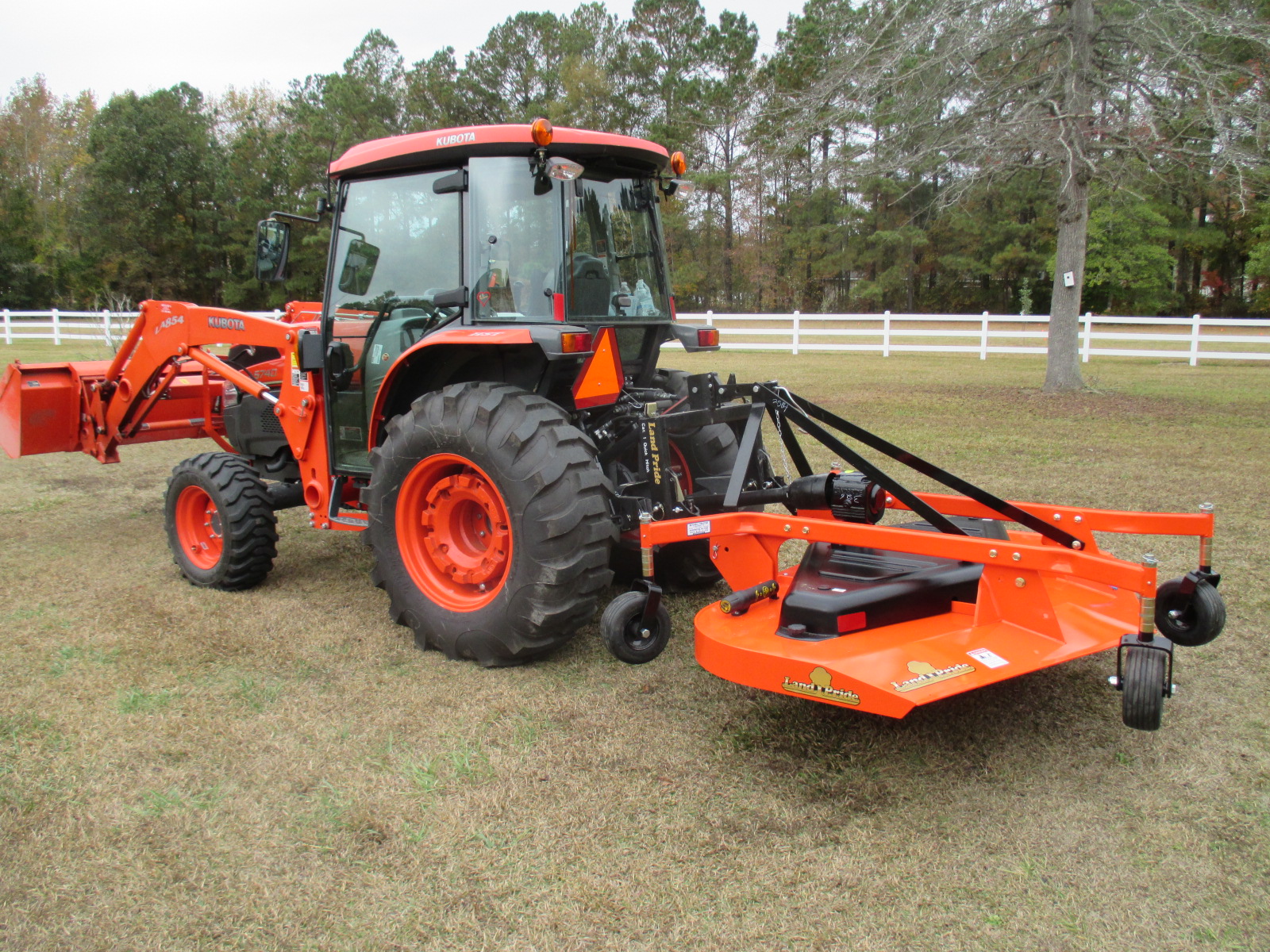

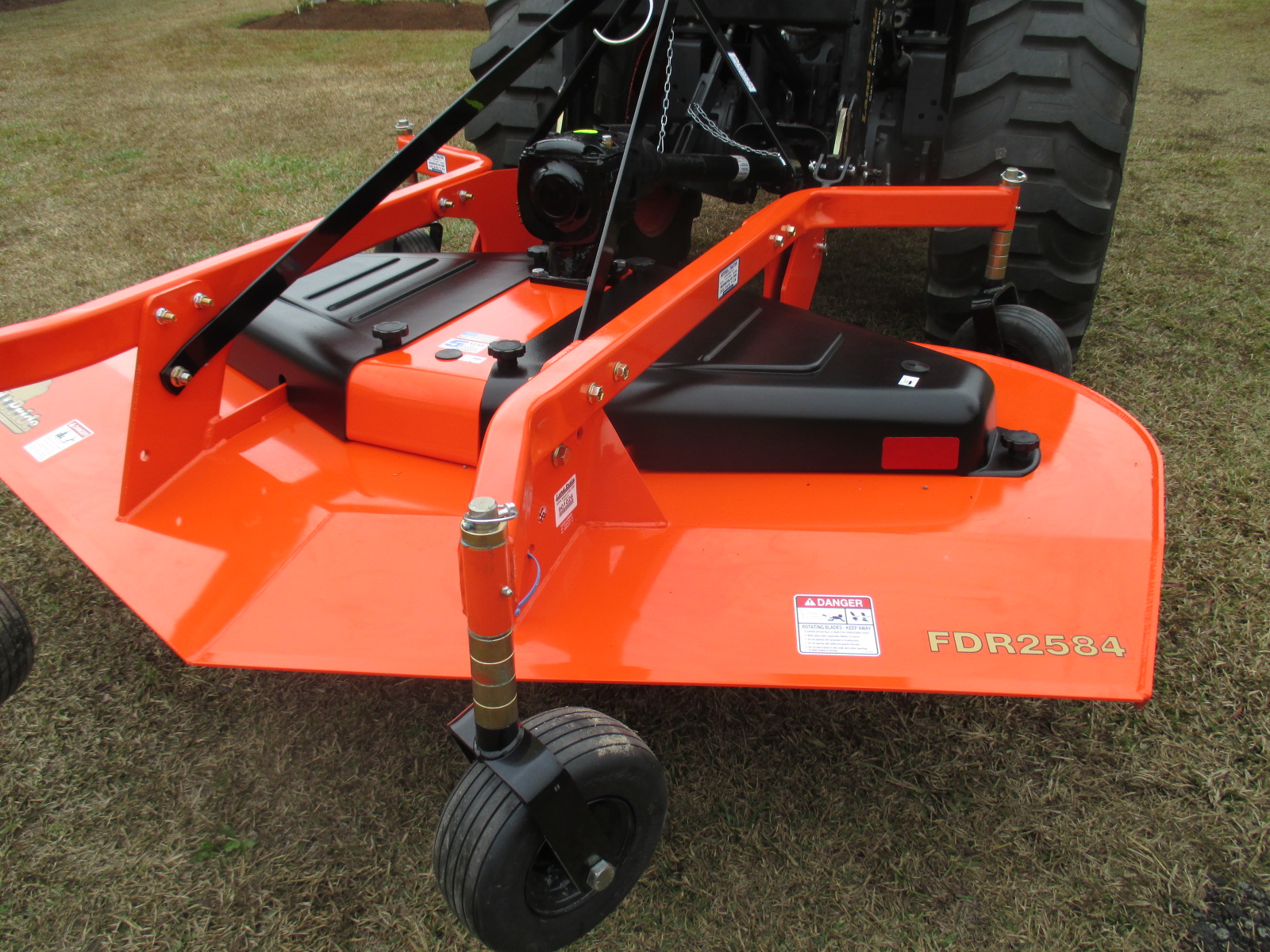

after a really bad experience hauling my trailer an hour away to AgriSupply and finding the mower they put together for me to check out was badly damaged in shipping. And they thought that was ok. broken tires, big dent in the top of the gearbox. No, not for me. So I skipped over the next step up and spent the money to get a Land Pride. It was just in time delivery today so that I could get my field mowed before the rains came.
Mowed very nicely, exceptionally quiet mower, almost zero vibration, and it mowed everything nicely except pine needles which it left in a small windrow. Need to figure that out, and wonder if mowing in a different circular direction would help. The mower seems to stick out the left side more than the right. Not sure that is the mower or my three point hitch.
They sure did shine it up nicely for delivery, and helped me take off the phd and install the mower, and checked its operation, which they already had tested on another tractor. A nice neat and clean piece of equipment that has been thoroughly tested. Well done for the local dealer.
and boy those guys struggled getting that phd off and onto the stand. My digging is done for the year but next Spring I'll need some help getting it back on. And now the new mower goes right off and my ballast box back on so I can use the grapple this winter clearing a road into the back woods.

That Land Pride mower looks great. Congrats on the purchase.
The extra cost of that one versus the AgriSupply one will soon be forgotten. If you had bought the AgriSupply one, you would have remembered how much you "saved" every time you used it.
