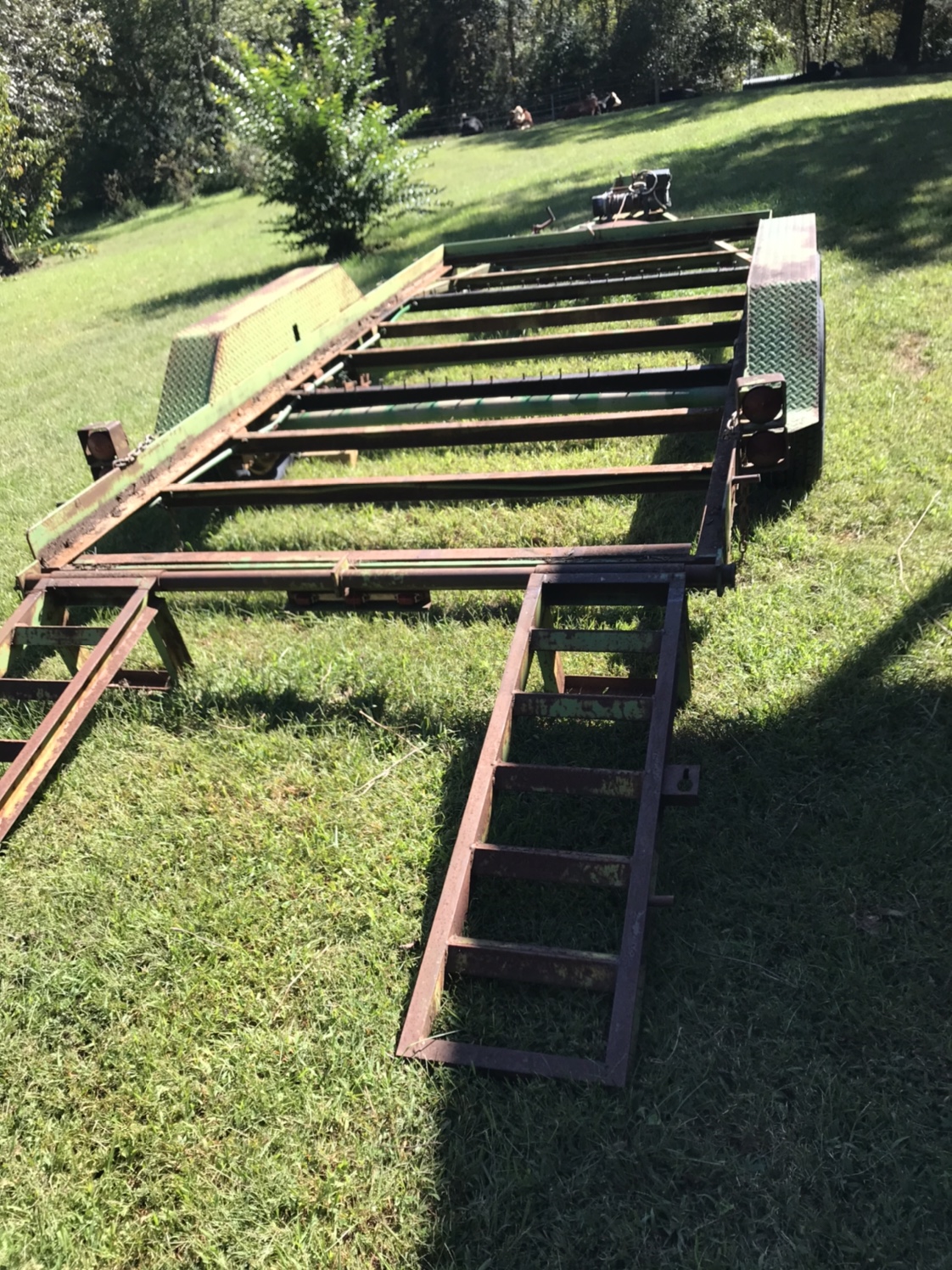

I bought a Hudson 5 ton 6.6x 14 trailer that had been setting for a few years, course it has some surface rust on it, the treated floor was weak in places, it is a 2000 model so I guess the floor held up pretty good. I want to put a new floor on it and have thought about red oak milled down to 7.25 x 1.5 or just replacing with the treated yp like was on it. Also I am thinking about spraying a rust converter on the frame and then a industrial paint, any one have ideas on the floor or the paint? Thanks

The floor was fastened down with 5/16 star drive screws into the cross members, course they were rusted and would not back out. I drilled down beside them with a 5/8 steel bit through the wood and pried the wood up with a 4x4, then cut the screws off with a metal blade. I am planning to use a rust converter that works as a primer on the frame
