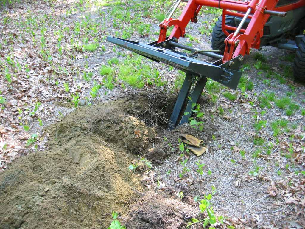

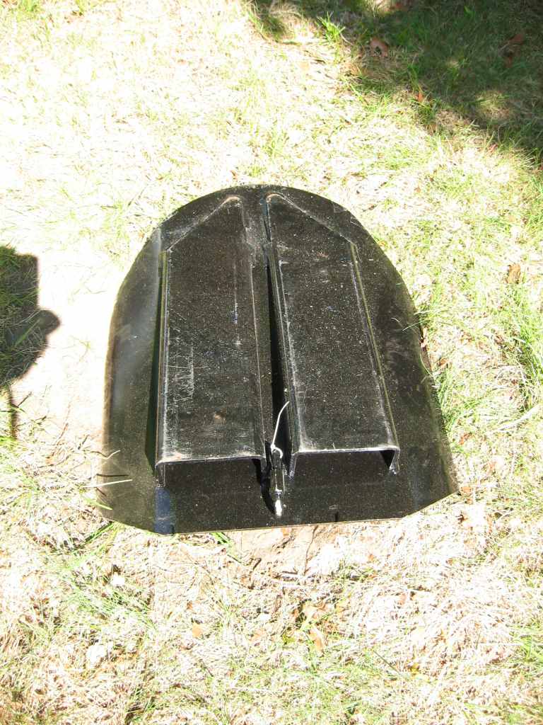

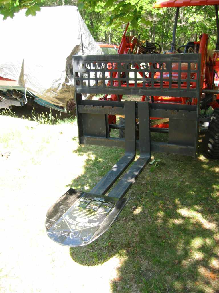

   / New forks - What are your favorite uses? #27
I have this shovel attachment that slides over the forks which is very handy for digging a hole for planting a bush or for digging up a bush or small tree for transplant. Much faster than mounting the BH and the fact that you can dig from the front side is critical if you don't want to damage the foliage.
Digs about 4ft down and is pretty quick but not as fast as a BH. Works well for digging or cleaning ditches. It does require moving the tractor to dump a shovel of dirt unless you have just a small amount which can be dumped in front of the hole.

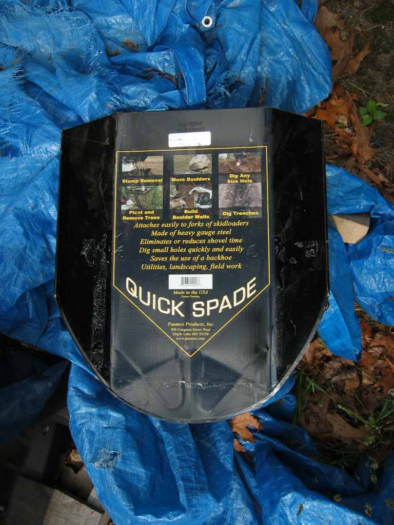

   / New forks - What are your favorite uses? #30
where did you pick up your shovel attachment?
I don't recall the vendor (possibly Northern Tool) but if you search on Quickspade I think you will find it. There are two types. One for forks and one that is designed for buckets. The forks version is cheaper (about $150) and digs much deeper.
This doesn't replace a backhoe but does beat the heck out of shovel work when a BH is not available or inconvenient.
