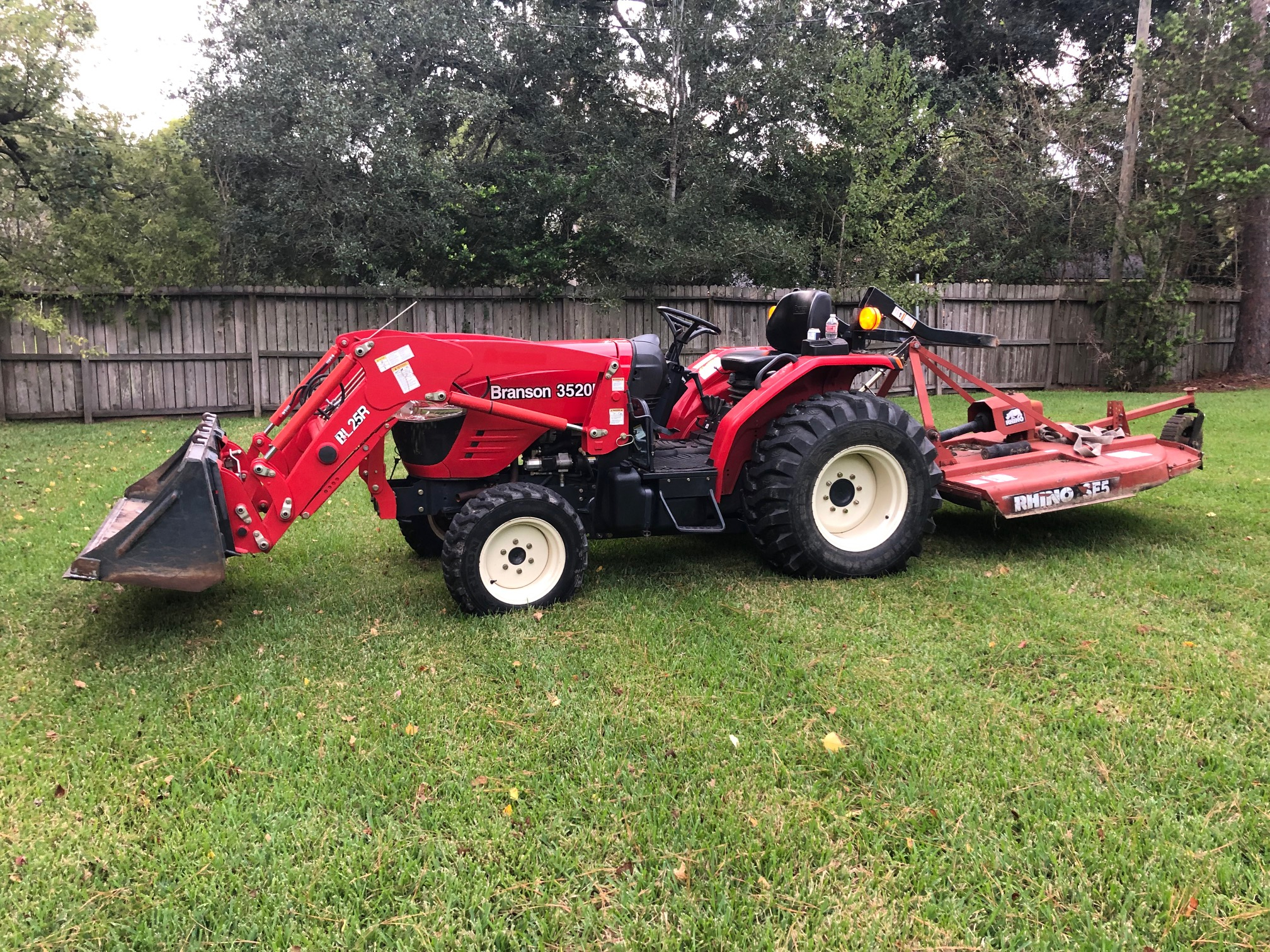

Here's a couple pics. Tractor is in great shape. I've done some shredding with it and like everything so far. I also added some hooks and a new cutting edge on the bucket.
The previous owner is supposed to be sending me the manual. He said he last had it serviced at 150 hrs. It's sitting at 298 hrs right now. can y'all tell me the service intervals for fluid changes ect ect?

Looks like a nice tractor. I am sure you will be happy with it. I'd suggest you practice learning how to remove the FEL (not just the bucket but the whole thing). Mowing is so much better without the extra length, plus the ride is smoother. It is a few minute job to take off and to reinstall once you get the hang of it, but kind of a pain until you figure it out. I will bet that sun bonnet comes in handy in Texas!
