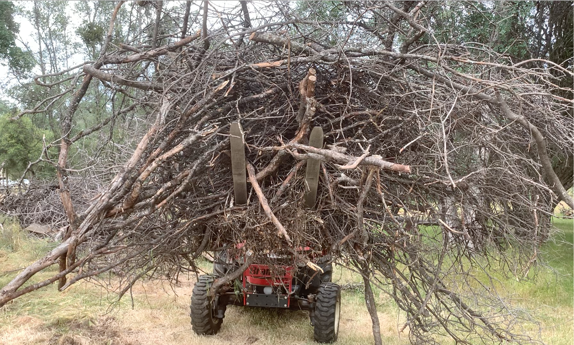

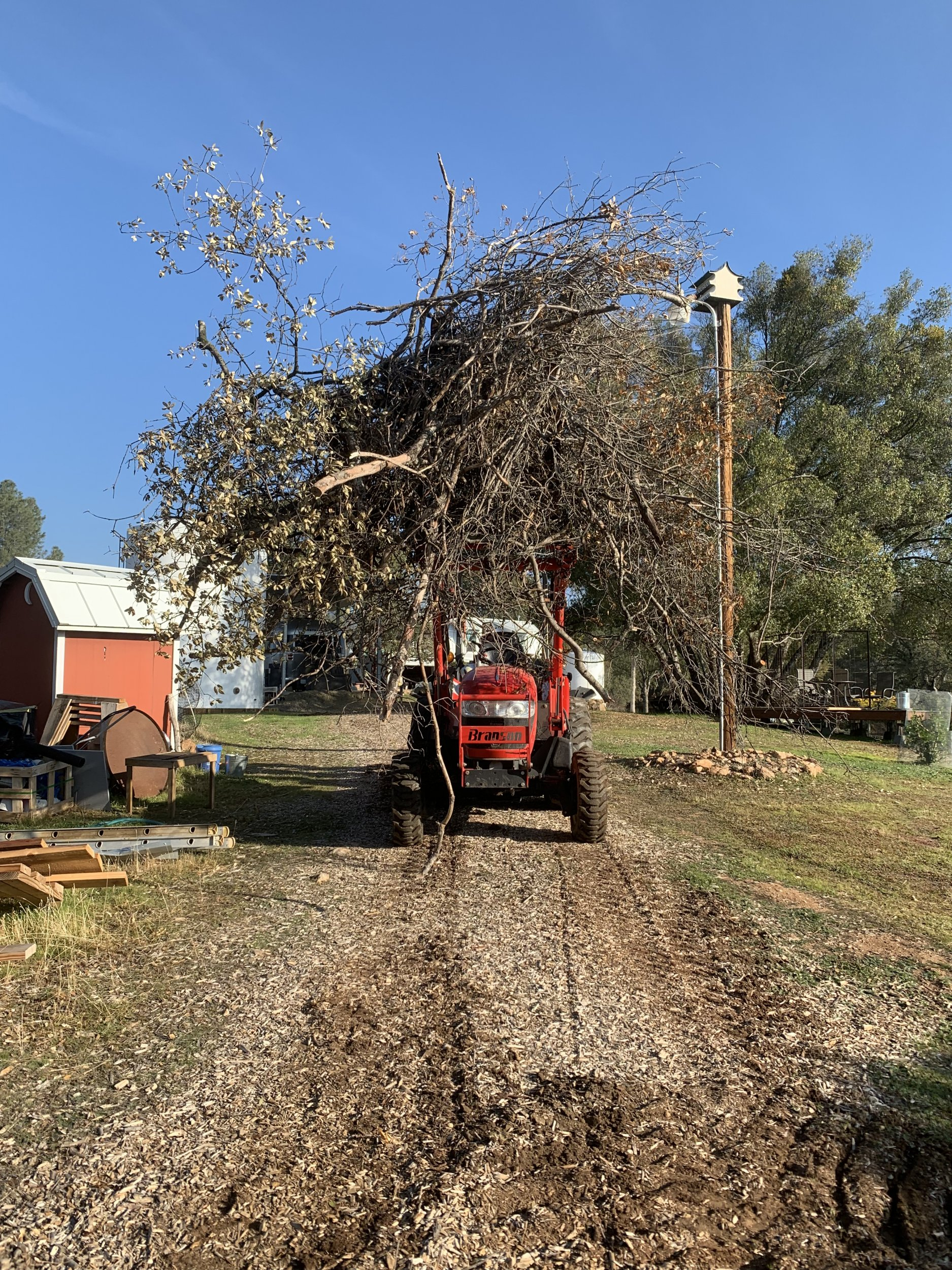

I got an EA wicked grapple (the long bottom tine type) for my 3725. It's been very useful, far more than forks. But it wasn't cheap when I got it and it's surely a lot more now. I'm still running it off a rear remote mounted on the fender.
I believe the loader rating, but that's at full lift. It will lift more than that lower down. I regularly move IBC totes packed full of hardwood splits with it. Calculated weight of Madrone or Tan oak would be ~2000 lbs for 1/3 cord of green splits + 100 for the tote + 300 for the forks or about 2400. I only lift this as high as needed to clear and never more than a few feet. If I do not slide the forks fully into the tote the loader may not curl. With a load out a bit from the pins such as a tote or a log in the grapple, often it's curl thats the limit rather than lifting.
