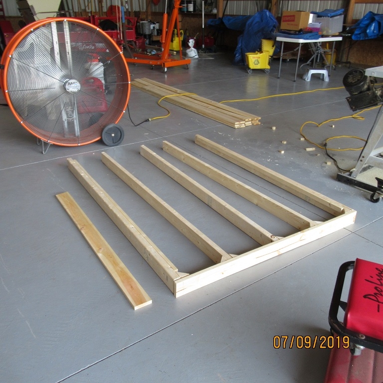

I did a baby-butt smooth finish on mine and put a coat of Sherwin Williams epoxy on it that has anti-slip in it. It works excellent when wet but it is a little slippery with dry snow on it. I've done threads on this so a search would give the Sherwin Williams part numbers, etc. and more pics.
Here's one partial view...
