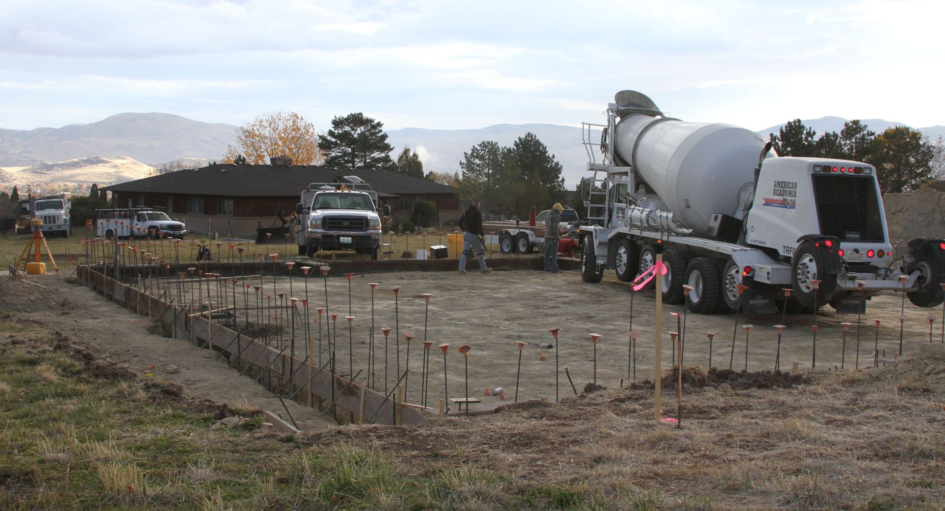

Finally broke ground for my new garage. Soon my tractor and related equipment will have a new home!!
The new garage is 60x60. In addition to the tractor stuff it will also house a motor home, vehicles, car lift, and small office/bathroom/shower. I have rear access to the property so I won't have to use the main residence driveway. It's will be nice to keep my motor home at the house, instead of shuttling back and forth to get ready for a trip.
After much consideration, I am putting a 100a subpanel in for power, (not 200a,) and I brought in a dedicated 1 1/4 direct line from the well for water service. Everyone said a dedicated water line was better than trying to tap into something at the residence.
The best part: it will have an outside concrete pad. So at the end of the day I will be able to pull onto the concrete and hose the tractor down before putting it (and the mud) into the garage.

Sounds like it's gonna be nice. I can't wait to see how you span 60 feet. Will it be metal or wooden trusses?
How high will the walls be and how big will your door be to get your tractor into it?

Thank you all. This is a big undertaking and I appreciate the positive comments.
It's a metal building, at the rear of my Nevada property. I have a similar metal building (60x50) in California which has served me well, and which I will sell when this is completed.
There are three columns (one each end and center) that span 60 feet for clear space in the middle. The top "plate" on the side (with eave) is about 16 feet to accommodate a 14 foot high rollup door for my motor home. With 4/12 pitch the roof height will be about 26 feet. I have five rollup doors total, ranging from 10x8 for my Massey SCUT to 14x12 for my motor home. I only wanted one "walk door" but to meet code I had to put in two.
Hard to believe, but with a 44 foot motor home and slides extended it takes up between 1/4 and 1/3 of the building, if you count a comfortable buffer to walk around and do work on it. So, throw in a few vehicles, a car lift, and a tractor and implements-- and I can already see the building filling up. That's before it starts "shrinking" as was just pointed out. :laughing:
