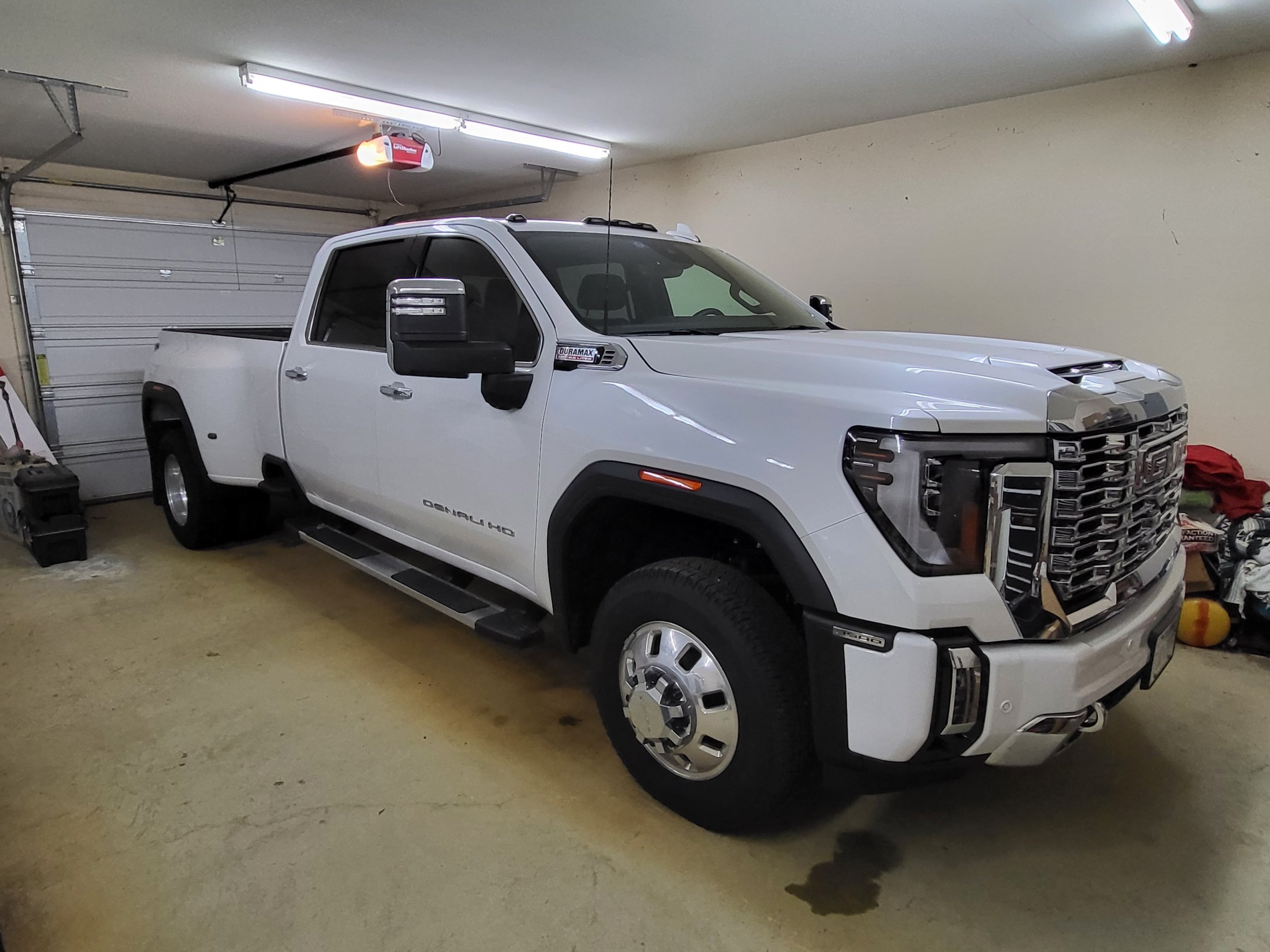

IME, I would use 4 doors. A 16 x7 doesn’t allow enough room to get a FS p/u and FS car in side by side . My p/u is 8’6” by itself

In Ontario our max allowed vehicle width is 2.6m or about 8'5". I'm surprised your truck is so wide unless you are measuring with the mirrors fully extended. Duallies normally max out at 8 feet.
Dont know what truck he has or where he is measuring, but its not uncommon up here to put a flatbed on a dually and the flatbed is 8'6" from rub rail to rub rail. Basically about 3" wider on each side than the tires. My flatbed is that wide as well.
And a 7' garage door is REAL freaking close. I have 9x7 doors at my house garage. Truck dont park in that garage but have had it in there a few times unloading stuff and its TIGHT. Throw in the fact that you are in canada....couple inches of snow and you may be scraping the top of the cab of a pickup with only a 7' door
Ram 3500, no way I would fold the mirrors every day I pulled in or out of my garage.
2.6m is 8.53 feet or 8 feet 6” and 181/500 ;). Makes me legal by a tad over 9 mm.

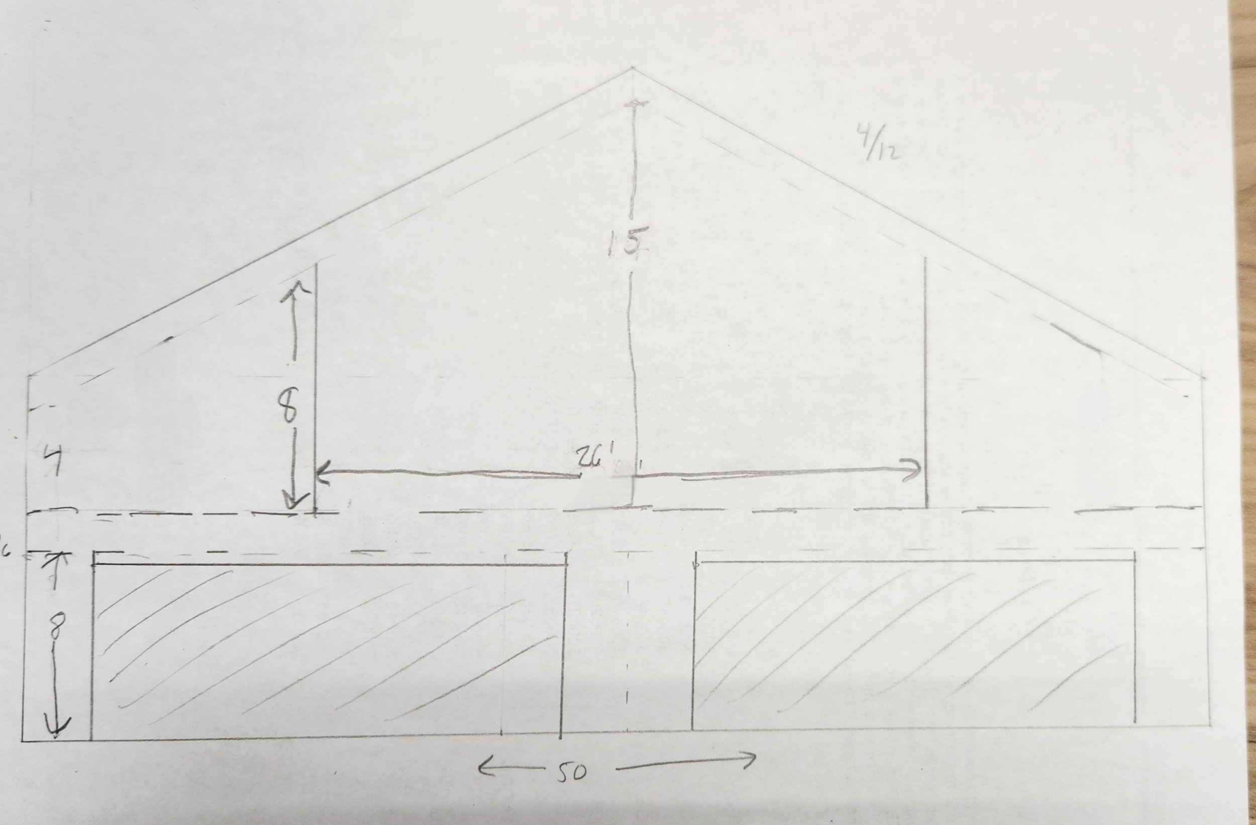

I'm looking at adding a 30x50 garage with a second story and two double width doors for parking 4 cars.
I have local height restrictions max 8.0 m or about 24 feet to the peak. Ideally I am looking at an 8 foot finished ceiling height in the garage and a sloped ceiling on the second floor. For walls I want to go with ICF and the second floor to be steel truss with reinforced concrete so I am losing about 2 feet for the 2nd floor but will have clear span underneath. I also plan to super-insulate everything for my cold climate to make heating the space cheaper.

My shop is 50' on the gable end and 4/12 pitch. 12' side walls gave me 20' at the peak. The bottom of my free span trusses give me a little less than 11' of clear headroom along the walls.
Theoretically you could go to 16' side walls that would get you to max height. I'm not sure what your roof pitch requirement is. I assume you get snow there... We don't really get snow here... This is a not-to-scale sketch if it helps visualize what you would have with the maxed out height with 4/12 pitch. Dims assume leaving 1' headroom for trusses. Is it about what you were expecting? I have an 18' wide door and park a 3/4 ton and a small car in it. No issues with that size, but I just have 1 door and park the truck angled to the outside. I've never tried to park them straight and just the width of the door.

The local zoning building height is restricted to 24 feet. If I do 10 feet in the garage that severely reduces the occupied space and head room on the 2nd floor if I use a sloped roof.

We have 9' ceilings with two 8'X10' doors 30' deep and one 8'X8' door 23' deep. The 3500HD fits through the door with about 6"- 8" inches to spare on the mirrors. I would go with 12' wide doors if I had to do it again.
