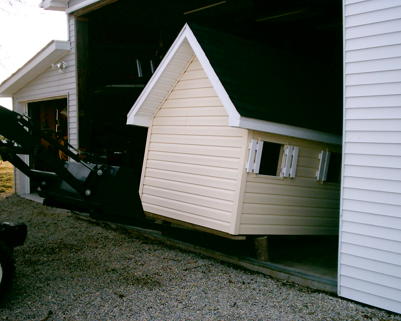

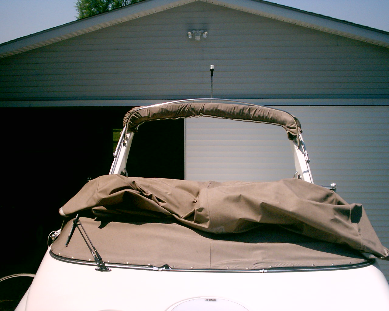

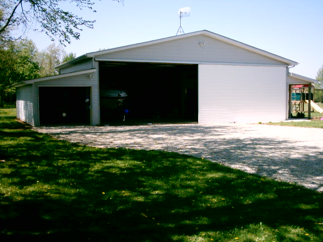

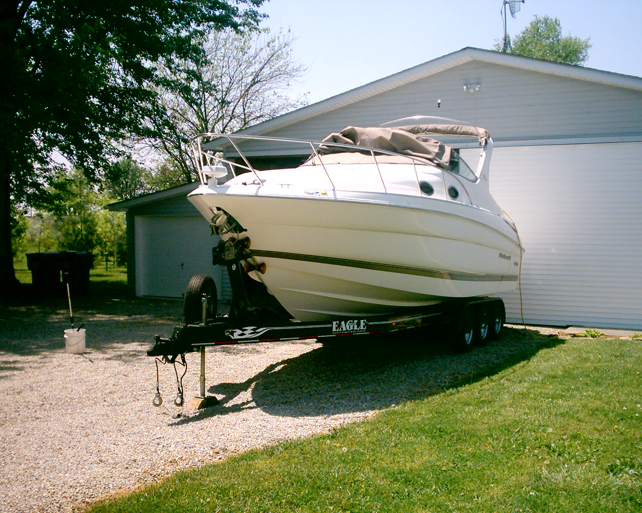

Do not make the mistake I did and only go 12' high. I can not get my boat in my 12'tall by 20'wide door. I also can not get a camper, dump truck, and a Case 580 Backhoe in. I am sure there is more but these are the ones I tried and now kick myself over.
Go 14'. If money is a issue go smaller and build a loft along the back wall for storage. Trust me on this one. I told my buddy the same thing and he did not listen. He went 10' and 2 years later bought a camper. It was never in the plan but things change.
14' will cover all road legal equipment.
By the way, its beautiful land.

   / New Garage Pole Barn 40 x 64 x 12 #7
Chris
Actually go 15' so you can get a 14' OHD.

I know where you are coming from, but 12' eaves and 10' doors will cover my needs. I will have 2 sheds added when it is built. I have the building under contract and when the plans arrive next week and the building permit is issued, the building will be up in about 4 weeks.

PS I will have 2 sheds attached. One is 16' x 32' and the other is 16' x 20'. I can get a boat under either of these if it does not have a tower.

If your going with 12' sides why not go with 11' doors?
On the eave side I need 22" of over head clearance, but on the gable side I could go 11' opening. I think that would make all the difference in the world if it was a camper that I wanted to roll in that 12" makes 90% of them fit. Thanks
