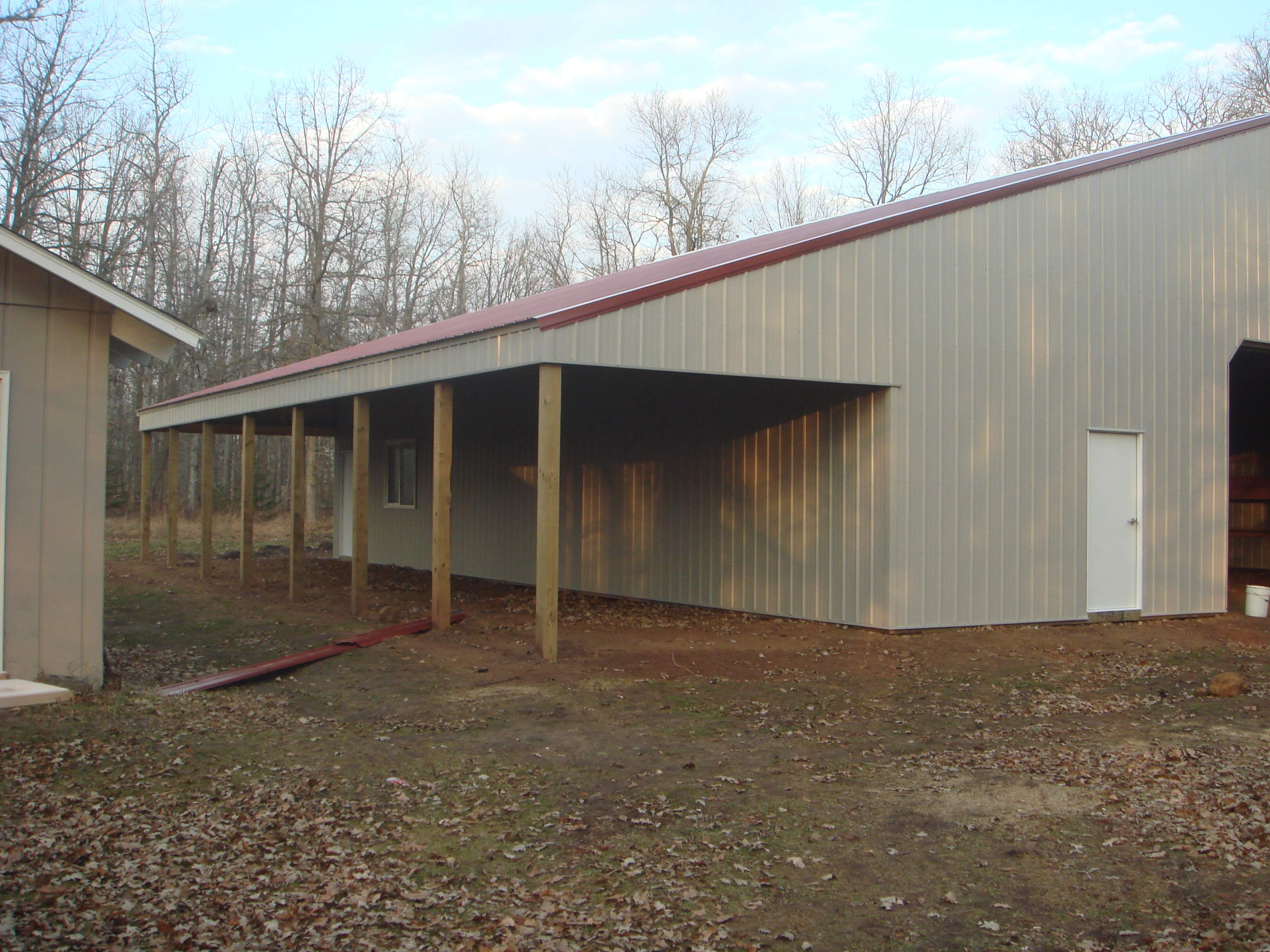

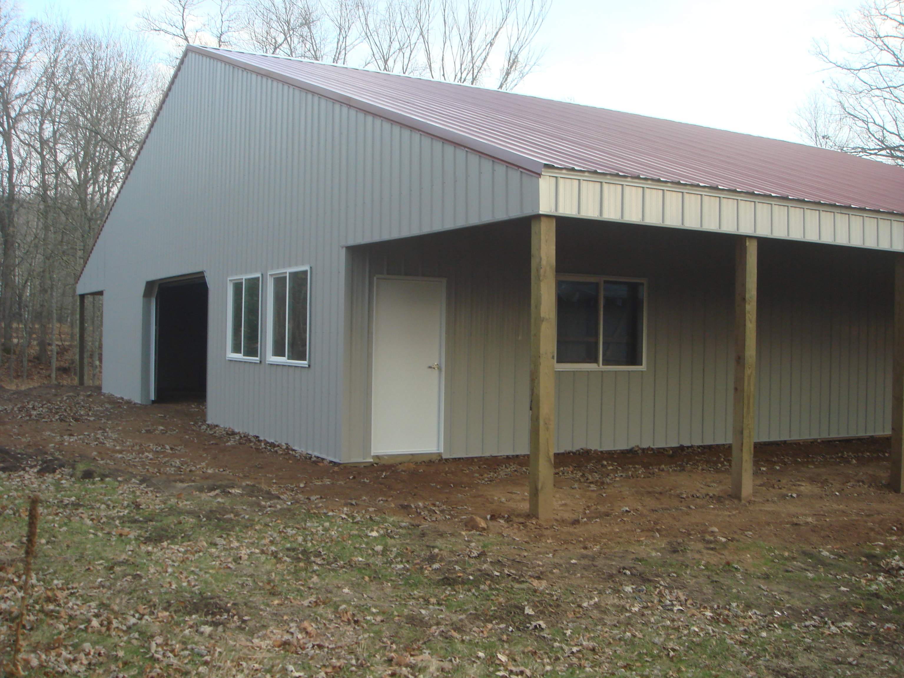

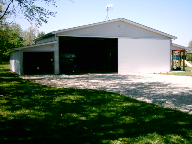

That why we go with sliders around here. I built the door in this picture, 12x20, for $400. That includes the lumber, osb, track, latches, and siding. I used a aluminum end pieces that accept the osb and have a built in J channel for the siding. Got them at my local hardware in 14' lenght for $50 each. Made making the door a 2 hour job.
The pictures show the outside and inside of the door. The inside pic is not the best but all I could find. Its to the far left.
I just don't want you to go through what I go through. I have to pay to store my boat. That extra 2K would be money well spent. I have dropped that in storage fees.
Chris
