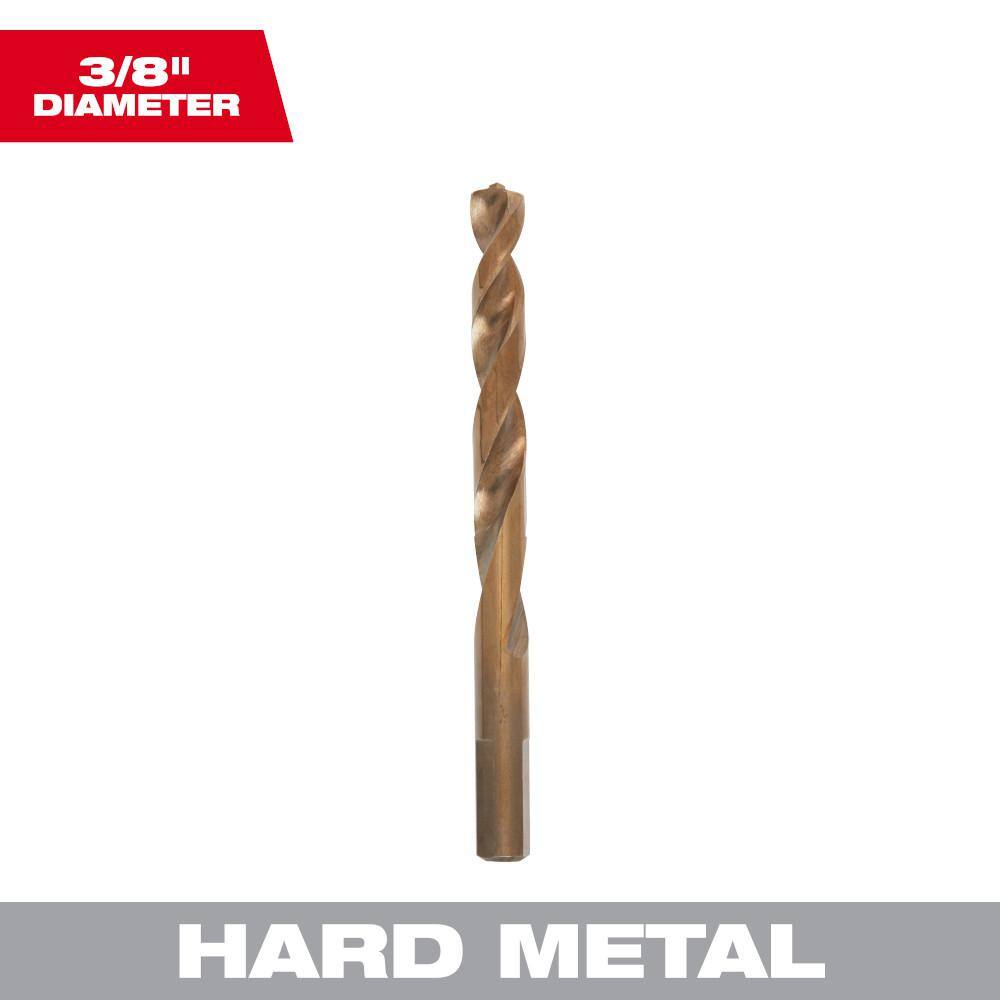

Is there a reason you don't drill a pilot first?
   / New garage time!
#1,374
I did with some. I've snapped 4 bits because of it. With it clamped down, unless the drill is perfectly centered on the pilot hole, it'll put lateral pressure on the bit, which snaps them. Even if I get it perfectly centered, when I pull the bit up I can still see it moving a bit because it's not perfect.
When I was hand drilling I did pilot holes and that eased the pain a bit, but it was still taking forever.
Also changing bits is time consuming. With oil and the proper drill speed, I'm through in 10 seconds. I haven't lost a bit due to dulling yet, but 4 to breaking, and they're $18 a pop.
   / New garage time! #1,376
   / New garage time!
#1,378
   / New garage time! #1,379
I need to buy one of those magnetic drills. I've borrowed one from a friend and I was impressed by how much easier it is to drill through metal with it. But instead, I just buy several brand new drill bits when I have a bunch of holes to drill.
