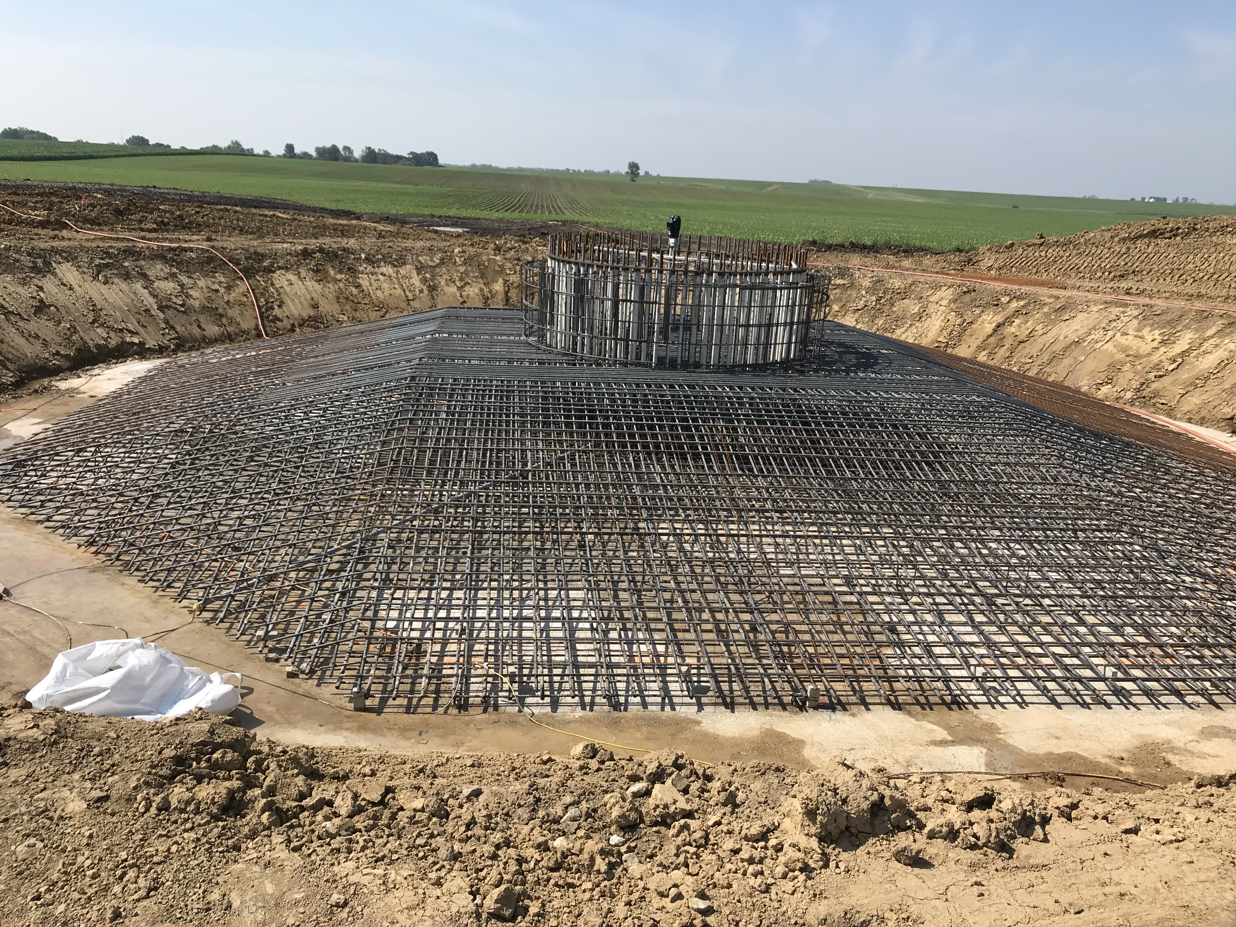

Duplicate this rebar mat and it will hold up you building. This is for a wind turbine.
