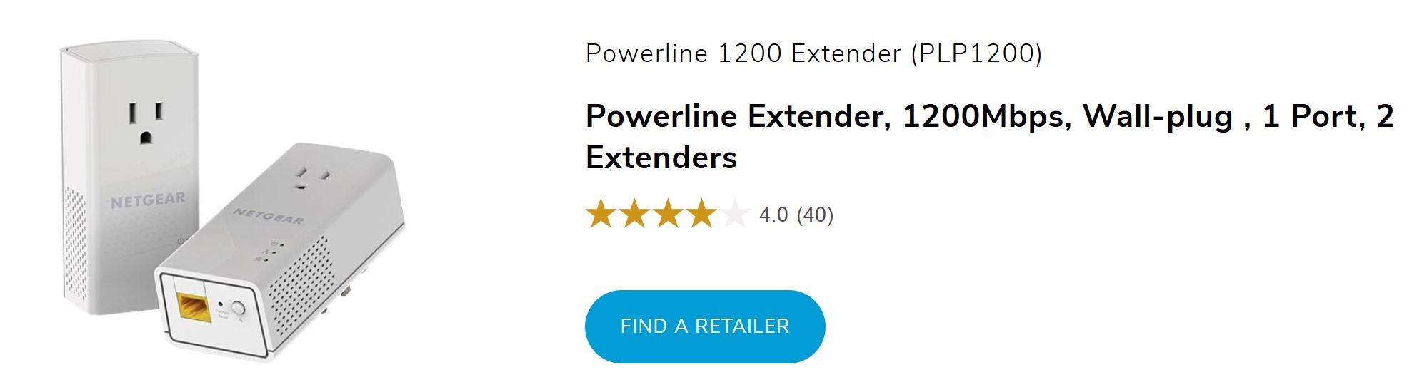

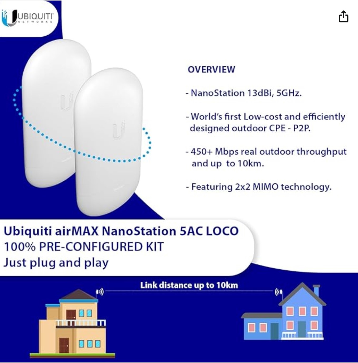

1. Wi-Fi extender as in Wi-Fi received at the back porch and Wi-Fi out to the shop?
or
2. Wi-Fi access point as in Ethernet cable to the back porch and Wi-Fi out to the shop?
or
3. Bridge with Ethernet cable to the back porch, a bridge pair with a unit on each side and Ethernet again at the shop?
Sorry, for the questions, but I am going to replace my Powerline adapter pair (ethernet runs on electrical cables to the shop), which cannot handle the data bursts from my security cameras and am looking at the 3rd option above. I would agree option 1 could be very slow.
What I have and what I am looking at to replace it with
or
or
View attachment 979626 View attachment 979627
Right now i have a range extender on the back porch and inside the shop, and it's not nearly fast enough to handle the cameras, or even an HD stream.
I've heard good things about hte powerline adapters, but haven't tried them myself since the phone line days. Yes, they did exist when dialup was a thing. I've been told they have to be on the same circuit, or at least the same leg of the panel, to work. Again, untested.
That's why I'm running sfp+ between two switches. I have 6 cameras on the shop and inside, plus my firestick and laptop. So I'll be running 10gb sfp+ over fiber or copper

Thanks. I'd do the same thing you are doing if my space between buildings was not concrete.
As far as the powerline carriers go, mine do better on the same leg of the power but have troubles on both. I originally tried both since both conductors running out there are black.
