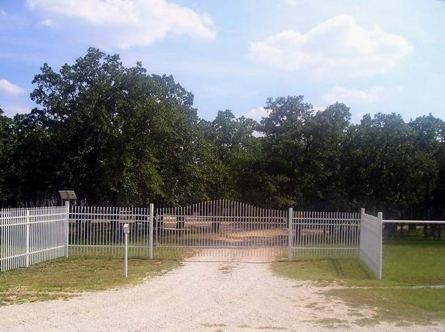

The reason I was so conscious of wind and gates is the gate in the attachment. On Tuesday, we had high sustained winds in this area from the northwest. This gate got blown and shaken pretty hard even though it was closed. When my wife opened it, the top hinge bolt snapped. It's has a zerk fitting where we grease the gate hinges, but this gate is over 12' wide and weighs about 250 lb. and the hinge finally gave up. It's now open and hanging only by the lower hinge. I could hardly lift the end of the gate. The top hinge must have been under tremendous stress. Guess what I get to do this weekend?:rolleyes:

   / New Gate Entrance Project Finished....Almost #15
Jim - is that kathy's gate that you put that opener mod on sometime back? and was it still holding up?

Yep, Mike, it was Kathy's gate. That fence and gate are about 8 yr old. The opener used to break all the time because there was nothing to absorb the shock and a gate that size takes a lot of pull to get it going and has a lot of inertia when the opener shuts off. The guy who built it wanted to make it a 2-piece gate with two openers, but the budget wouldn't allow that. The springs I added under the gate shackle have performed flawlessly for over 3 years as shock absorbers. The opener is still working fine. Since we don't have any support overhead between the posts, we have to make one adjustment during the wet season and another during the dry season. That's it.
