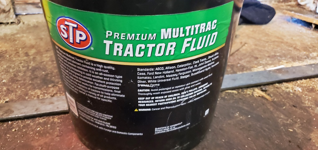

I have a 2010 gc2400. filter wise I just take the easy (lazy) way. I grab from dealer.
for fluids, since I am WELL out of warranty, I use STP multitrac which meets permatrec (massey fluid) milspecs and is made for hydro drives. its, on a 5 gallon bucket, approx 20$ cheaper.
