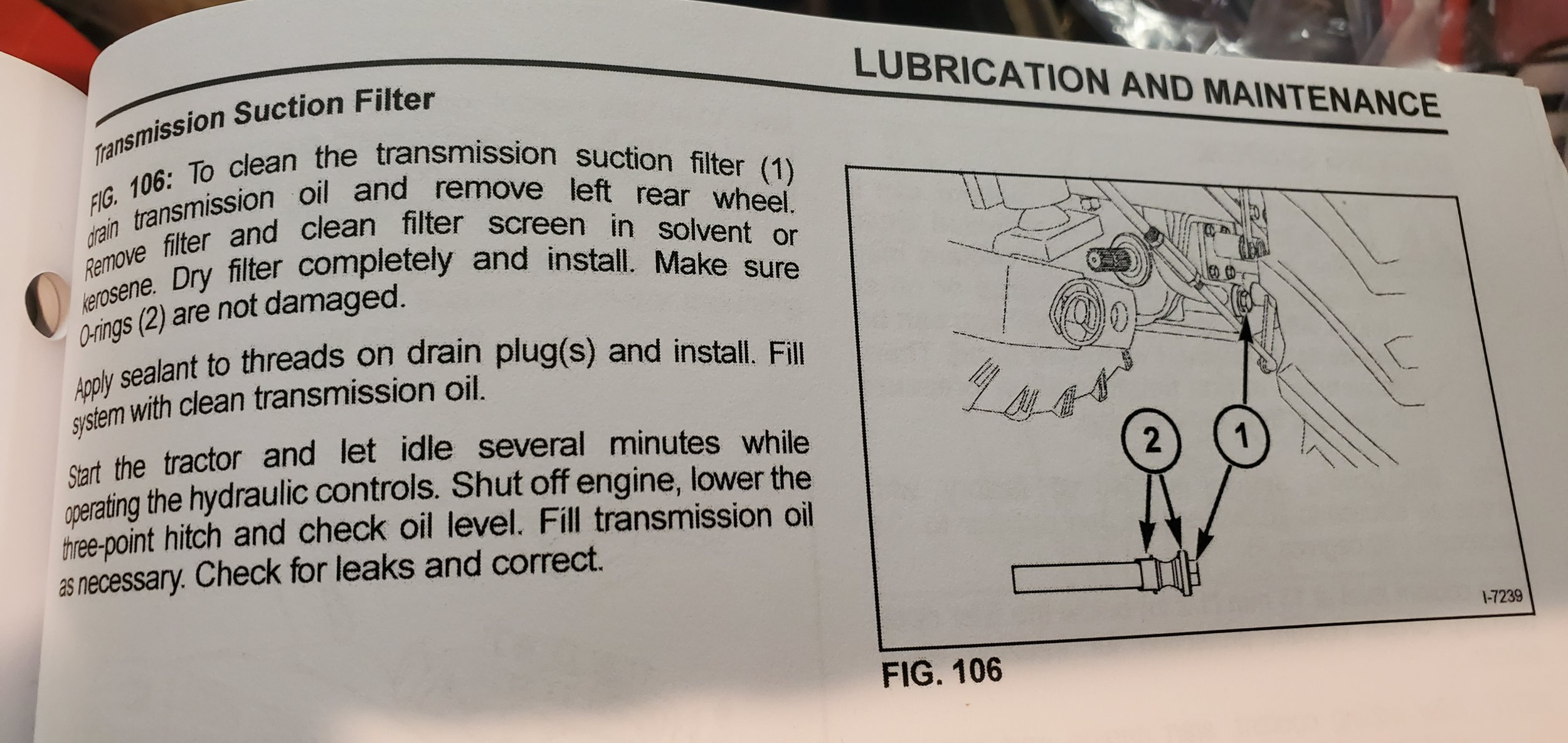

I picked up the case/ ih hy-tran from southeastern equipment last night. All reviews I read are high and the price was worth it to me. Last question on the trans... Is the screen filter something I just clean or do I replace it like the hydro filter?

you talking about the transmission suction filter?
if you have owers manual for gc2400 its page 54 first item
looks like this:
