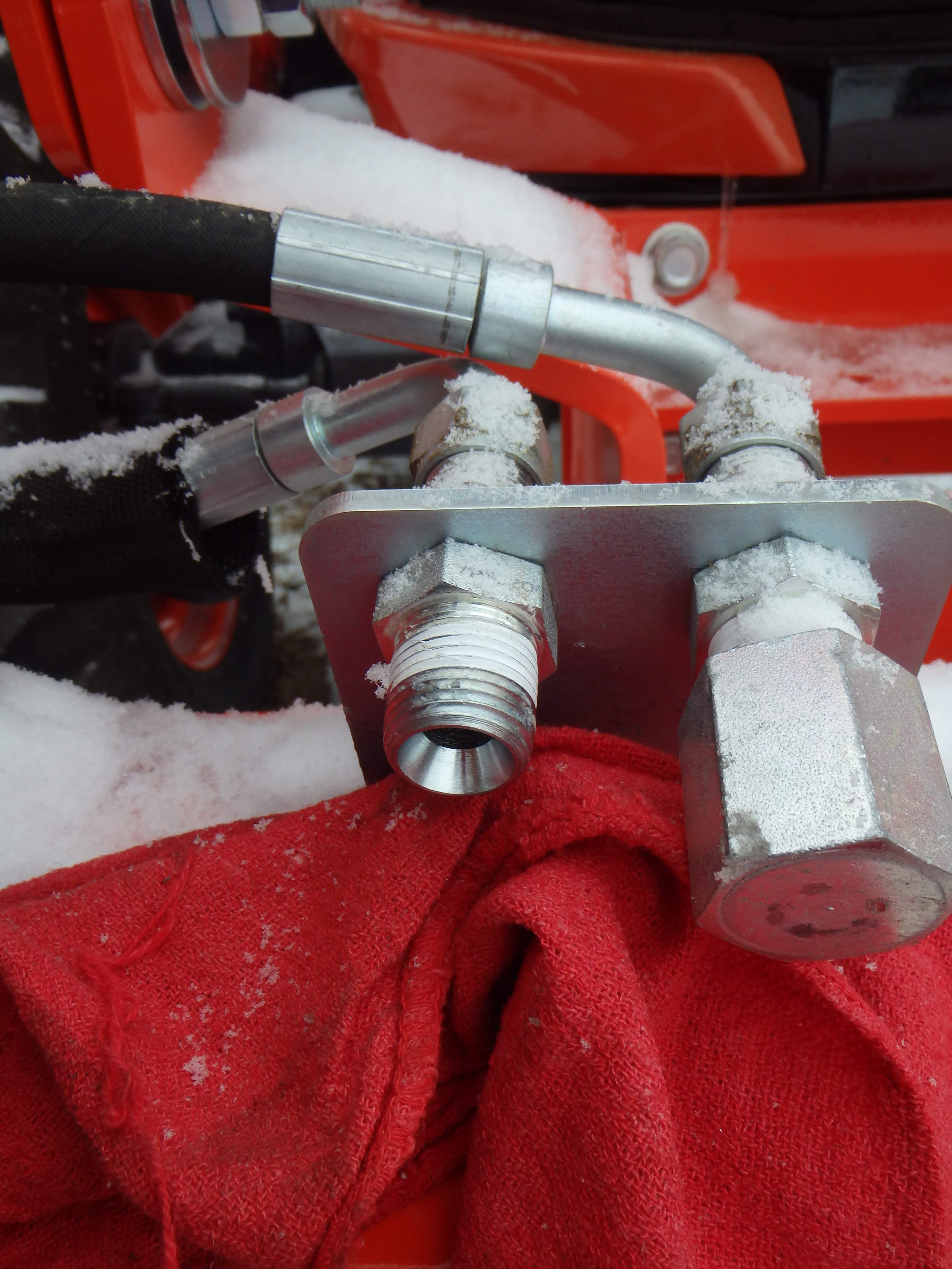

I assumed that there are 1/2 Ag couplers that have the hose end in threaded in either JIC or NPT?? On my tractor the hose ends are male, with caps on them. The hoses are connected to side by side bracket on the front tube of the loader.

I have never seen an Ag connector with JIC fittings. Take a cap off of what ever you have and look at it. It is most likely NPT. 1/2 inch. Please confirm. Please post photo.

Im out of town, But Ill pull the caps when I get home and post pics. I appreciate everyones help.

My Grappl is in the bed of the truck! I cant wait to put this thing on and start moving slash. Ill post pics shortly for the male ends on my tractor 3rd function. The more I read the more I think they're NPT, but Ill look and take pics shortly.

Ok so now we have some pics, name that connection: BobCamera22Nov 352.jpg
