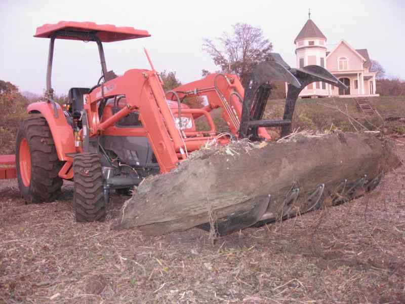

If your hitch will take universal skid steer attachments then it will take the standard Markham grapple. Markham also makes a JD compatable grapple.
You will need rear weights if you intend to lift and more importantly travel with significant loads. I use a mower or boxblade or backhoe as a counter weight. You could also have rear tires filled which would help. Physics, just plain physics.
These light duty rakes are fully capable of handling any non torquing load that a CUT FEL can deliver. If the load is centered then the grapples are stronger than your tractors FEL capacity. Period. I've lifted one ton rocks with a grapple that is lighter duty than the Markham. Same grapple can lift the rear of my ballasted tractor off the ground when stuck under a root. No damage to the grapple at all. The key is to lift straight and centered just as the grapple is designed to do.
