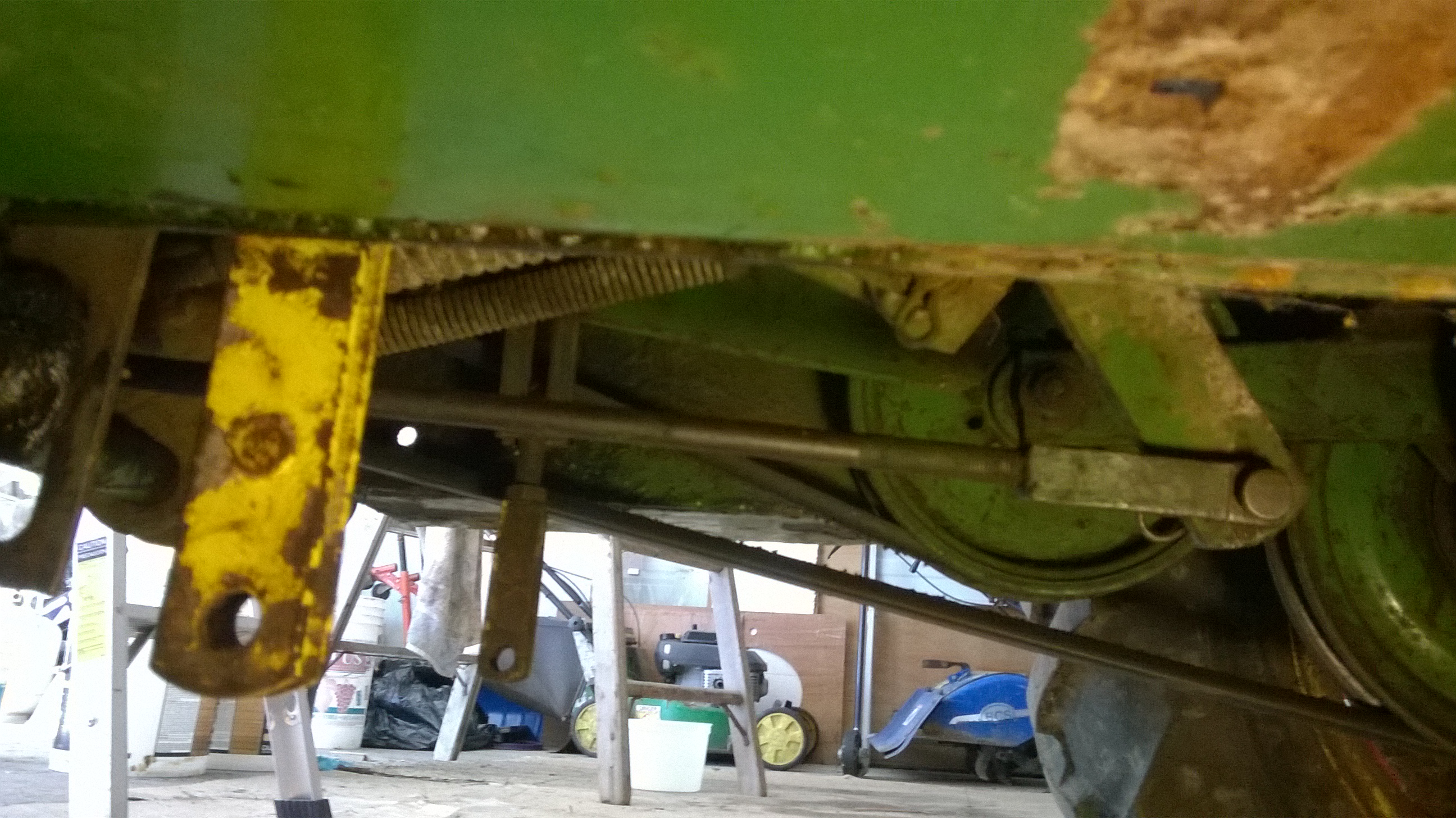

You guys are great - I think yankeerider had it right. The rod I have is probably the wrong rod - the fella I bought it from is getting up in years and may have just lost the right one. The pictures from Richard (Many thanks!) seem to confirm it. I need to spend a little more time poking around under the tractor with my newly acquired knowledge.
I will attach a picture (excuse the mess - clean up has not yet begun)

A big thank you to Richard who took the time and trouble to get me a PDF of the blade manual showing the installation. It confirmed I am missing a connecting rod. Knowing that, and seeing how it connects, solves my issue (at least once I track down or just make up the rod!)
