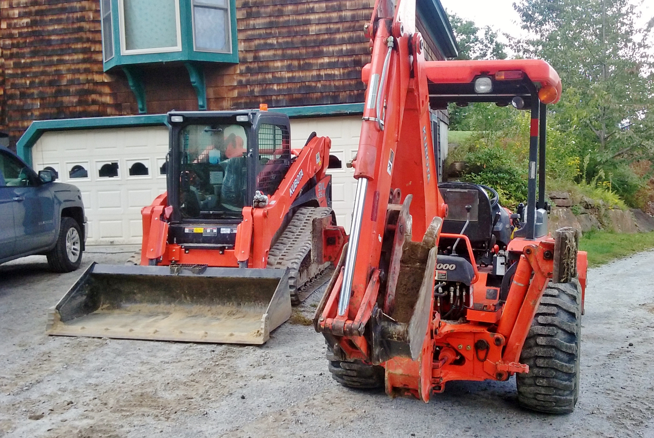

My neighbor has the L3901. definitely a lightweight. See what he bought for the heavy work.
My L39 is my big tractor Max28 is my little chore machine.
I would move up in size considering what you will be doing with this tractor.
