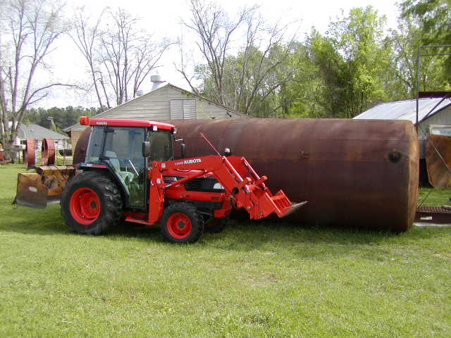

Reminds me, a while back, I had just rolled this 7-1/2'x25' steel tank up onto his goosneck trailer, and was smoothing out some holes. This man had gotten off his gear tractor & was just sitting, watching me use a box blade among some stumps. When I quit, he said I hope you have someone to inherit that tractor, because it will still be going strong when you are gone.
