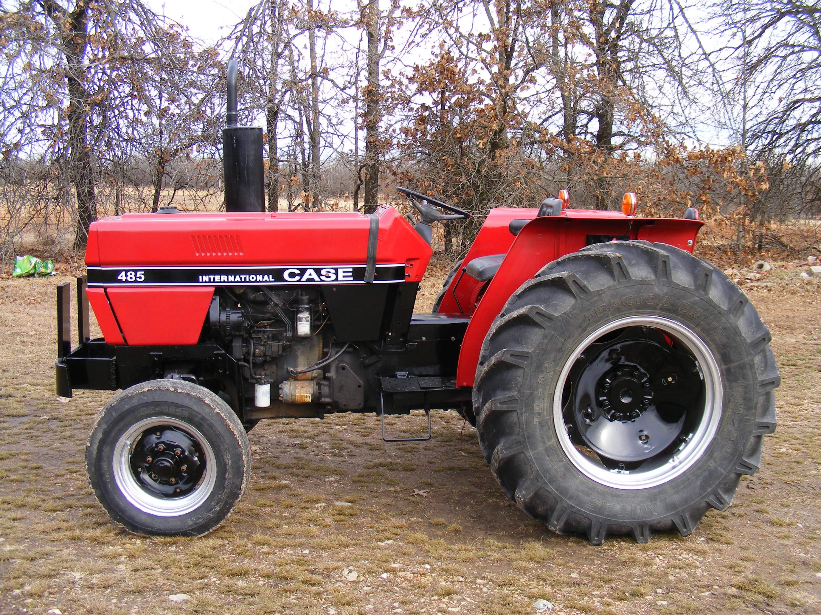

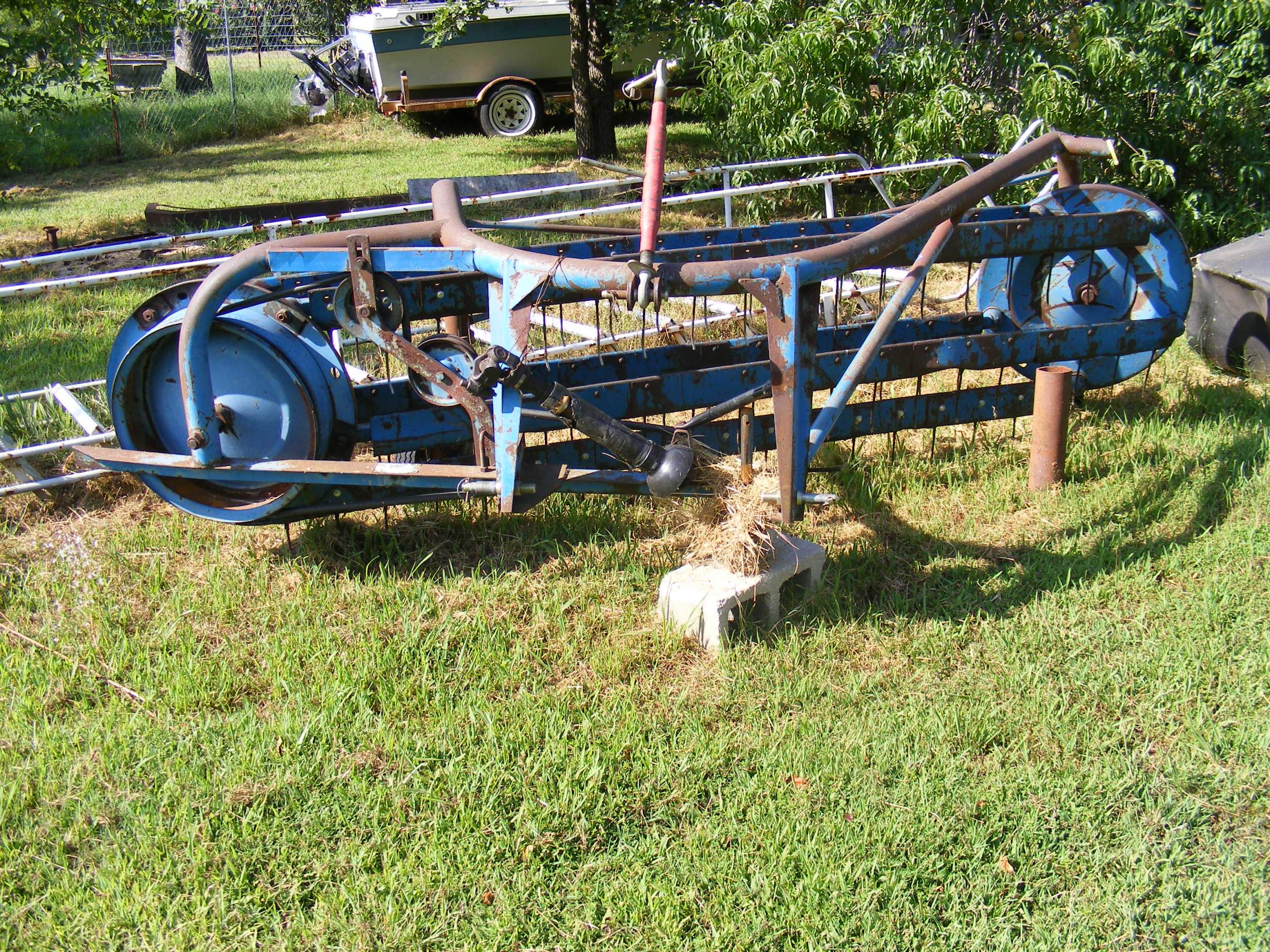

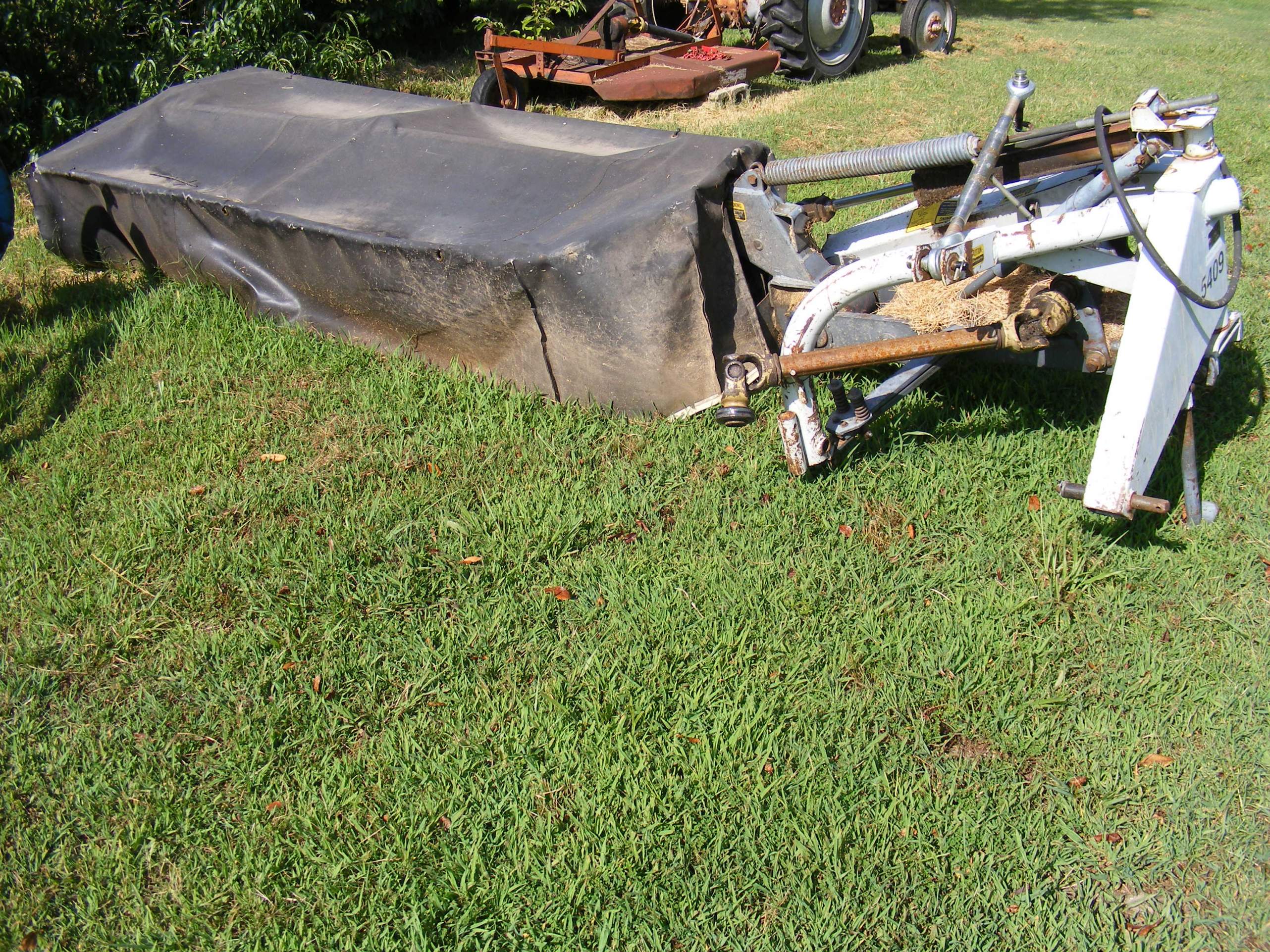

I bale with a JD 337 twine baler, New Idea 9' disc mower, Ford 3-pt side delivery rake, and a Case IH 485 tractor (43 PTO hp). I baled around 2,700 bales last year. The most money i made was doing custom baling jobs. All i had to do was cut, rake, & bale. That made it easy money. I bale all grass hay though. And i can see where alfalfa could run up costs quite a bit. Right now the only costs i have are diesel, twine, oil, etc. I don't fertilize or spray for weeds as the fields i bale are pretty weed free on their own. I am still considering getting out of square baling and switching to round baling though. That way i could get more custom baling jobs. It would be a lot easier on me since i don't have a good place to store the hay anymore or an automated handling system.
Forgot to mention, i have just under $10,000 invested in all the equipment i have. The only weak link i have is the rake. If i modified it to be a standard pull rake instead of a 3-pt mounted, i could very comfortably do 10,000 bales a year. If you are willing to put a little bit of work into your equipment before season, you can pick up some great deals. You just have to be at the right place at the right time.
