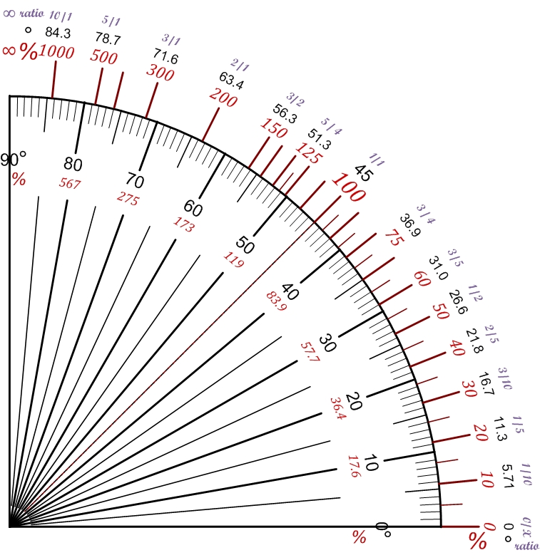

I just went out and checked some of my trouble spots. It seems (according to a cheap RV type level) that my troubles start at about 15 degrees. At this point loader work up hill becomes sketchy with the backhoe on. At about 20 degrees I start to lose steering when tramming up hill.
I embedded a chart of slope degrees overlaying slope in %. Your 20 degrees is getting fairly steep (around a 37% slope.) I routinely mow 40% slopes on a WV farm but a 50% slope (around 26 degrees) is about my limit under the best of conditions. And I'm not having a backhoe on for the ride. A bush hog (my normal mode) does hang out a ways and provides a lot of rearward tilting unless the hog is riding on the ground.
