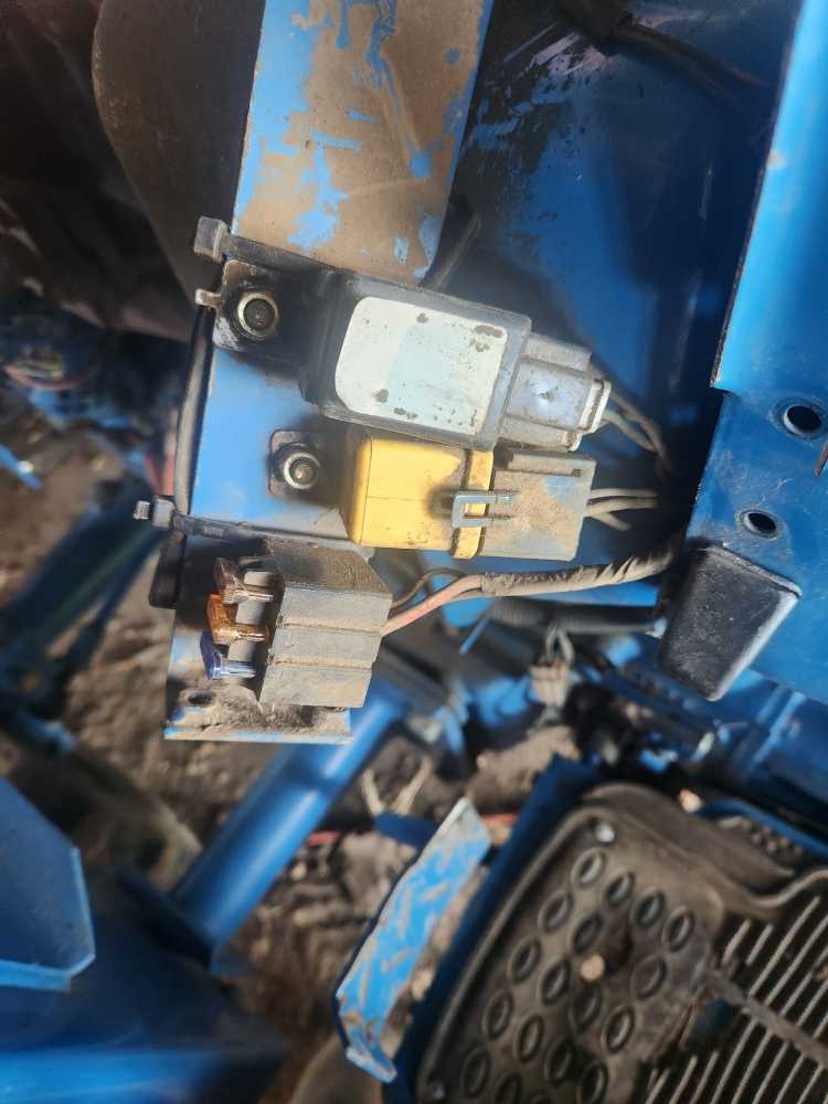

Also, while I have your undivided attention, can you tell me what these relays or flashers, or whatever these boxes are (besides the fuses)? Thanks again.

Right, I had the wrong description (deleted post) for a 1715. The relays are flasher and safety (neutral start) relays. No timer.
It does have the old style glow plug circuit and is very straight forward. Ignition to glow plug coil to glow plugs.
