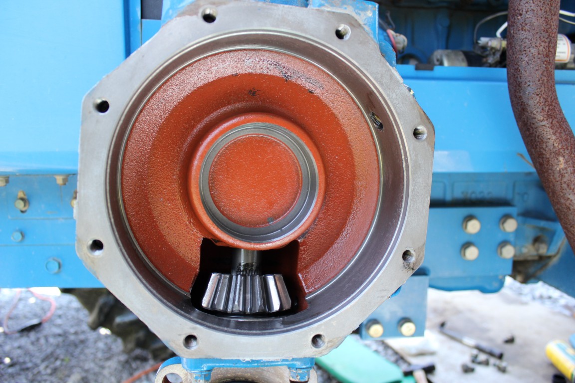

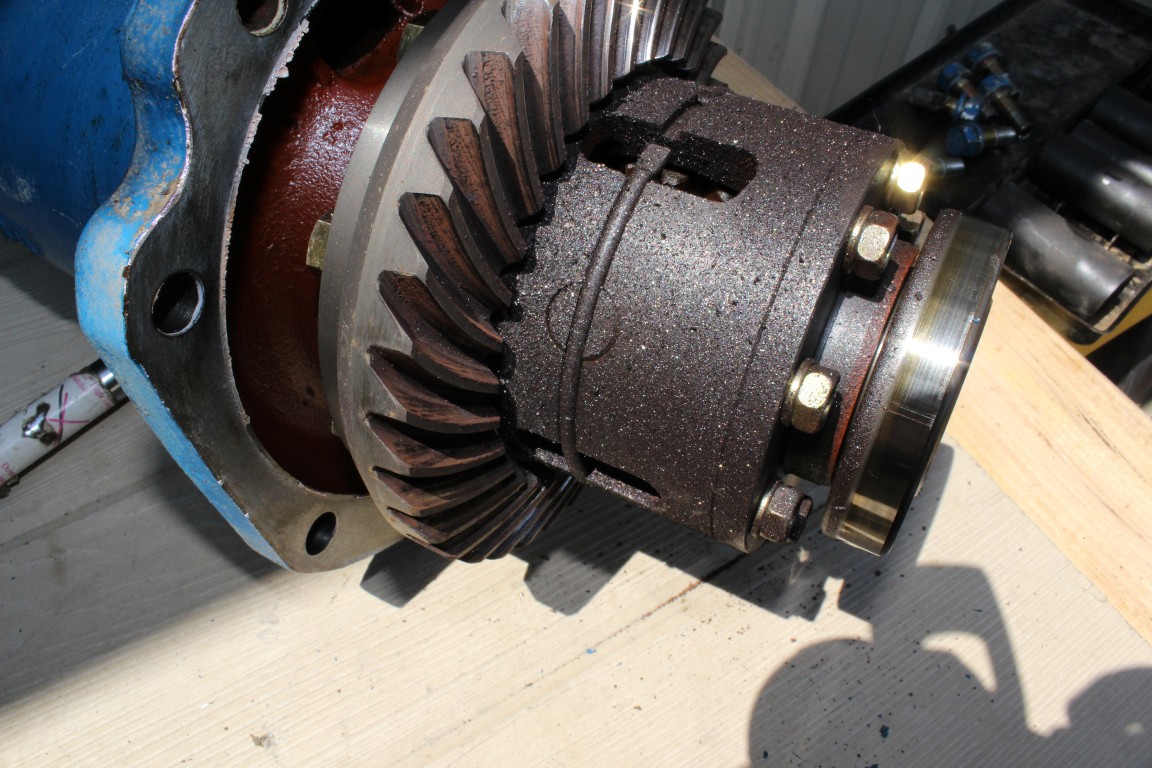

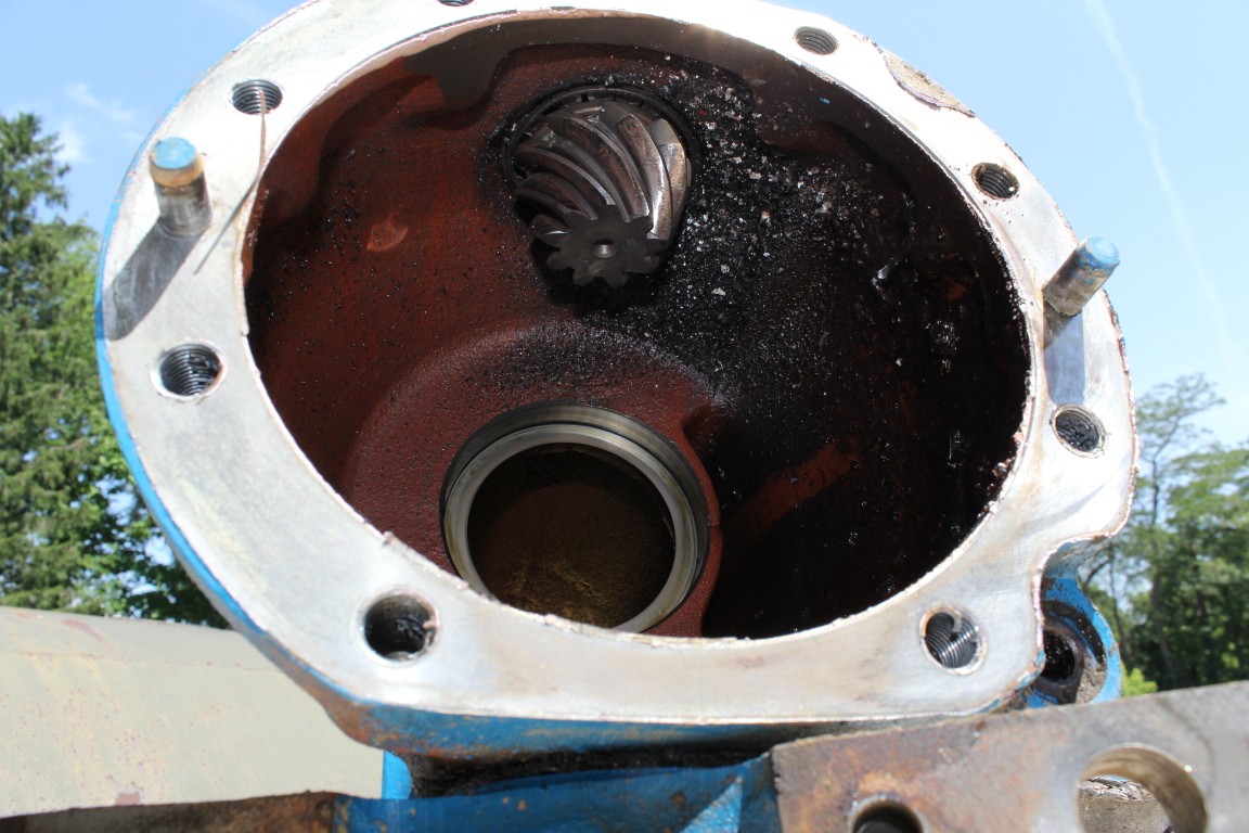

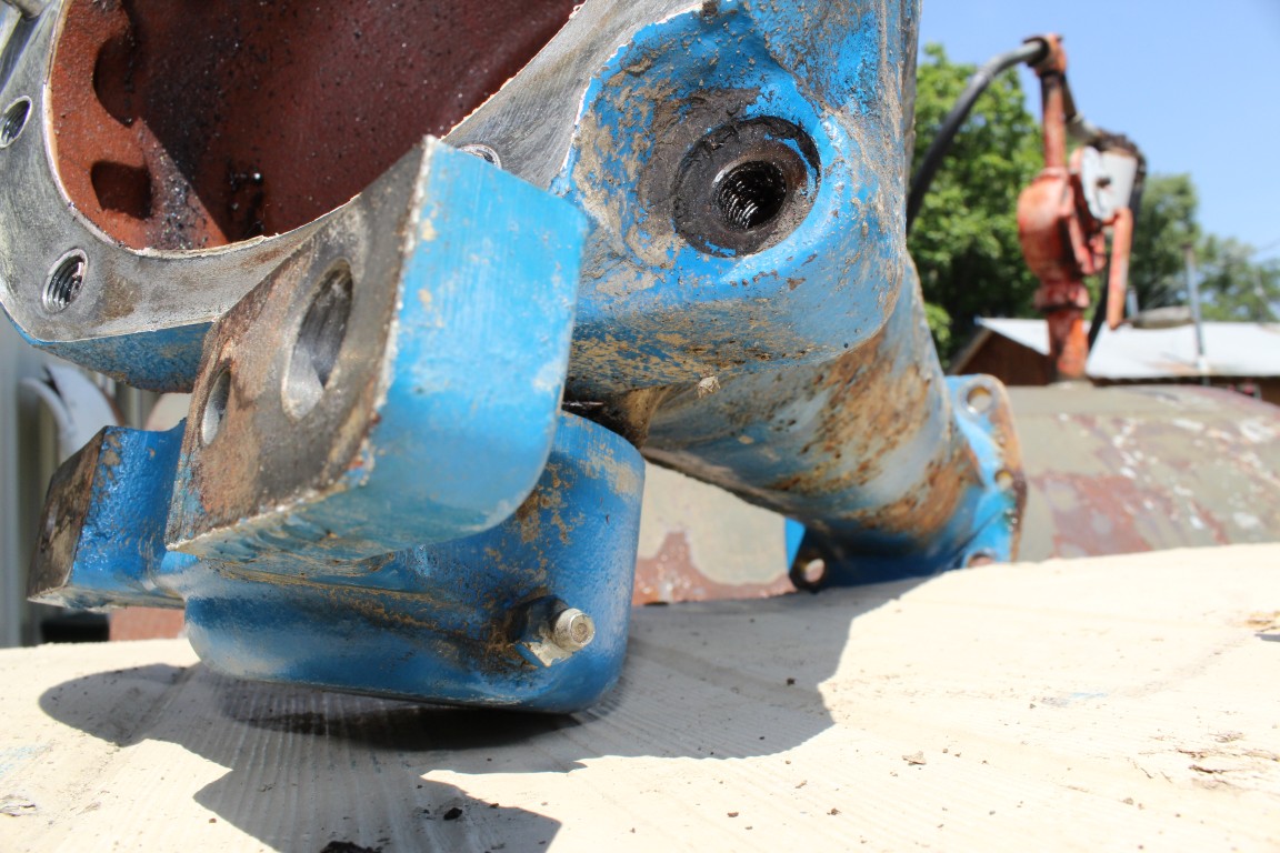

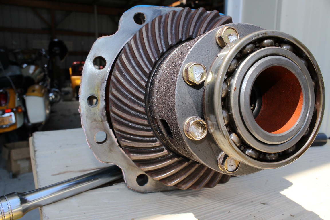

#18
The verdict is in: Owner neglect! :smiley_aafz: This tractor was an inheritance from my step-father and since it got little use, I never checked everything out after taking possession of it. Me, the great mechanic that can fix ANYTHING neglected the basics of owning a fine piece of machinery. Ah well, here's what I found. Outer wheel hubs were full of oil and when I opened them, they looked fine. Once I got the front axle onto the bench and opened it, I found that the ring and pinion gears had run dry...yes..DRY! The drain plug was missing..no clue for how long, except long enough. At the very least it's going to need new ring and pinion gears and associated bearings.
