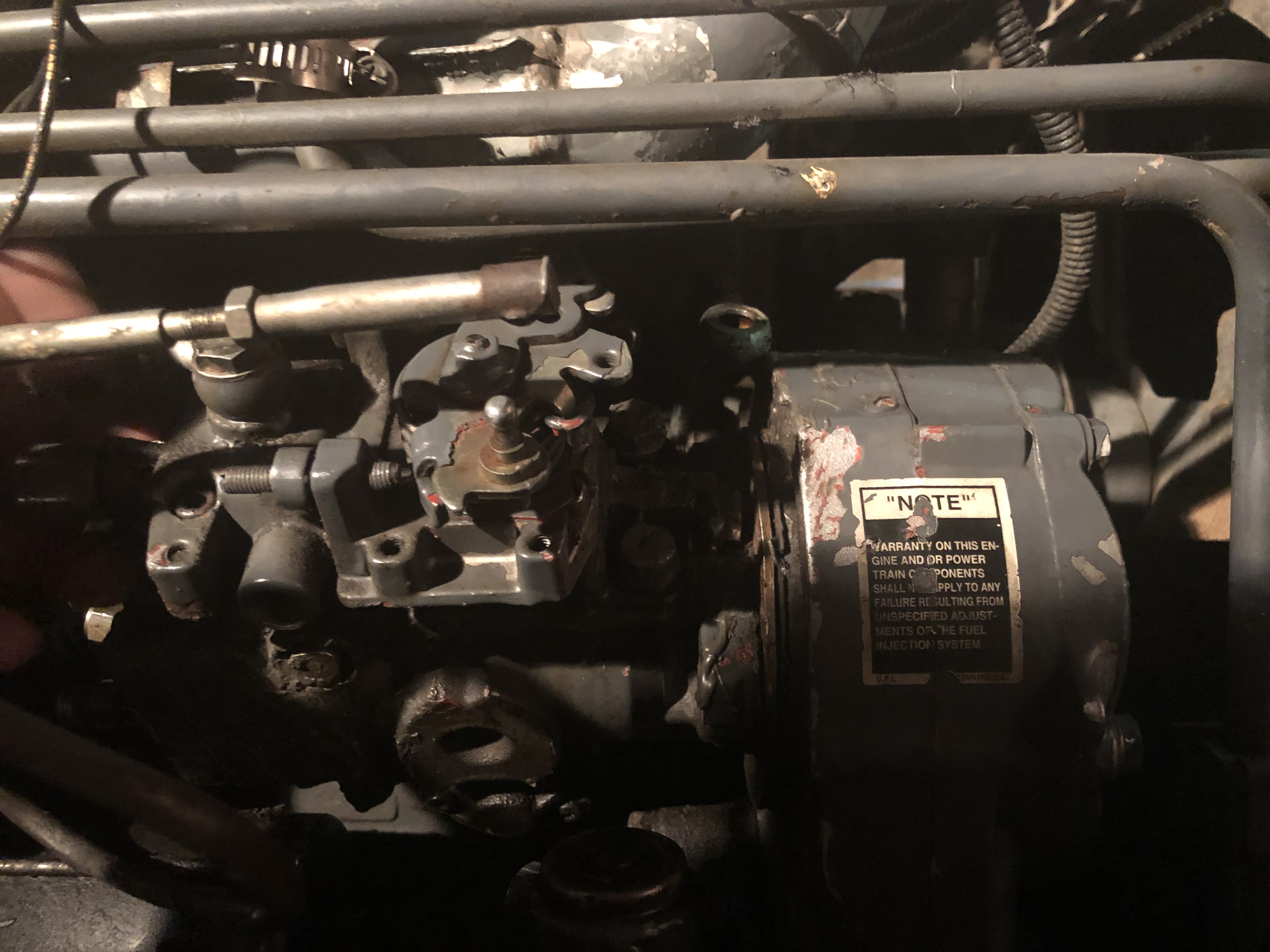

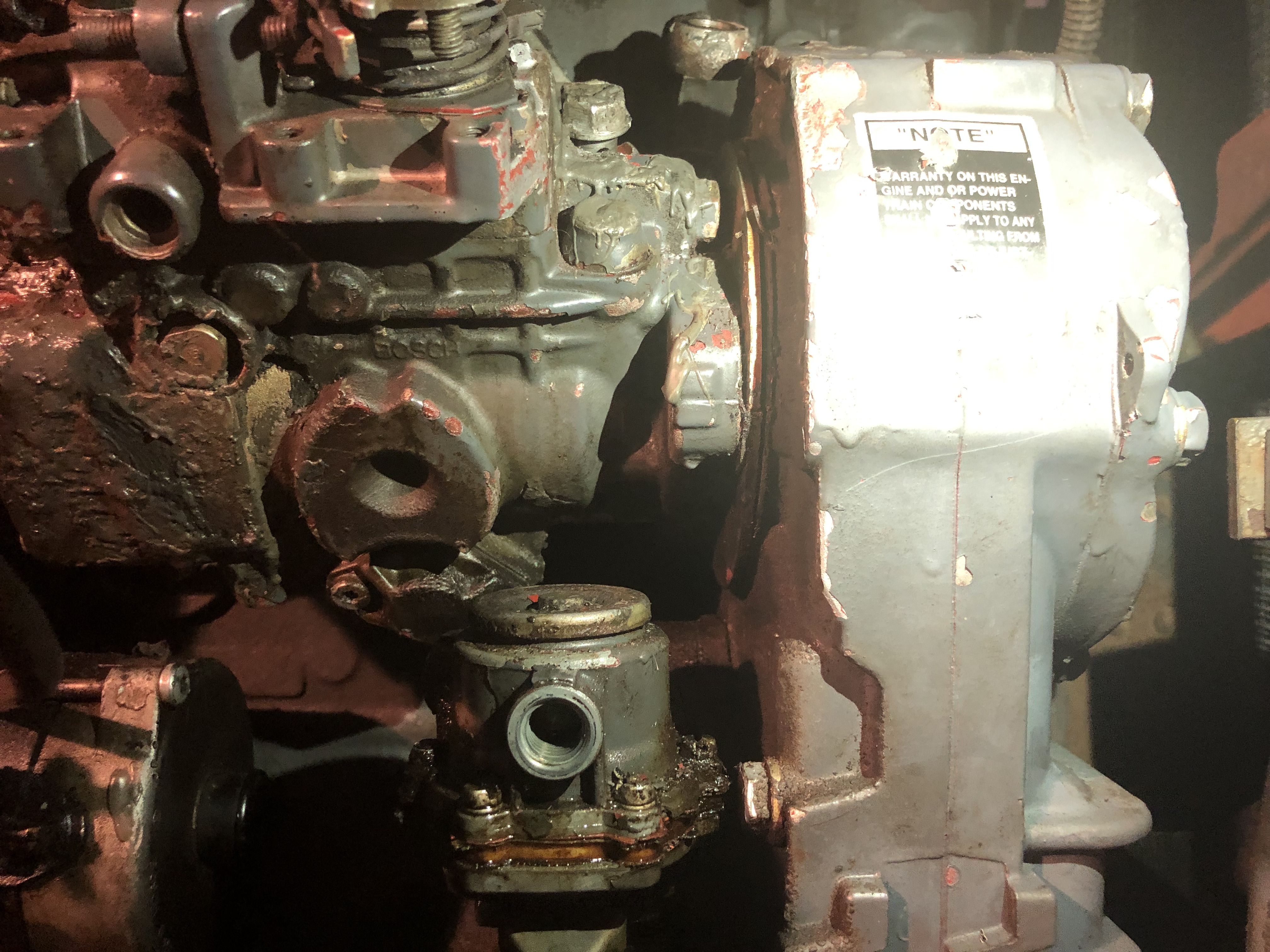

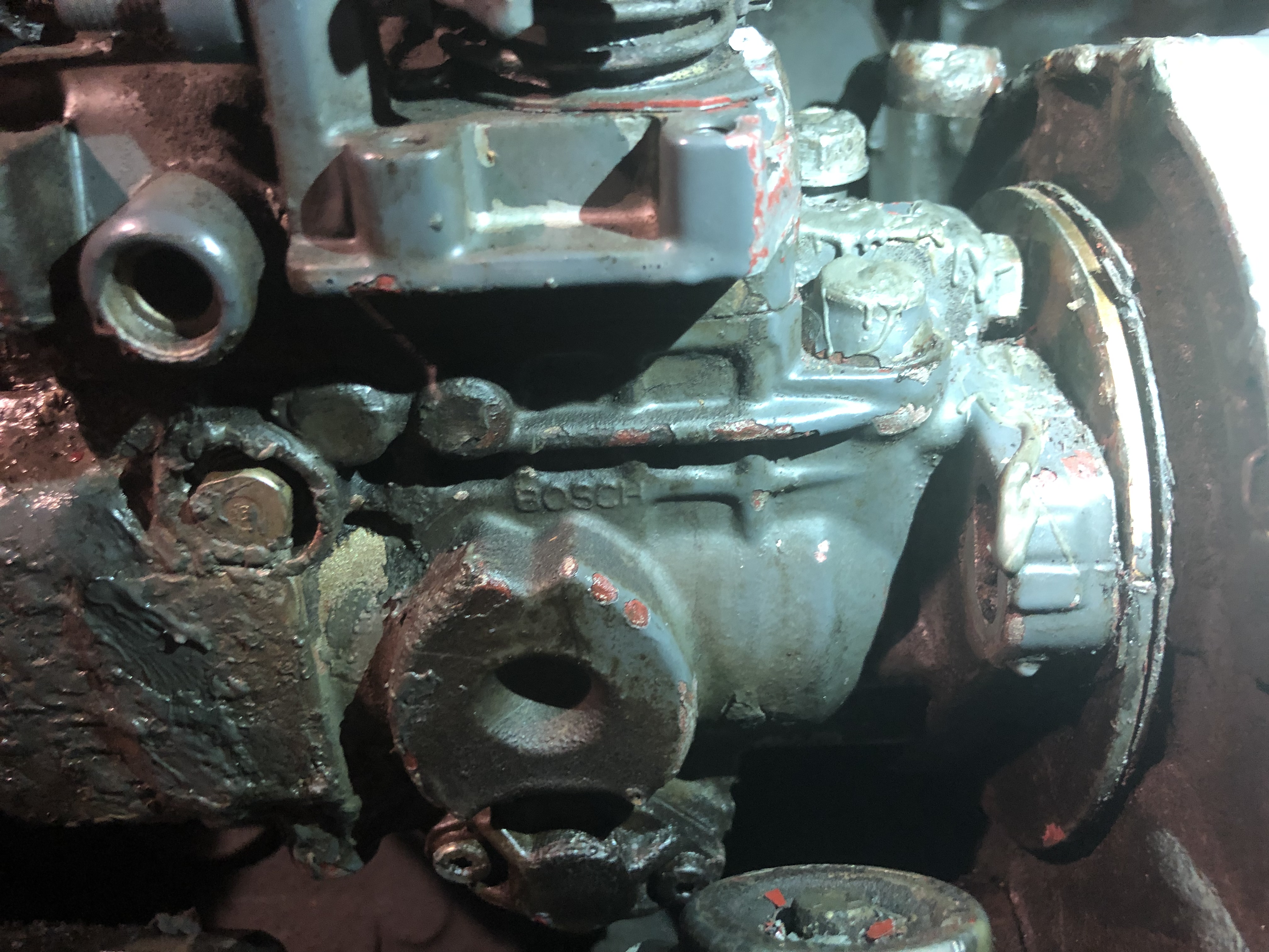

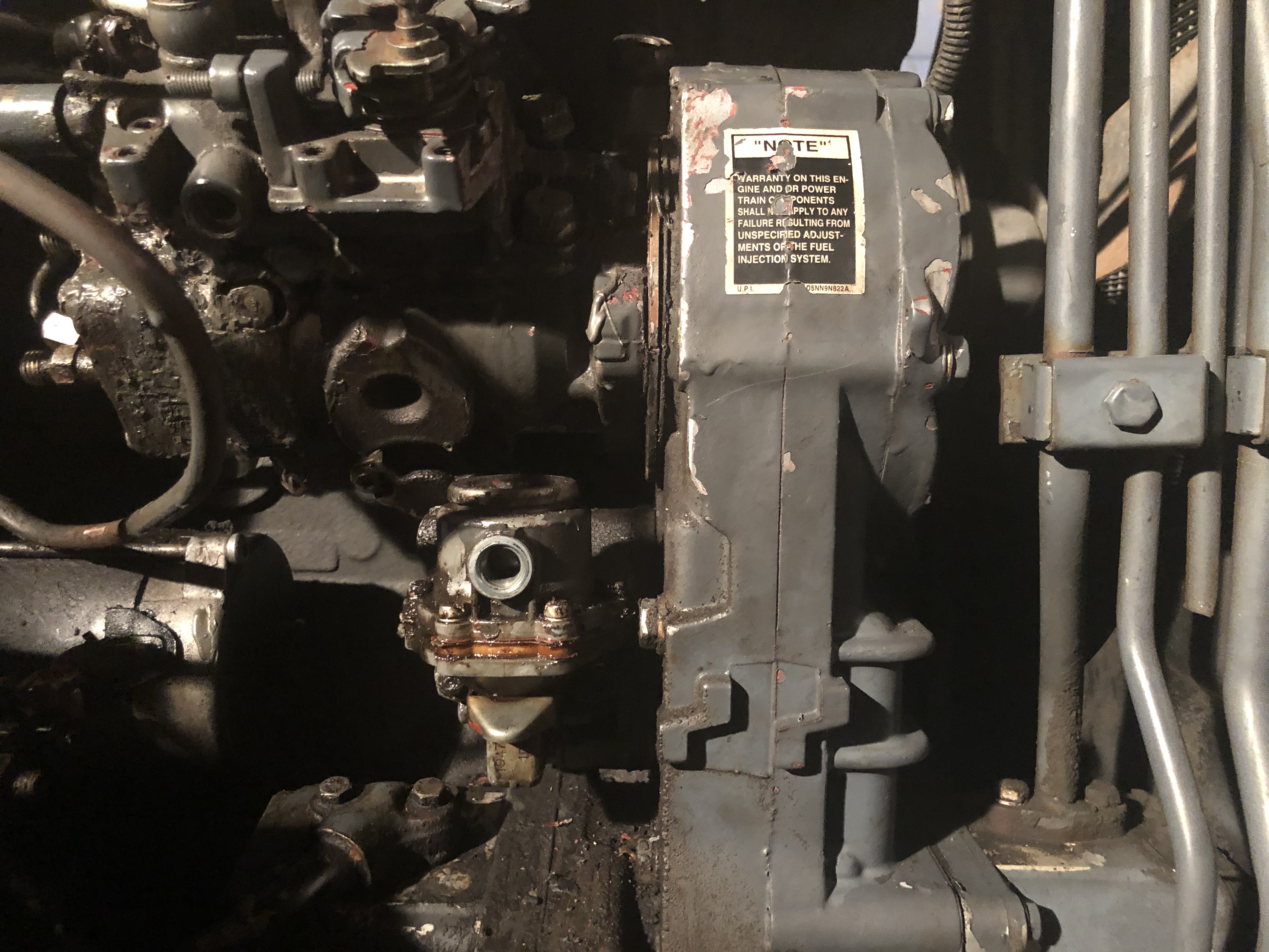

623BD0F7-CFE5-4BA0-893E-24EA288633E8.jpegCD3C43A8-0BB9-4DEC-A264-61E4AB846899.jpeg73485616-9042-410A-9122-332EFE3C132B.jpeg7836E2B8-ED17-4229-8BC5-C42603BC1FFB.jpegHey guys, I am trying to remove the fuel injection pump on my new holland 3010, but having a hard time. Ive got all the bolts removed and hoses disconnected. Am I missing something? Anyone have any tips or advice? I cannot seem to find the shop manual anywhere and my local dealer has not been super helpful.
Also any particular timing marks I should be looking for? Thanks in advance.

The orig. question was how to remove..
I can see from your orig. pics. that u havent removed the front cover infront of the inj, pump..
Under that cover, you'll see a large nut & washer that connects the inj. pump to the drive gear..
You'll need a puller to pop the gear off..
FYI> the inj. pump to engine timing is critical.. so u need to read up before pulling the pump..
Glad u fixed the problem.
