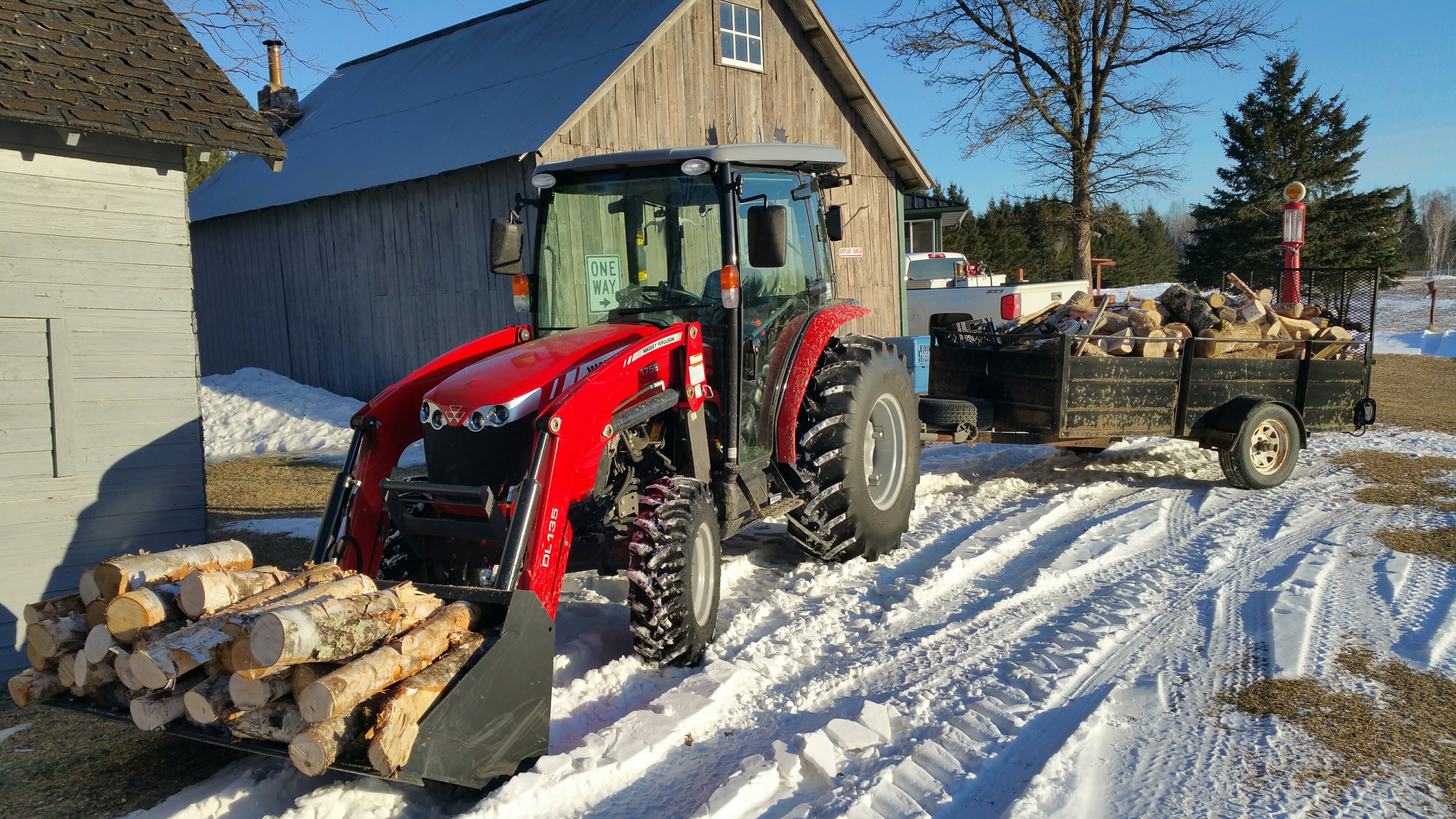

Today's job with Massey at a cool 5F temp. 5 miles away on federal firewood permit. Black ash and birch. Love my Massey.
