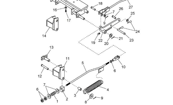

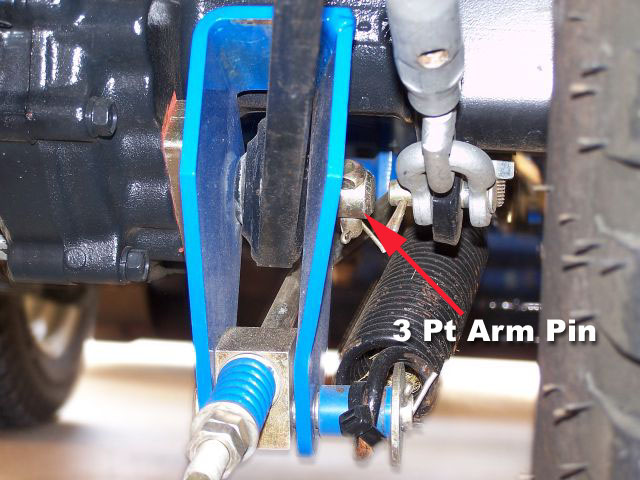

I just purchased a used 914A MMM for my TC18. It came complete with all mounting hardware except the replacement 3-Point Arm Pins (Part # AUB164232). Unfortunately the seller sold the tractor and the pins went with it so I am in need of two replacement pins. Dealer price is over $120 for per pin.
Can someone give me the length of the pins from the outside of the flat bar to the center of the hole for the retaining pin so that I can fabricate my own pins. Or if someone happens to have a pair of pins they would like to sell, please PM me. Any help would be appreciated.
Here is a photo of the right side pin. I found this photo here on TBN in a previous post.
attachment.php
The part I am looking for is #13.

OK..............it appears that the flange is 3/8 thick. The length from the outside of the flange to tip is 3 1/2". The hole, from the outside of the flange to hole center is about 3 1/8" to 3 3/16"
