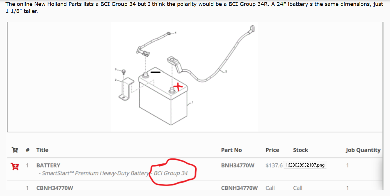

Since OP did not update this thread and I just got done replacing the battery in this same tractor I thought I would update. So sorry of reopening an old thread.
The manual calls for a Group 85 battery. I could not find one in stock locally. So I went with a 24F. It will fit, but it too tall. The battery compartment is big enough the L&W are not an issue.
Height is an issue in that the clamp that holds th battery in place will no longer fit. So the solution is I need a longer bolt to hold that clamp in place. Not that big of a deal to fix, but something to know.
Also replacing this battery is a pain in the .... there are about 12 bolts you need to remove to get all the brackets and things out of the way to remove the battery. Took about an hour and change to do with not much screwing around time.
Specs call for 550 CCA or so, I put in this battery https://www.napaonline.com/en/p/BAT8424F?impressionRank=1
It has 750 CCA. Tractor fires up like it was new.
I wanted to update this thread as it is the first google hit when you are trying to figure out how to replace the battery on this tractor.

Getting a BCI 34R would have probably bolted right in.
