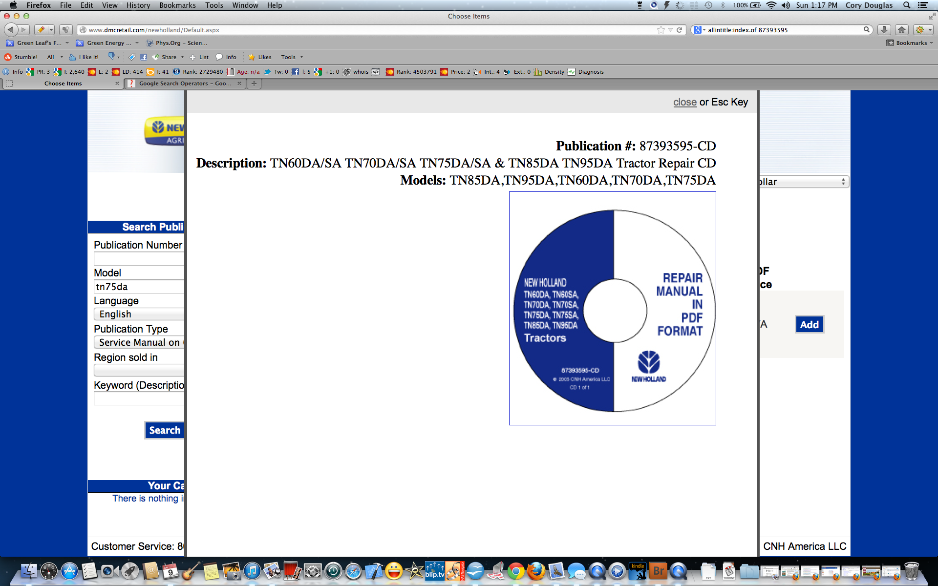

Ok Rick B you seem to be rather knowledgeable about the error codes given off by New Holland equipment. I just need one question answered by you-- if I but thus factory CD Screen Shot 2013-06-09 at 1.17.32 PM.png will it spell out what the codes my tractor is given off to me so that I can fix it?
Furthermore in case you are wondering what I am referring to, here is the link to where you can buy the CD from:New Holland Service Manual CD

The error codes and troubleshooting flow charts are in the transmission section.
Supersteer fault codes and related info is in the front axle section.

For an engineer your reading comprehension sucks. The fault codes and related information are in the sections I referenced. Be certain that the service manual you buy is intended for your specific tractor model, including any serial number ranges that may be indicated. Others may be close, but not exact. Purchasing the service manual will not guarantee success in all diagnosis and component adjustment if you do not have access to proprietary diagnostic hardware and software. Having the complete service manual will, however, be worth the price for someone with the skills to read and understand it.
