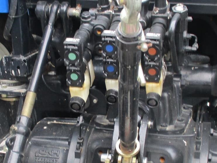

I don't know what these white reservoirs under the hydraulic connections are and can't find anything about them in the manual. (New Holland TS6.120)
What are they?
Thanks.
   / New Holland Hydraulic Question (Newbie) #3
Ditto what Rick stated. The reservoirs are designed to save the soil/water from contamination by oil leakage. I've always wondered what saves the soil/water from petroleum contamination when asphalt is applied for roads.
   / New Holland Hydraulic Question (Newbie) #4
I can only add do not put the oil back into your hydraulic sump, it will/could be contaminated/dirty.
