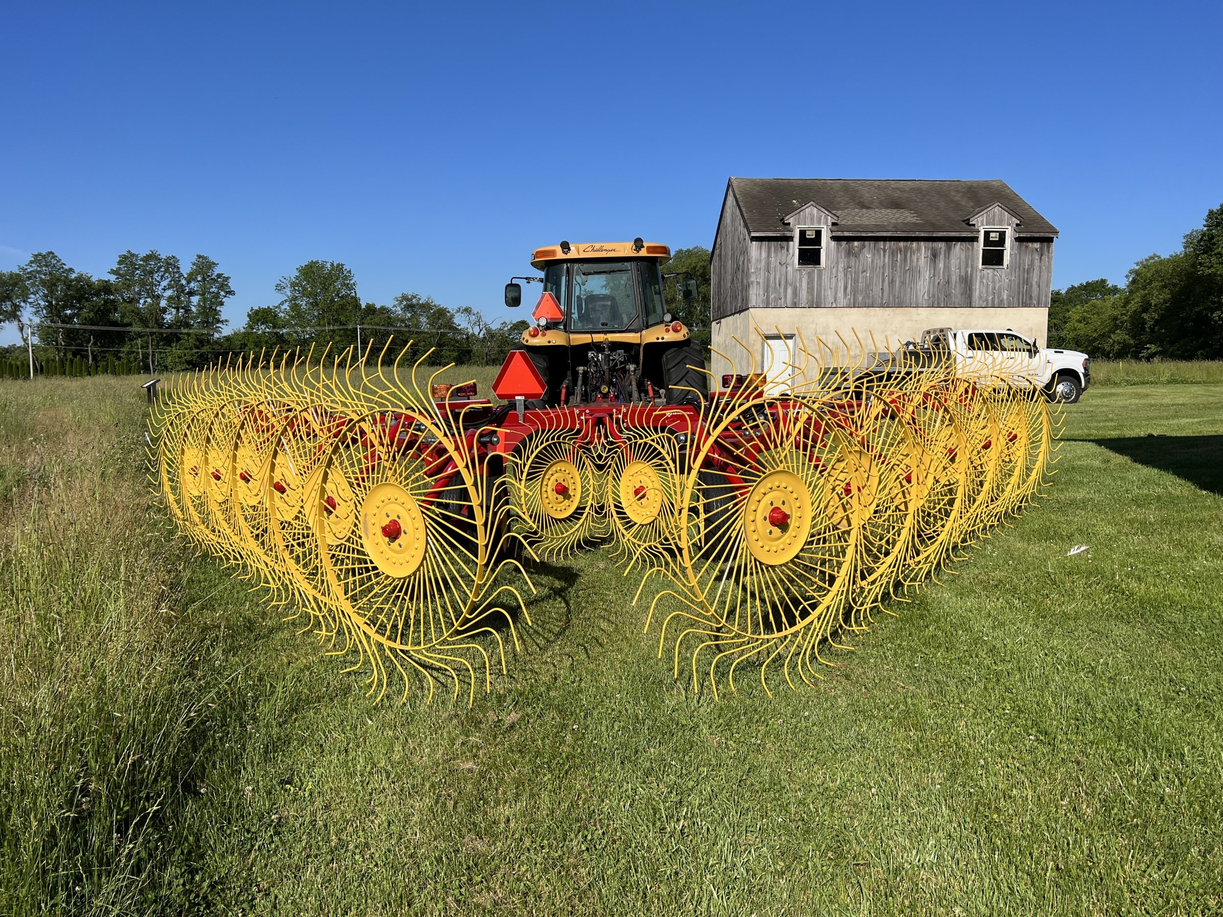

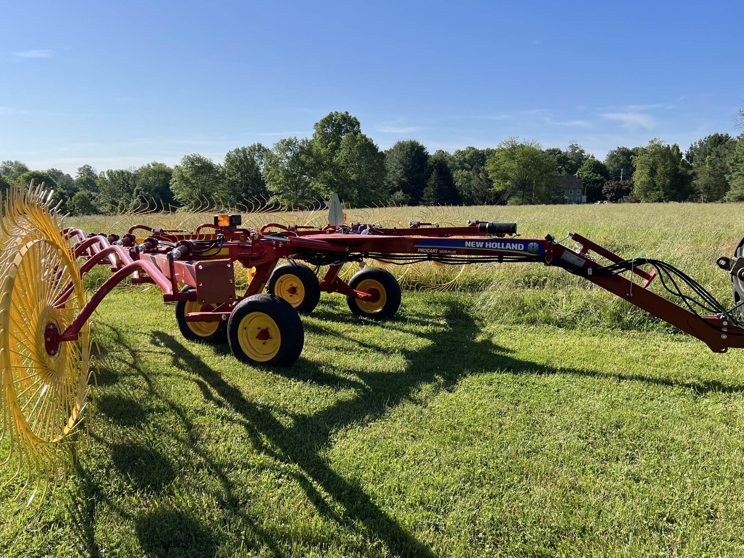

Just got delivered late this afternoon.
Here’s some pics

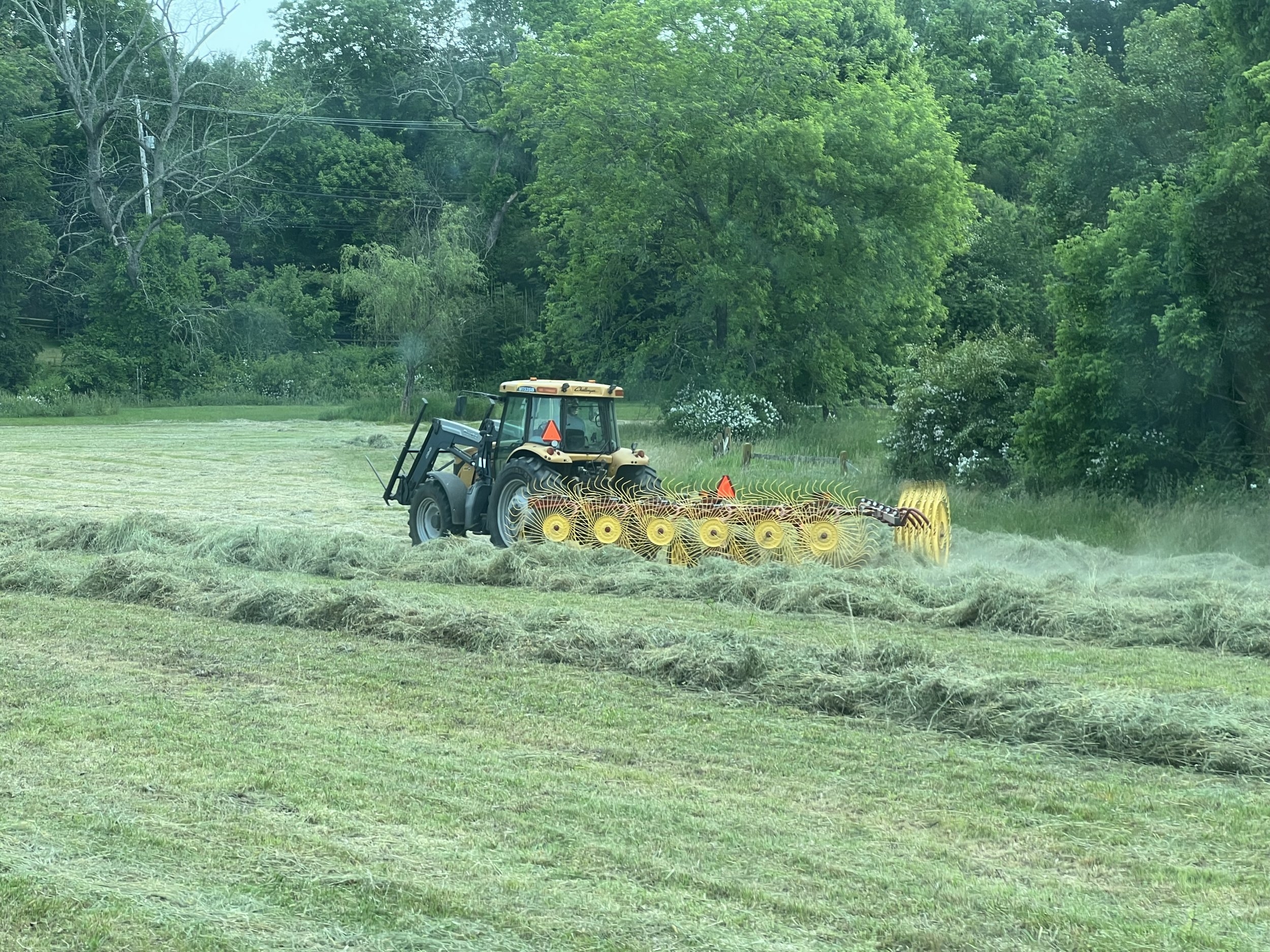

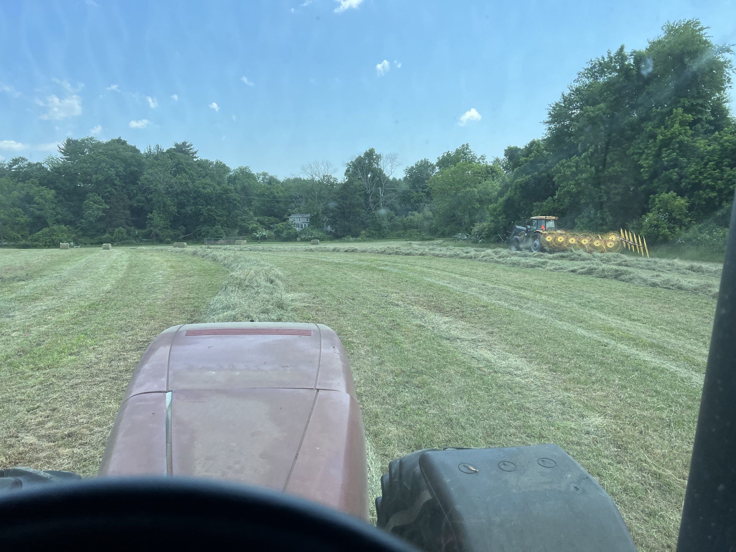

Here’s a few pics of the rake in action. It is amazing how each wheel independently floats over bumps. Also, the tandem axles walk very nicely over bumps since the tires are larger diameter than single rotary rake we were using. Picks up (2) 10’ windrows very nicely. If you want to extend the arms wider, you can, hydraulically from the cab and it’ll grab even more hay.
2 windrows is perfect for me if we don’t have to tedder.
The rake folds up very narrow and secure, just a little wider than the tractor. Goes down the road great.
We are happy with it (so far), but too early to tell.
