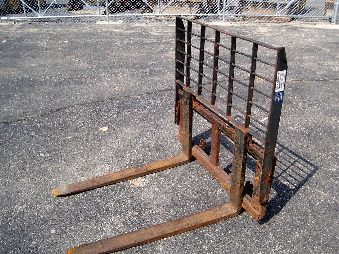

Tommorow I'm going to drive a fair ways to get these,...New Holland Forks
The man says they are older off of New Holland, Was there a difference in the QA on this or is it the same as my Kubota QA? Any input would be appreciated.

I have the universal type, I'm just not sure about the N/H forks. They look like(from the poor pics) they have the v channel on top but the bottom looks like pin on. I was hoping someone would recognize them and atleast let me know if at worst I could modify them.
I might try anyways for $100.00 and maybe the same in welding it could be worth it.

silverking,
They are NH forks but that style is what many call the 'NH old style' quick attach. They were probably used on a NH L?85 skid steer in the early 90's. Your Kubota is different. Get them at that price and modify to fit your tractor. It shouldn't take much.
This picture might help.

Thanks, do you know offhand if the upper v-channel is right, if so I would just need to remove the lower pin receivers and weld on lower tabs.

You can't even buy just forks for that price. Buy it.
   / New Holland QA same as Kubota? #8
You can get weld on plates from eBay for around $115 delivered. I would pick up the forks and weld on one of the eBay plates. You will still be ahead $$$. The cheapest q/a forks new are around $600.
