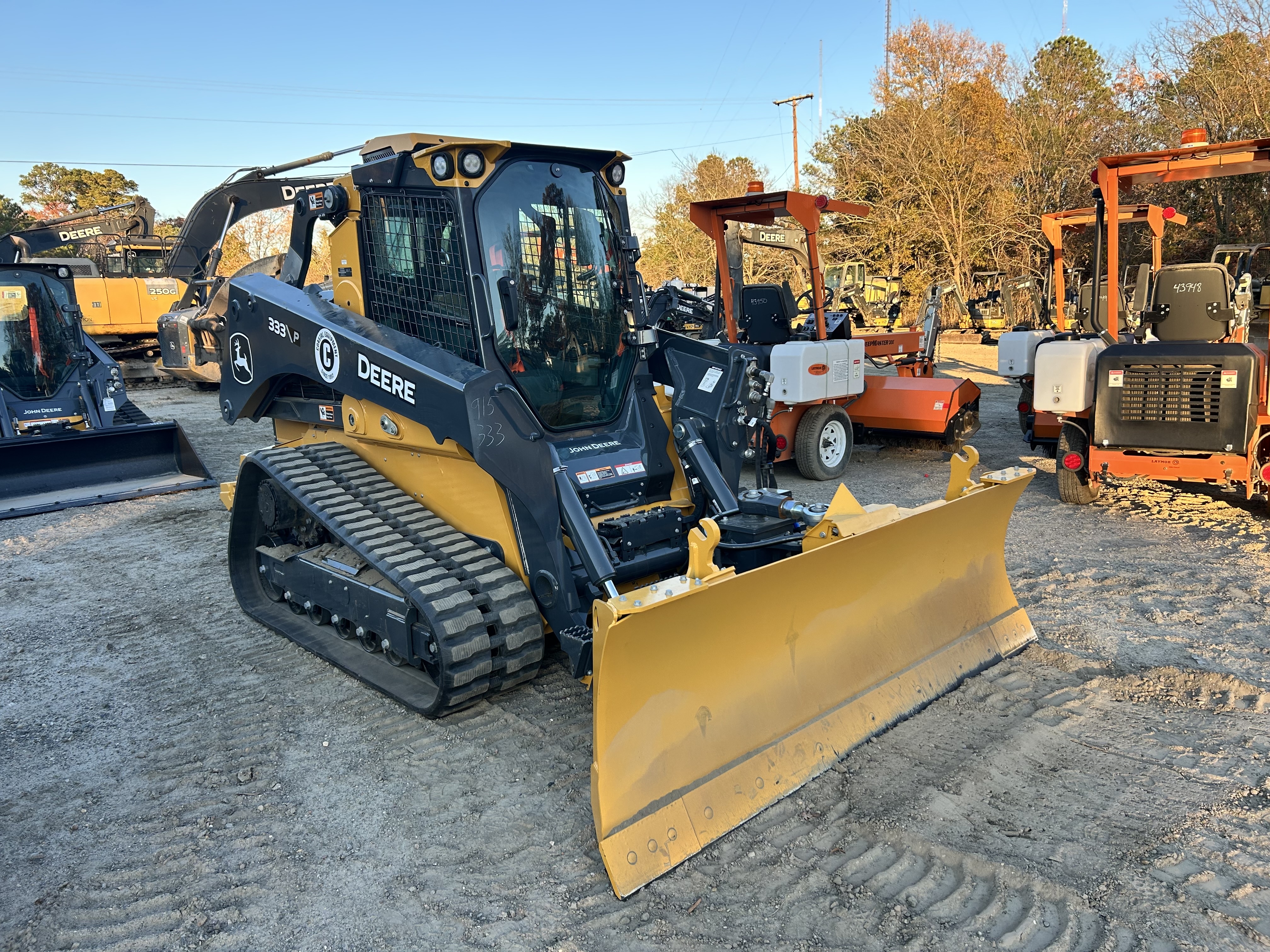

I will also spam this thread with a new machine because who doesn’t like new machines? Deere 333p with smart grade
