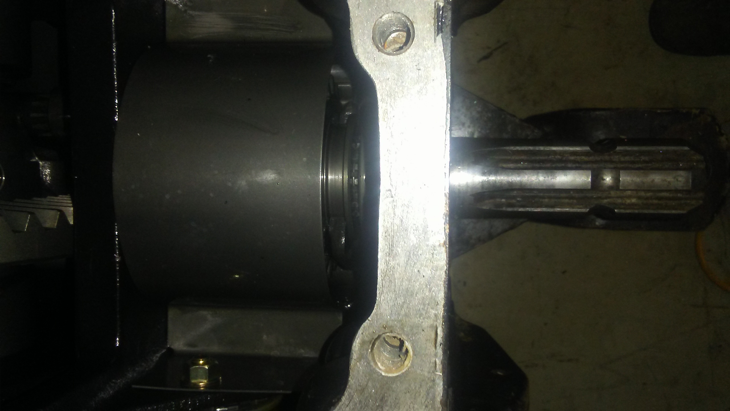

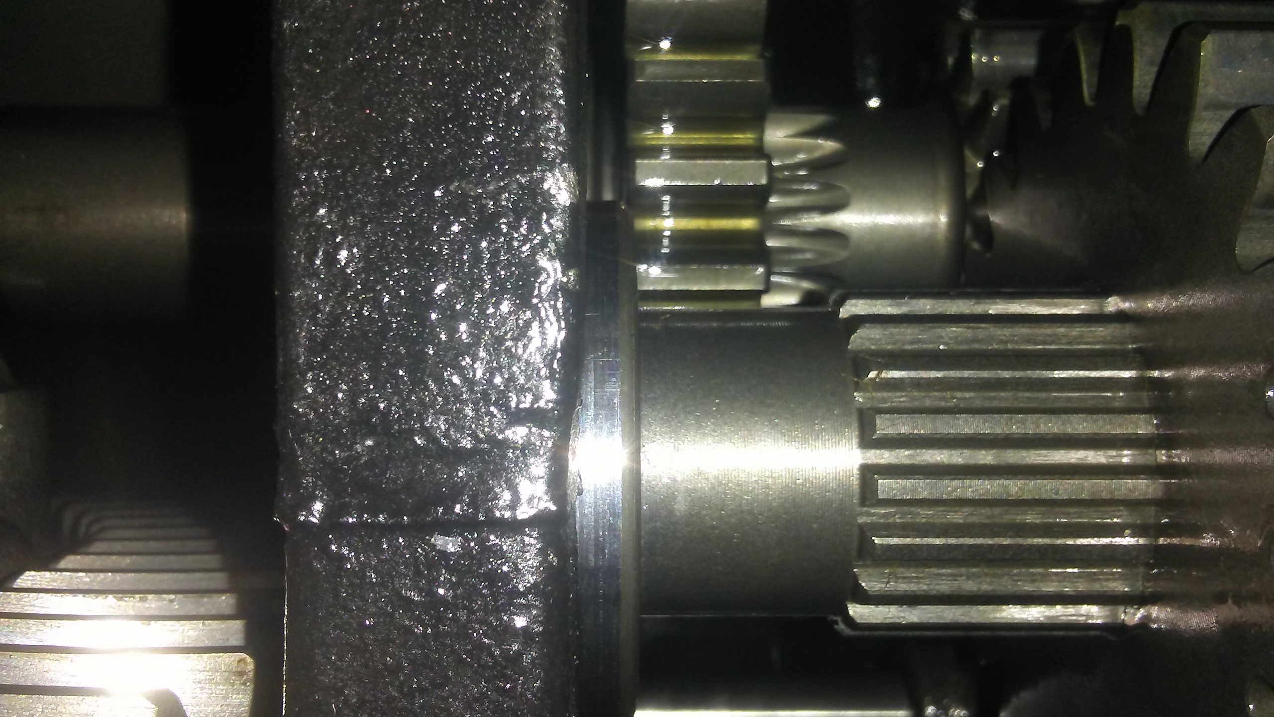

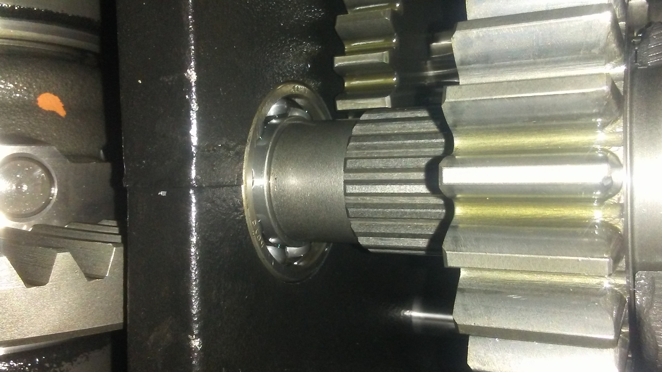

OK, I have the 3 point lift housing removed to the point where I can look inside to where the bearing is. Am attaching a couple of photos.
When I pull on the end of the shaft, it moves about half an inch. There is a cover over the bearing that I have not removed. Not sure if it will need to be.
I was told by the mechanic at the New Holland dealer that when the shaft is removed, there is a gear that will fall out.
Editing this post.
Removed the cover over the bearing. Am attaching another photo.
When I pull on the shaft, the bearing toward the front of the tractor is hitting up against the gear on the shaft below. If I can get the bearing in the front removed, it seems as though the shaft should come out. I think the mechanic at the dealer said he taps off the bearing in the front, though I did not ask exactly how this was done.
The gear before the bearing towards the front of the shaft must be the one that comes off when the shaft is removed.

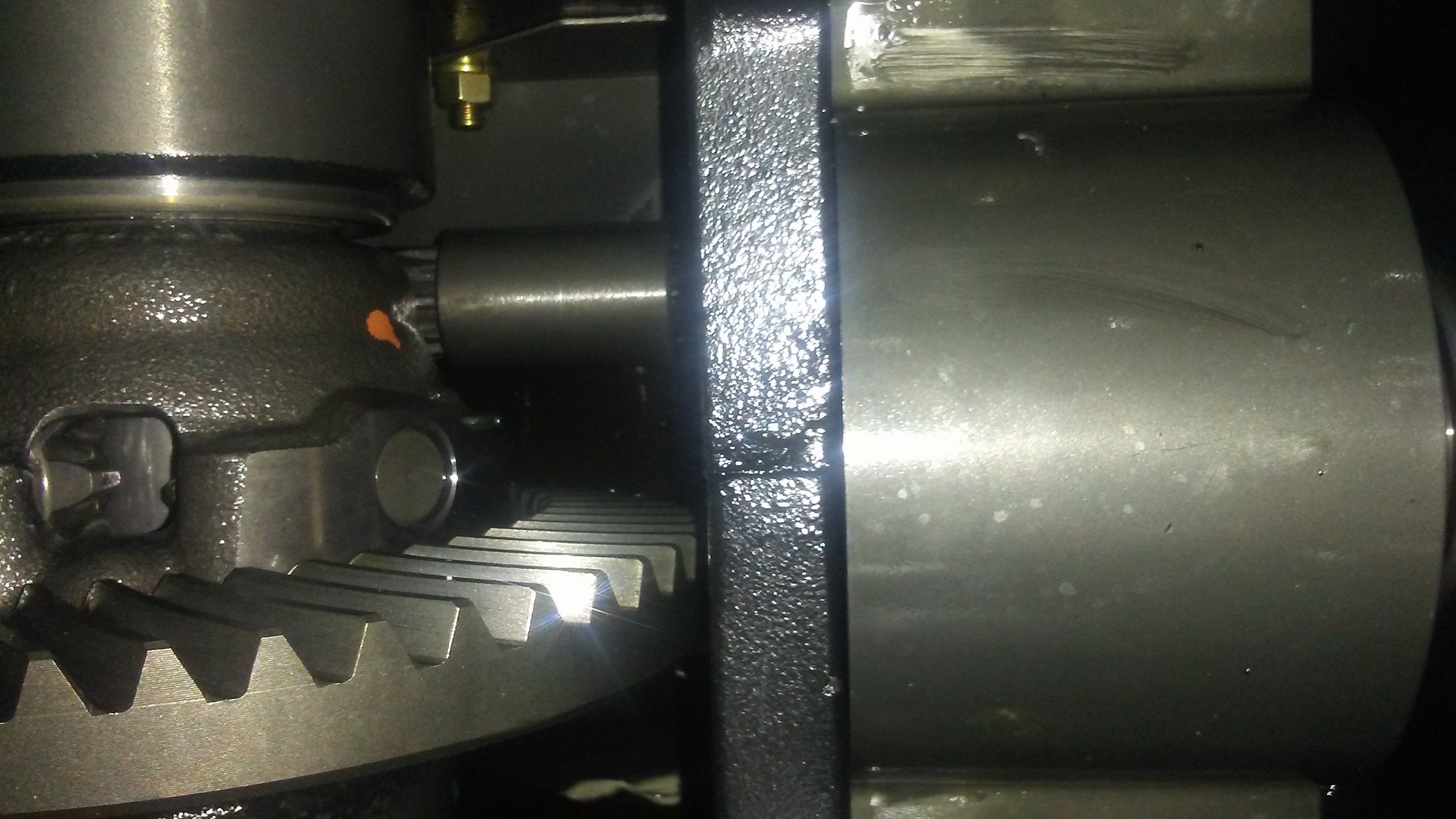

Wondering if anyone has any thoughts about how to remove the bearing that is on the end of the shaft. Am attaching a photo that shows the bearing and the housing.
Edit:
I found part of a TC 30 repair manual that could be purchased and downloaded online. Am attaching the page that describes how to remove the PTO shaft. It says to drive the shaft out the rear of the tractor. It doesn't mention anything about the bearing towards the front hitting the gear on the shaft below it though.
Any help on this appreciated. Have tried to drive the shaft out the back of the tractor, though am worried to use to much force. The bearing on the front of the shaft hits up against the gear below, and the shaft has not moved at all. It seems as though something is not right. Not sure what the gear below the shaft is for. It does not mesh with anything that I can tell.

Does the bottom gear slide? If it would, it might allow you to slide the bottom gear forward just enough to the bear come off and then maybe you can work the shaft around the bearing.
Unless you can keep the bearing in the casting but it seems quite a tight press fit on the shaft.

The lower gear is fixed on splined shaft that has some taper. It nay be able to be moved forward a bit, but then would hit the casting.
There is 1/2 inch or less of play in the PTO shaft, so the bearing comes out of the casting a bit, but then it hits the gear below. I have tried to (without using too much force) drive the bearing forward off the shaft by using a spacer to hold the shaft back from the lip that is on the forward side of the casting, and also tried driving the shaft back as it says to do in the repair manual, but have not been able to get it to move. When I have tried driving the shaft towards the back of the tractor like the manual says to do, the bearing hits on a couple of the teeth of the gear. Not sure how strong those teeth are, or what the gear does, but sure do not want to break something.
I have thought of trying to use a C clamp to keep the bearing in the casting, and then try driving the shaft out. May try this today.
