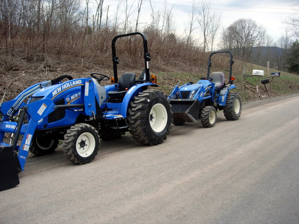

I had a TC26DA for 15 years and traded it in last spring on a new Workmaster 40. The dealers around here don't really carry the Boomer line except in the cab models. Your TC40DA is likely set up much like my TC26DA, and as such is a much more refined tractor than the Workmaster 40. The Shibuara engine was no problem but I did have a problem with a cracked transmission case that cost me like $4000 to fix. I am told the the current tractor is built heavier, and I hope that's the case.
I can't comment on the engine longevity with 70 or so hours on it, but it seems ok so far. If I live long enough, I might be more versed in the overall quality of the machine when it has five or six hundred hours on it. The TC series is definitely more ergonomic, I will say that much, not that there is anything wrong with the workmaster, just some things are less convenient. The ignition switch on the TC26DA was in a weird place that my knee used to hit. The workmaster's is more off to the side and out of the way. The seatbelt doesn't retract and I thought that was a good thing, but it's just as annoying to get on as the TC one was. Your TC40 is a nice machine, and if I had bought a little bigger in 2006, and had the three ranges, I might still have had it. Time will tell on these LS machines.

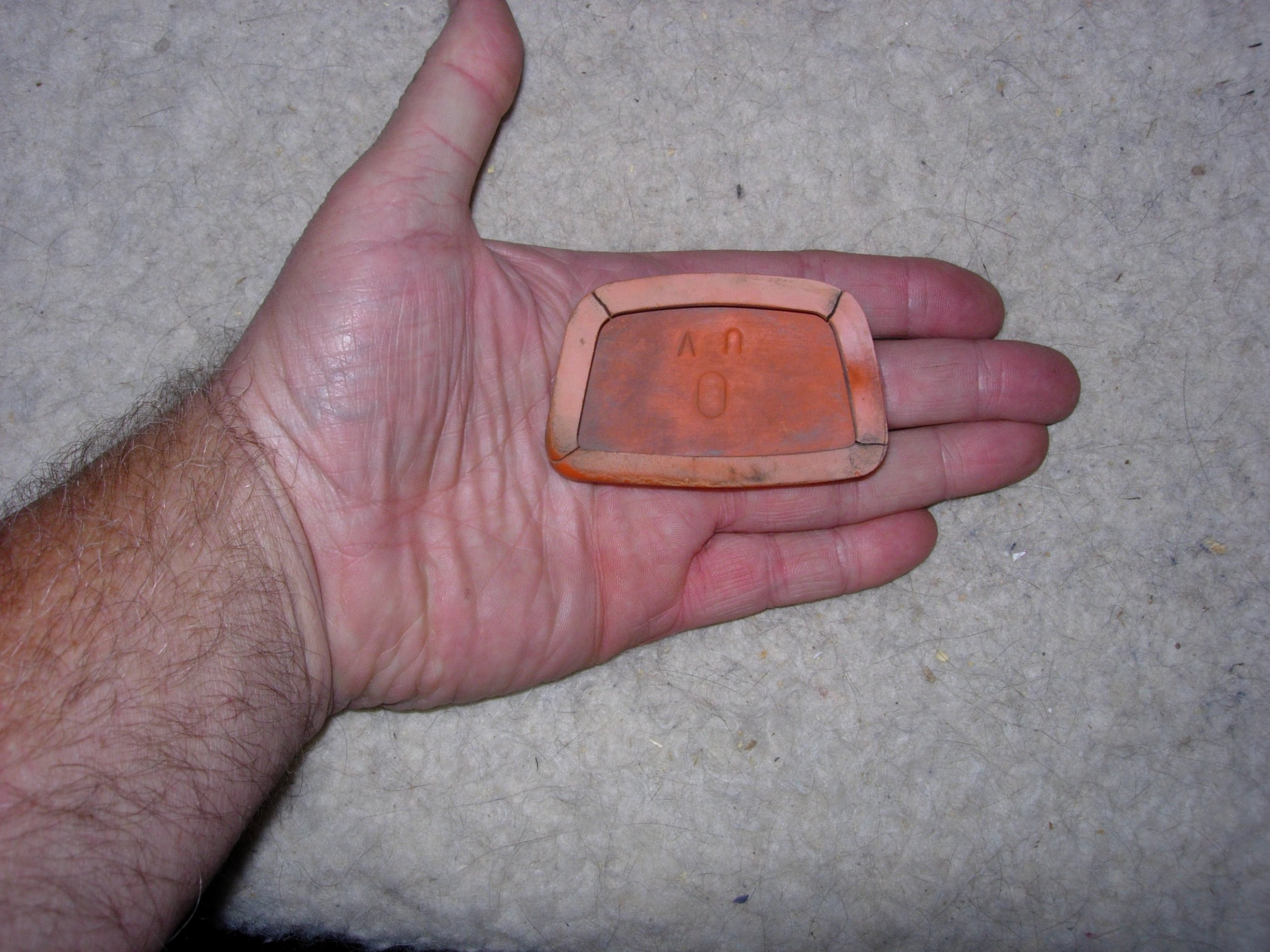

I am hoping against hope that the LS built machines might have less expensive repair parts. The treadle pedal pads on the TC26 DA lasted about three or four years, but cost me $52 the first tiime I replaced 'em and $60 for the pair the second time, a bit much, for one example.
I actually liked the treadle pedal, but in winter it was a nuisance to clear the ice that would get underneath the back and prevent reverse use. I thought it would be a little tricky getting used to the side by side pedals, particularly since I do a lot of dumping snow off of some pretty high banks, but so far I haven't done anything dangerous with them.
And no, I couldn't find any car type pads that fit the treadle or could easily be adapted to it.
Picture shows an old $30 pad. Second shows delivery/pickup day last spring.
