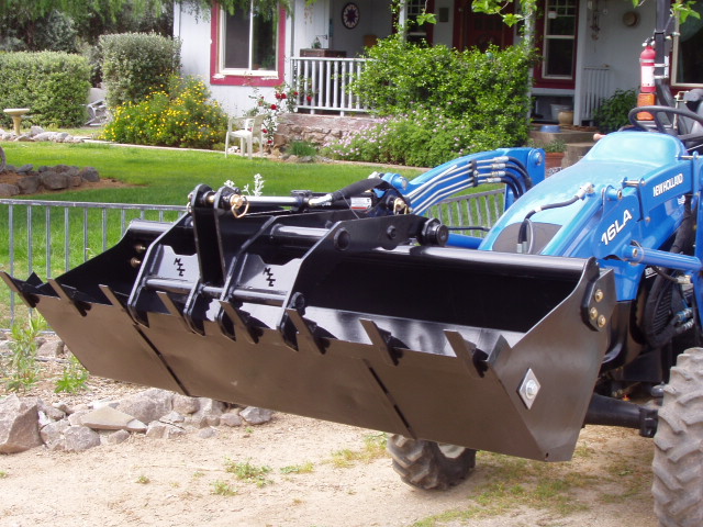

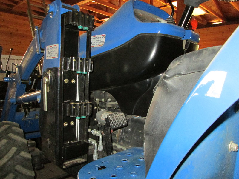

I guess I've got the baby in the family-a 2002 TC40S which just turned 600 hours.
I use it primarily to mow a few acres, haul tree/brush debris to the burn pile, split winter firewood and row crop a decent sized seasonal vegetable plot. It's probably the only TC in the entire country with a FEL dock mounted permanent shotgun scabbard.

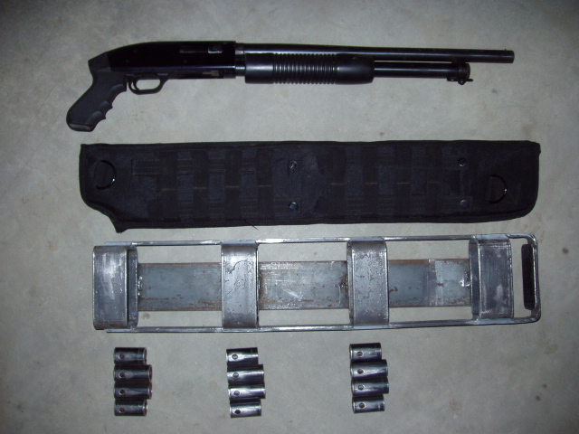

When I first started to work up this scabbard design I wanted to include some spare ammunition bandolier type storage (12 rounds, four wide three deep) searched the hardware store for twelve gauge rounds diameter compatible tube stock and found that natural gas pipe was the closest, very close-solvented off the asphaltic coating and to my surprise the pipe was blued!
Had the individual 1/4" birdcage loops bent in pairs at my local machine shop-instructed them to be bent perfect as to angle but wild as to short length-took them home and used my grinder to true them then welded the pairs into individual units.
Here are a couple more photos of the welded up steel birdcage/nylon scabbard/twelve gauge pistol grip shotty which is through bolted onto the port side FEL dock:
