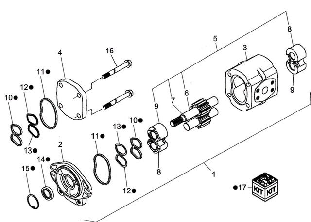

Bruce, on a tractor that you did not own new, you just never know how it has been operated. The problem could have started before you got the tractor. There has been at least one other person in the NH forum here that had a worn out pump. Certainly, fluid and filter changes are important, but I've let my fluid go out past 500 hours because it looked almost perfectly fresh. I think the 300 hour change cycle can be extended, but only if the fluid looks pristine as mine did. Mine was so clean I could hardly see it on the dipstick. You described your original failure as happening pretty rapidly and I don't see that as a failure from wear. That kind of failure seems to indicate something inside the pump failing.
You said you took the pump completely apart and put it back together. Did you replace any of the internal seals when you did that (items 10, 11, 12, 13)? The diagram below shows internal seals that are renewable. All the numbered components with a black dot beside the number are part of the $189 seal kit. Damage to one of those seals might not be seen by the unexperienced eye. I suspect it does not take much to cause enough vacuum loss to disable the pump, especially when the HST charge pump is competing for fluid from the same filter and piping. Having someone who has experience look at the seal conditions and bushings for wear could make this a whole lot easier on you.
When I got my pump seal kit installed, I just poured a a couple of tablespoonfuls of hydraulic fluid into the pump so I knew it was lubricated. I installed it back on the tractor and hooked up the piping. All this piping had loads of air in it and I didn't bleed it whatsoever. I started the tractor and let it idle for a few seconds and checked that the 3PH would raise. It worked perfectly. The system primed itself and the air slugs in the piping returned to and escaped from the reservoir. I didn't have to do any kind of fluid priming. I'm saying all of this to state that the system works fine when the pumps are in good shape. They will self-prime and clear the piping of air. The fact that your pump won't self-prime means that small amount of vacuum at the inlet is just not normal nor sufficient to get the system pumping. I think all your problems are going to be found inside your pump. It seems you've proven that over and over. I don't know what else to tell you.

I did get the tractor working. It was the hydraulic pump after all. We found out when we took off one of the outlet lines on the pump. It had a small screen in it and it was full of metal shavings. But we were about ready to put the new pump on when we discovered a leak in the suction line. There is 90˚ angle right above the pump, that is welded together and it had a crack in it. So we had that welded and now we are back up and running.

Glad to hear of your success, Bruce. I know it also must have been pretty expensive. I never thought about that 90 degree pipe weld being a problem, but if the big tube ever got a serious blow from something the tractor ran over, it would really stress that 'weakest link' at the 90 degree point. That little screen at the inlet to your diverter valve sure told a story with those metal particles. When I had mine off, it looked like a little organic goop around the edges, but the screen was very clean. It's amazing what you can learn from a little thimble sized screen.
