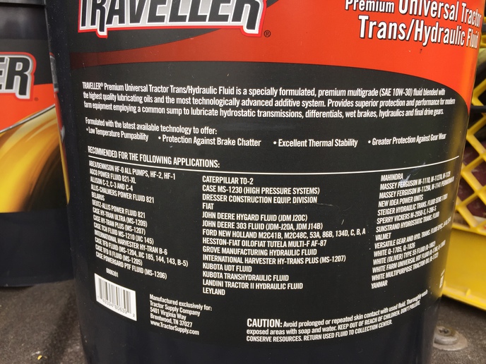

Hi I have a new holland tc 45 and the manual calls for Ambra Multi G 134 hydraulic /trans oil. Does anyone know the tractor supply oil that is equivalent. I have looked at all of the hydraulic oil they carry in stock and none have that mentioned in there specs. The manual also says to use that for the power steering. Thanks

Is your tractor a hydro or shuttle?. You should be okay with tsc premium hydraulic fluid. if you want to spend more money then look at the synthetics like chevron or kubota oils.
   / New Holland TC45 Trans/Hydraulic oil #3
I'm almost positive Tractor Supply's Traveller Premium Universal Tractor Trans/Hydraulic Fluid (SKU: 80639199) meets the 134D spec.
Traveller Premium Universal Tractor Trans/Hydraulic Fluid, 5 gal. at Tractor Supply Co.
I do Not use it in our TC40... so double check the label but again pretty sure you are cover spec wise...

It still needs TSC Premium (JD J20C spec is what I use for a gauge since if any spec is on a container and the product is rated for such, J20C will be the one listed) since you have hydrostatic steering and wet brakes to consider also. I run it in my Bransons and the Ford 3910 since it has wet brakes. The other two Fords don't need it so they get regular Trans-Hyd fluid, used to be listed as JD 303 on most containers. My 6530 is clutch assisted shuttle.
